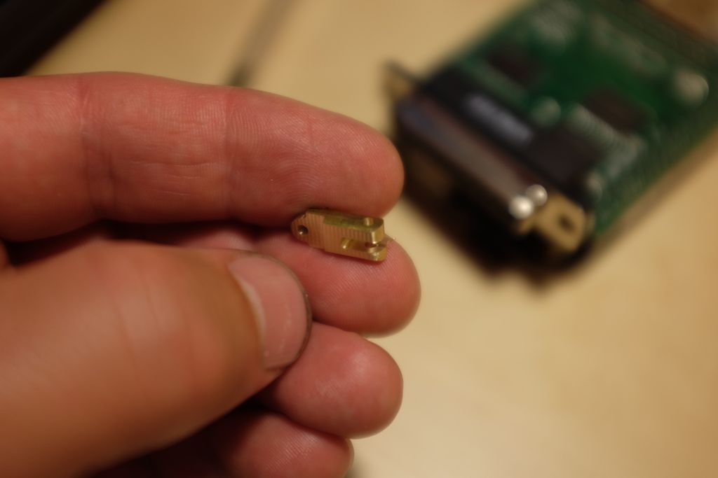

                                            Martin – If you were to ask me (and you'll not – read on) I'd stick them in my little CNC mill with the rotary axis, and just mill the little things.
                                            If I were to do more of the little links I just did, I'd reduce the overhang greatly, but for the three I wanted to do, it worked a treat. Here is a bit more about the technique and finished parts: **LINK**
                                            and a picture of them after a first (unsuccessful) run in brass:
