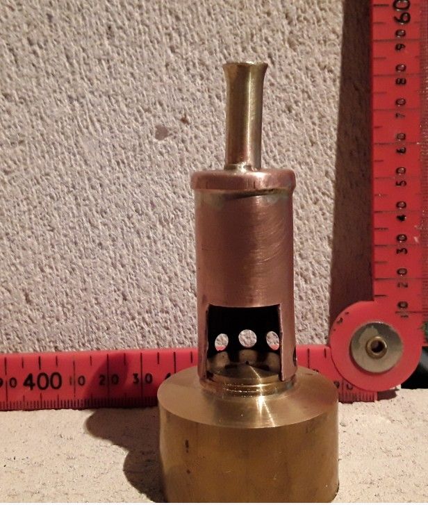

      I have made 3 tiny engines and working on the 4th.
      I've almost finished a tiny Jenny Wren boiler. Steam line out is only approx 2mm diameter.
      In Tubal Cain's plans (Building Simple Model Steam Engines Vol. 1) the boiler is committed to serving steam to the one engine.
      Could I make a little manifold to run 3 or 4 engines at once off the same tiny boiler or is this simply impossible and silly for reasons that a Newb like myself may not yet comprehend ?
      I wouldn't expect all 4 engines to run for very long at the same time, I'd be happy with 20 seconds, would be fun to see them all running at the same time.
      If a manifold is impractical how do people avoid committing one boiler to one engine I was thinking that the boiler line could terminate in a small brass block and I could somehow plug and unplug the engines one at a time into that block.
      My boilder below and some pictures of finished Jenny Wrens made by other people can be seen here
      The one in the palm of the hand gives a good idea of scale.

            Running more that 1 little engine could be possibe but would depend on how little they are and what volume of steam they require. It is only a little boiler and I would be surprised if it could run 4 engines. An option would be to make a manifold with an isolation valve on each port. Small valves are available from steam model suppliers if you do not want to make your own. You could then run each engine in turn or possibly more. Worth a try.

              One relatively small air compressor? If running all at the same time is your aim, it would be the simplest solution I would think.

                Thanks for all of the replies.
                Am keen to learn how to make my own little taps, safety valves, manifolds, knick knacks, wattchamacallits etc. Etc.
                Is there a book or a web site called "All the little fiddly fittings for newbie steam engineers" ?
                Bill
                #420137
                BW
                  @bw
                  …… and …… if the manifold block is too big and too cold can it instantly absorb all the heat from the steam, condense the steam and turn it back into water and then nothing will run at all just a big puddle forming in the manifold ?
                  Now that I think about it wouldn't that happen when the first steam hits a cold engine ? Do you get water inside the cylinder ?
                  Any suggestions for books websites I should be reading to better understand gratefully accepted
                  So first try with an air compressor then build a bigger boiler.
