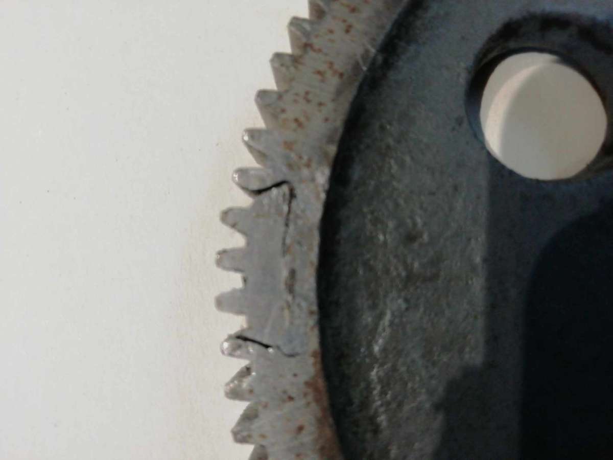

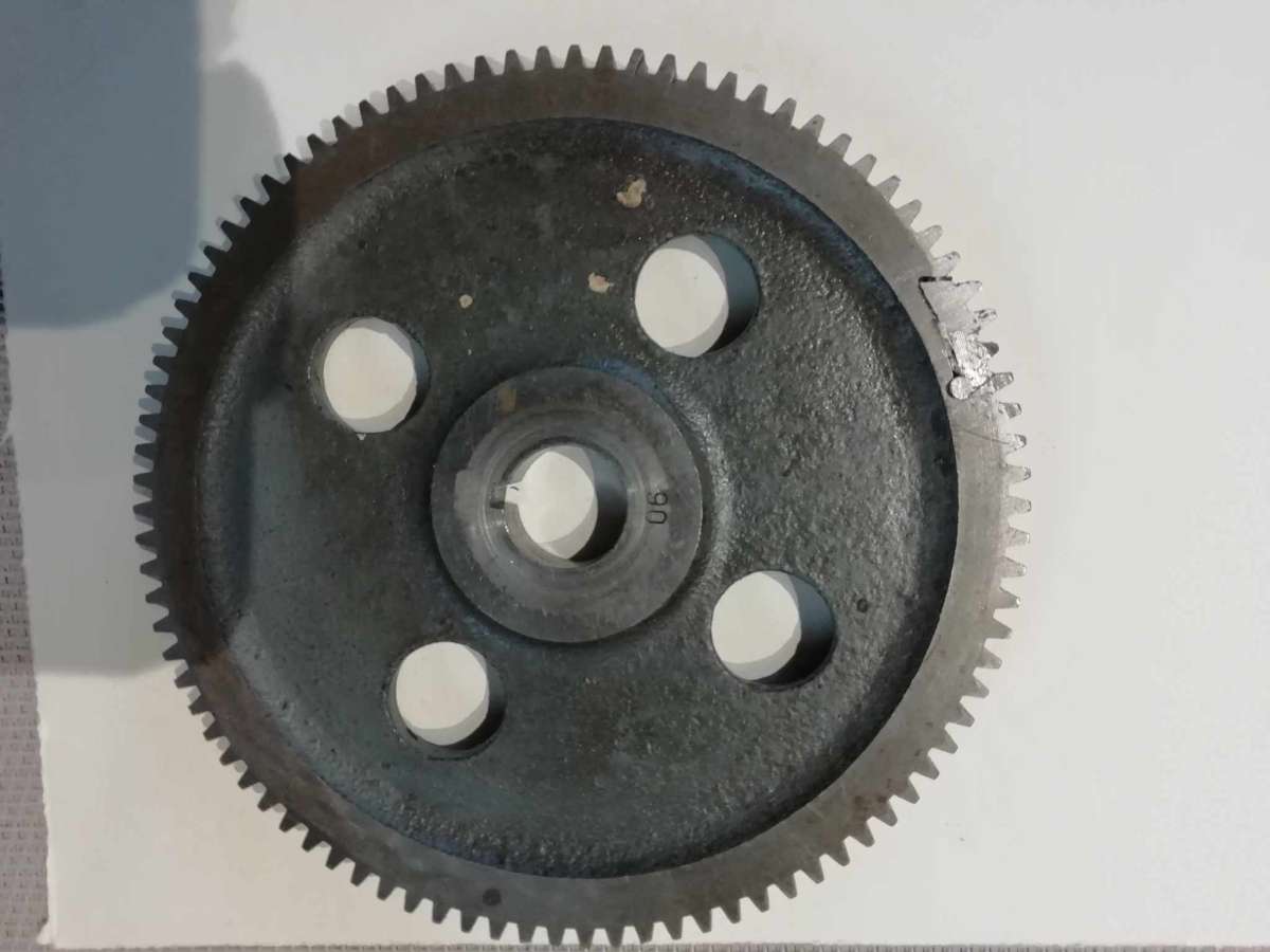

      Problem: I’ve a 90T wheel I obtained cheaply as it has 4 broken teeth that have been badly repaired. Can file it all out dovetail, and silver solder a piece of mehanite in to replace the teeth.
      Q: how accurate would it be to recut the teeth by copying the existing profile on the good teeth by filing a piece of gauge plate and using this to (effectively) progressively bludgeon the new teeth? Straight plunge or cobble up a flycutter. and either way use the slide and cross feed. (Have cut key ways like this but it’s a bit hairy plunge cutting)

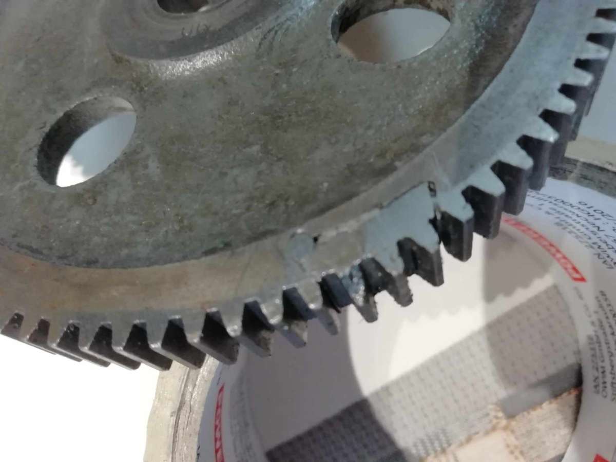

              #698749
              Mike Hobden
                @mikehobden70671
                received_1049293026497730received_2644371665721023received_308671625478776
                #698752
                Mike Hobden
                  @mikehobden70671
                  Above pics of existing cold repair and subsequent damage.

                    Mike, I suppose that is a 20DP gear like more modern myfords? 4.6″ diameter if so.
                    If you want to braze, solder or glue in a piece and post it to me I can cut new teeth into it for you. The tooth form will be perfect and I can even cut a few thou over-depth to clean up all of the existing teeth since it’s a change gear and not constrained to existing centres.
