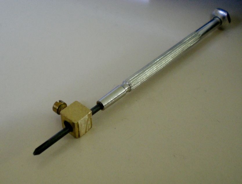

                                      Hi, don't know if this one counts, as it only uses the hole and screw bit of one, to make an instant depth gauge for small holes.
