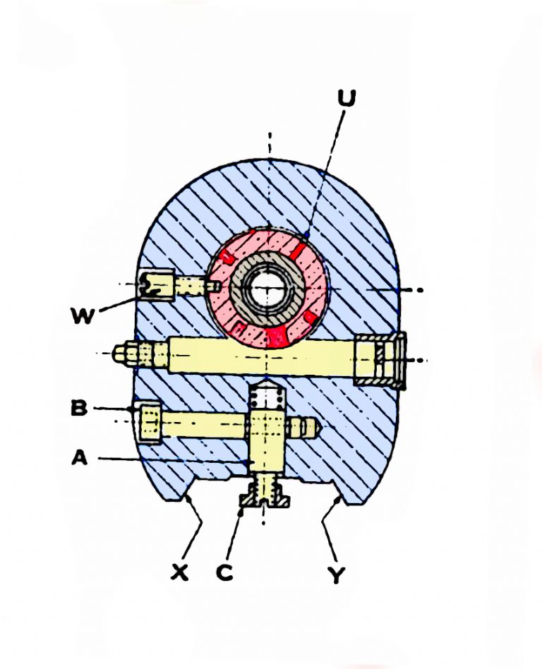

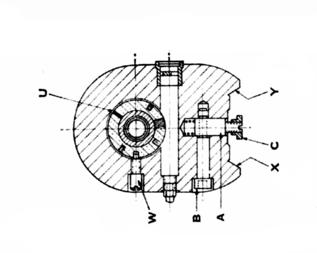

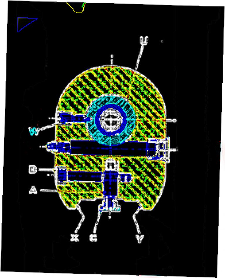

                    #619113
                      For those who admired the Muncaster watercolour recently posted by Jason
                      Here is a Pultra headstock, featuring the wick, for you to colour !

                            Posted by Michael Gilligan on 30/10/2022 11:21:41:
                            Is there a prize? I offer:
                            And:
                            And

                                With only one entrant for the unadvertised colouring competition
                                S.O.D. might have won … But unfortunately he failed to clearly identify the wick, so is disqualified.
                                Edited By Michael Gilligan on 30/10/2022 16:10:06

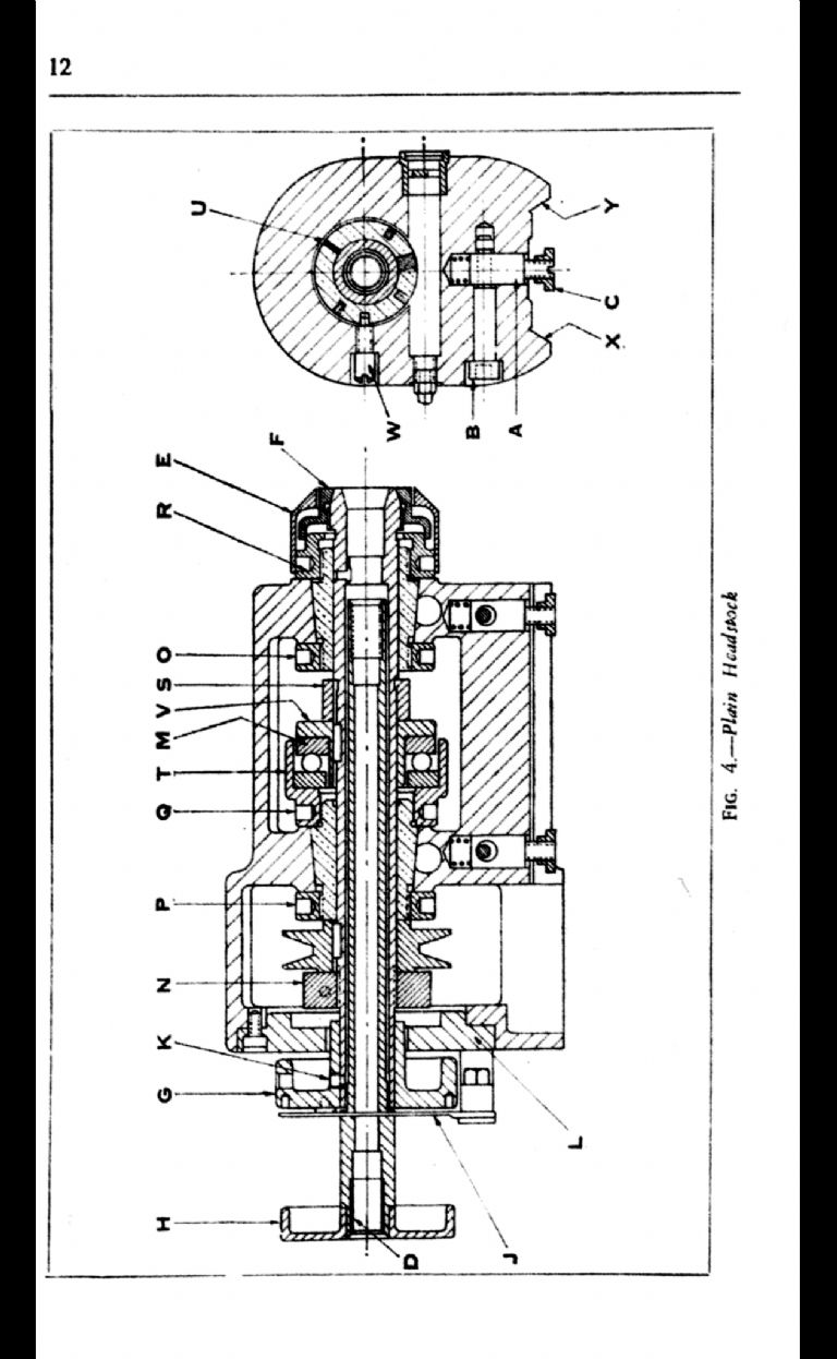

                                        Text from the relevant section … Translation by Google
                                        The lathe being reassembled: we can see the belt on the right, and in the middle the oil reserve of the spindle bearings:
                                        Detail of the two braided cotton strands that raise the oil to the bearings:
                                        Small glass lens that allows you to monitor the oil level in the crankcase:
                                        Replacement of cotton braids with felt strands, more suitable for the rise of oil in the bearings:

                                          Take off the inspection plates on the headstock. That should show you the oil reservoir. You should see the wicks leading up to the bearings.
