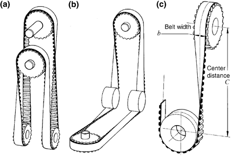

            rjenkinsgb
              @rjenkinsgb
              You can use timing pulleys with a long belt running over a couple of idlers to move from a vertical belt off the chuck to a larger horizontal one, rather than bevel gears.
              All the parts are quite cheap on ebay, amazon, aliexpress etc.
              Example images here:
              https://media.springernature.com/lw685/springer-static/image/chp%3A10.1007%2F978-3-642-17755-2_3/MediaObjects/193019_1_En_3_Fig18_HTML.gif
                            Maybe the bevel gets out of an angle grinder would have suitable ratio. Quite inexpensive new in FE import form or even cheaper from a dead angle grinder intercepted on its way to the bin! (I kept a dead one lying around for over 12 years in case I had use for the gears before finally weakening on Wednesdays tip run.)
