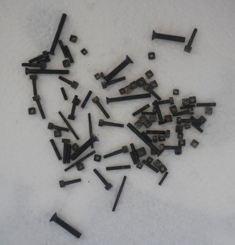

        JA
          @ja
          Going to red heat produces the black iron oxide layer and quenching in oil fills this porous layer with carbon. Like blueing you should keep the finished surface oiled. I think it is called blacksmithing blacking. Many will go on about the oil having to be old whale oil etc.
          I have used this method to get a good hard black finish on small steel parts down to 12 BA nuts and screws. The heat source was a domestic gas hob and the oil clean ISO32 from the lathe. The performance of the nuts and screws was not compromised.
          Blacked small steel fixings
          Stopping at the temper colours have always given me the nice deep blue finish loved by clockmakers.

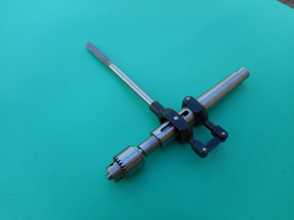

                                  Hopper
                                    @hopper
                                    Re the oil blacking in my lever tailstock thread, I did a few trials on the bits for the lever tailstock and before that on some other projects I made. I found that heating the bits up to lower temps, blue or even up to grey etc work ok-ish but the layer of black was a bit thin, inconsistent and tended to rub off with use.
                                    On the lever tailstock bits, I heated them until they just started to go a slight dull red, then held them there for a bit to let the heat soak right through the job, then plunged them into the clean motor oil, jiggling them up and down as I moved them around in a circle so that pockets of oil vapour did not form and surround the job. I reckon that by the time I moved the job from the bench with the torch and hearth on it to the next bench with the oil on it, the job had pretty much lost its red colour so it does not seem critical. I did leave the job lying in the oil until it had completely cooled off. Then wiped them off and sprayed down with WD40 and let it soak in. This last seemed to help generate a nice shiny black finish.
                                    The result of this was that seven months later the lever tailstock black bits still look great and have proven quite durable in finish.
                                    I have also done the small sensitive drilling attachment this way and it looks very good too.
                                    Obviously, if the job were made from silver steel or other higher carbon steel where red heat would affect temper etc I would use lower temps for blacking. But for mild steel this works well for me.
