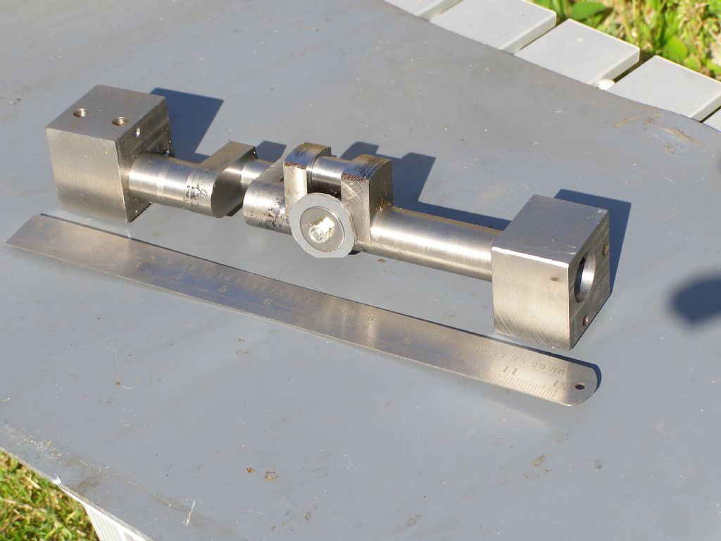

                I turned my steam-wagon's one-piece, twin, one-inch throw (two-inch stroke) crankshaft by holding it between centres drilled on the milling-machine, in square steel blocks.
                These were gripped to the shaft ends by several grub-screws each (on diameters still oversize so not damaging finished surfaces.). This lot was assembled on the milling-machine table as surface-plate, taking care to match the blocks' datum-surfaces.
                I'd considered drilling the centres on large diameters left on the shaft ends but could not see how to match them angularly, end-for-end. I now realise I could have used the web surfaces themselves, but anyway the shaft's length was against doing that, by exceeding the milling-machine's headroom
                (Photo below, temporarily re-assembled loosely for the picture without spotting I put the right-hand block back on, 90º  out of kilter!)
                The "drive dogs" were pins or blocks screwed to the faceplate surrounding the live centre itself.
                The bits between the webs are to prevent closing by tailstock pressure.
                Edited By Nigel Graham 2 on 27/12/2022 13:22:18

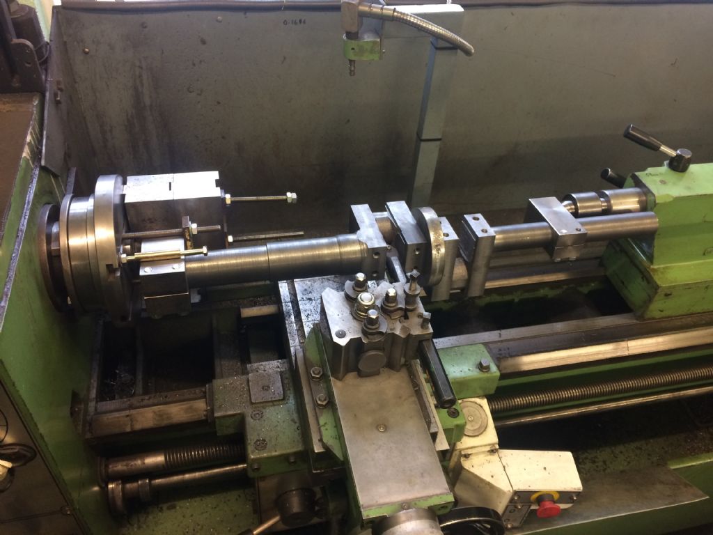

                  Both my traction engine cranks have been done similar to Nigel's above. My blocks were clamped differently but same result.
                  Note also the balance weights to smooth out the offset motion.
