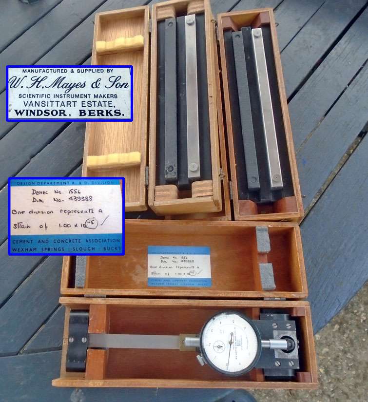

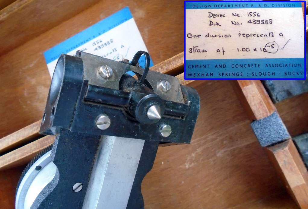

Hi All,
Again this came in an auction lot, some sort of strain gauge instrument for concrete.

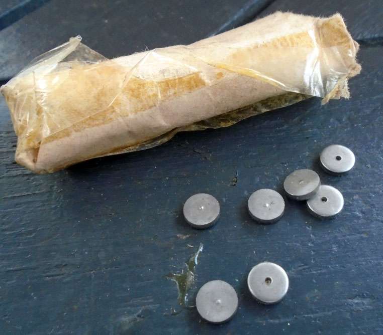

Came with lots of small buttons and 2 boxes containing what look like reference bars.
How would one use this please?
Cheers, Martin
I have seen buttons similar to those placed each side of a crack in a concrete building. I guess they are used to monitor whether the crack is slowly widening.
You can look up ‘demec studs’ in a nearby search engine. That will tell you as much as you care to know.
Start here:
How To Monitor A Crack
I think one of the reference bars is made from Invar
Thanks very much guys, help is much appreciated. Martin
I believe Mayes are still active and in the same place.
