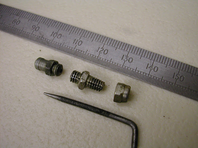

      Hi everyone,
      Further to a comment on nickel plating on another thread I felt this might be better served by having ‘it’s own’
      I would like to nickel plate some very small parts on a virtual one off basis. Consequently I don’t particularly wish to make a big outlay to do so. That’s not a case of being ‘frugal’ just that the outlay for a plating kit is rather excessive for the job in hand and the likelyhood of having very little further use for it.
      The intended parts will be similar to these, just slightly larger and three off of each – not a great amount as you can see so what I was hoping to do was a sort of ‘jam jar’ set up, just sufficient to achieve the finish.
      These parts are from the original engine that I am copying – the dull finished inlet on the left is not the norm, another engine has this as bright as the needle side (and somewhat brighter than the image appears to infer) The needle itself is not plated.
      I have found on Ebay some ‘Nickel Plating Salts’ just a 100ml for £6 which would be sufficient. I know I will need a nickel anode as well but apart from this would I need anything else (I have a 0-30v power supply unit) to carry this out in a very small fashion? Is the set up similar to anodising using the salts as the electrolyte?
      Also, as the parts will be made of brass – what will be the best form of degreaser for this material for this application.
      As usual any help or light that anyone can shed on this will be appreciated but please bear in mind I really do wish to keep this on the ‘small scale’ .
      Regards – Ramon

          #67041
          Clive Hartland
            @clivehartland94829
            Ramon, Nickel plating requires a base metal to plate onto so you will need to copper plate first.
            I spent six months as part of my army tech. training in a plating shop at Donnington workshops and learnt a lot of basic skills there. Cleanliness both physical and chemical is paramount.
            Another item is that the base layer , copper is polished to give a polished nickel layer.
            Straight nickel will give a slightly rough surface.
            Perhaps you should consider using stainless steel for the components or another alternative is Zinc plated and passivated.
            All the processes involve an acid dip which will etch the surfaces.
            Stainless steel is the way to go I think.
            I sem to remember that most of the spraybars were made of brass in my engines of yesteryear, in fact I had to make a couple of them as some of my crashes were a bit spectacular and bits got broken.
            I have also carried out black chrome work which still requires copper plating before being done, the copper is brushed off leaving a beautiful shining black finish which is all but impenetratable. This method was used on the components of the big guns recuperators to stop corrosion.
            Clive

              #67057
              chris stephens
                @chrisstephens63393
                Hi Ramon,
                I think that there is some slight mis-information about plating by one of your earlier answerers.
                If you are plating Brass, the Copper plate should not be necessary.
                In quality work on Steel you should first plate with Copper and then Nickel and then Chrome, if you are Chroming.
                I admit that things might have changed in recent times, it is many years since I took the weekly run to the platers.
                chriStephens

                  #67073
                  Ramon Wilson
                    @ramonwilson3
                    Hi Chris,
                    Thanks for that as that’s just the sort of input needed at this stage. I have been sneaking in from the garden (when someones not looking) at any opportunity to find out a bit more. I have found some excellent info on You Tube which is just the kind of thing I mean – done in a jar that is – literally. Because of the domestic interference I haven’t had time as yet to study it though.
                    As with the anodising done on the previous engines I will now look into this as it does appear to be able to be done without too great an outlay. I would much prefer to go this route than use stainless though that is still an option if all else fails..
                    Yes we have Caswellls over here too John though they tend to appeal to the ‘larger’ user or did when I looked last. I don’t intend to get into chroming at this stage but who knows what may happen in future.
                    Thanks agin for the input – it’s all appreciated
                    Regards – Ramon

                        #67101
                        Clive Hartland
                          @clivehartland94829
                          Whatever method of plating Ramon tries he may have trouble obtaining the chemicals in small quantities.
                          As I think you are after a cosmetic effect then the simplest method will be best.
                          As an aside, electro plating of copper and nickel including Chrome is porous.
                          The nice shiny effect of chrome is obtained by polishing the Nickel base and plating onto it with the chrome. This is also polished but sometimes it fails as most of us have seen the chrome peeling off our shiny bumpers.
                          The plating foreman would soon reject anything not up to his standard and was a patient man and would show how it was done , once!
                          I did in fact cadmium plate all the bolts and nuts on my m/cycle, passivated, they were not dangereous. The lustre of cadmium is sadly missed and only aircraft components are now cadmium plated.
                          We also had plating stripping baths and I occasionally ‘Lost’ a job by forgetting it was in there and it was dissolved to a wafer!
                          One of the main jobs was cleaning and replating the hammer and letter bars off Creed Teleprinters and they all had to be kept in sets.
                          There was also a degreaser/ paint killer bath called Magnus 755 which would take all the carbon off a cylinder head and return it like new metal. Better to see all the cracks and faults. Gunged up Diesel pistons came out like new as well.
                          My six months in the plating shop gave me a great insight into preserving of metal and the cosmetic finishes that could be done.
                          Now of course H & S have all but killled the job.
                          Later in my Leica service I became involved in Anodizing, and luckily made good friends with the shop operator and learnt all there was to learn of tolerances allowed for the thickness of anodizing. All my maching was in HE30 and was anodized. AA15 or AA25 depending on the location it would be used in.
                          Clive
                          #67107
                          Ramon Wilson
                            @ramonwilson3
                            Hi again,
                            Thanks for the continuing interest.
                            When I set out to anodize the cylinders on my last engine project it was a very quick and steep learning process but the end results made the effort and expenditure well worth the effort. It was also something that would be repeated again in the future so it was felt the outlay was justified.
                            This requirement for plating on the other hand is not seen in quite the same light so I don’t have the same justification. That said I would like to replicate the original as closely as possible within limits so will continue to look into it in the short term at least before I try the other, probably more sensible?, approach of machining the parts from a similar ‘coloured’ metal.
                            I have tried without success to source some Monel metal Hansrudolph but thank you for that suggestion. In all my modelling days however I have only ever seen it once before, in welding rod form many years ago and indeed used it to form the pulpit on a model of the Fairey Swordsman.
                            German Silver – is this another name for Nickel Silver as we know it or a different material? ‘Nickel’ Silver is readily available – certainly from this source here which I found this evening (If you aren’t aware of this supplier it’s well worth a look) – however I think stainless would be the better alternative.
                            I have heard from Gateros and apparently their ‘Brush Nickel Plating’ is ‘brushed’ on using a ‘wand’ connected to a power source. It is not carried out in a solution in a tank set up. Though they say this would be suitable I feel a small tank set up would be the better way to go.
                            I will continue then with the plating approach and, like the anodising, report back here with any results – good or bad – in due course.
                            As always my thanks to everyone for their input.
                            Regards – Ramon
                                                    Clive
                                                    no it doesn't . i have plated all the corroded chrome parts on my motorbike ,and none of them had copper on them , complete BS , as long as whatever you want to plate is spotlessely clean you plate plate it with nickel ,
                                                    #352101
                                                    Clive Hartland
                                                      @clivehartland94829
                                                      I disagree, the basis of longevity for Chrome is a base of Copper and then Nickel and then a 10 Micron Chrome plate.
                                                      Perhaps a quick look at Wicky will help, if I had NOT applied copper and nickel the Foreman would have jumped all over me. I never saw anything chromed that was not copper and nickel first. Even brass number and name plates were done this way.
                                                      Clive
