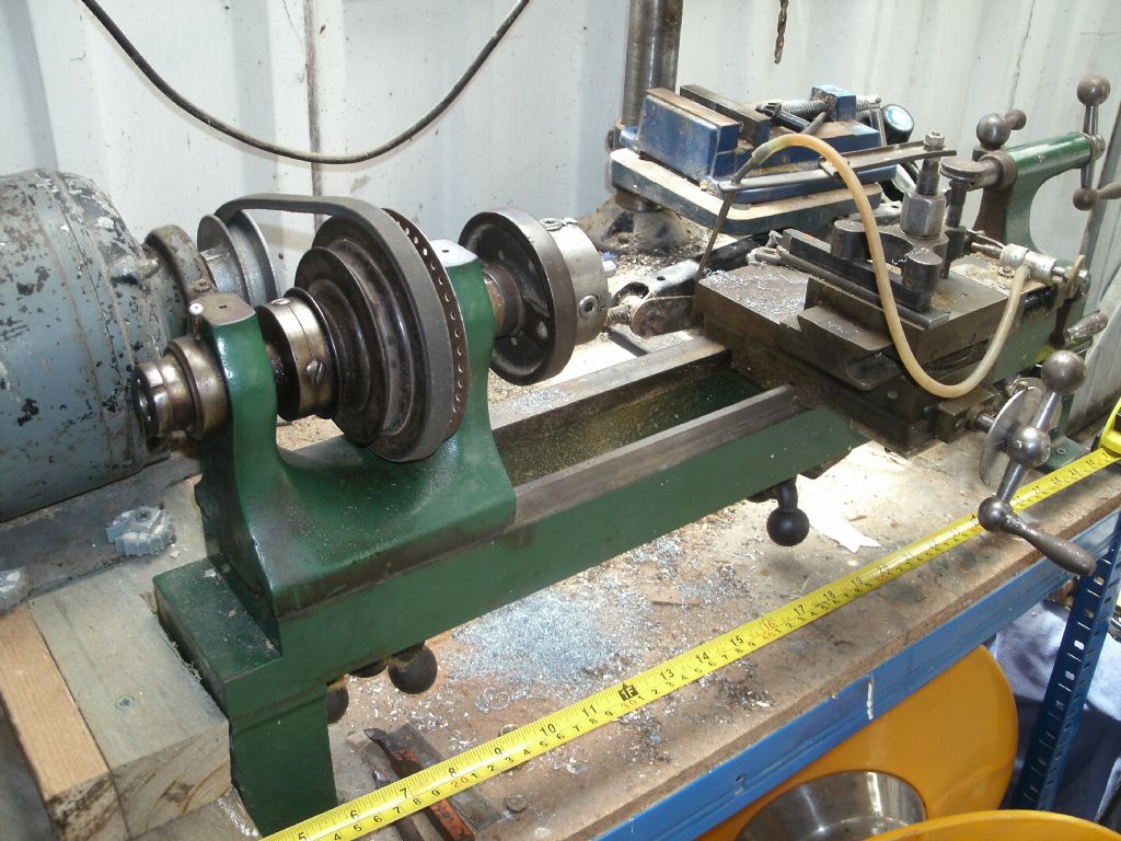

      hi, new to lathes,i have just purchased a small lathe,was told a drummond,if i post up a photo,could any one tell me which it is,?? i need a larger chuck,but they all seem to vary,;; thanks.

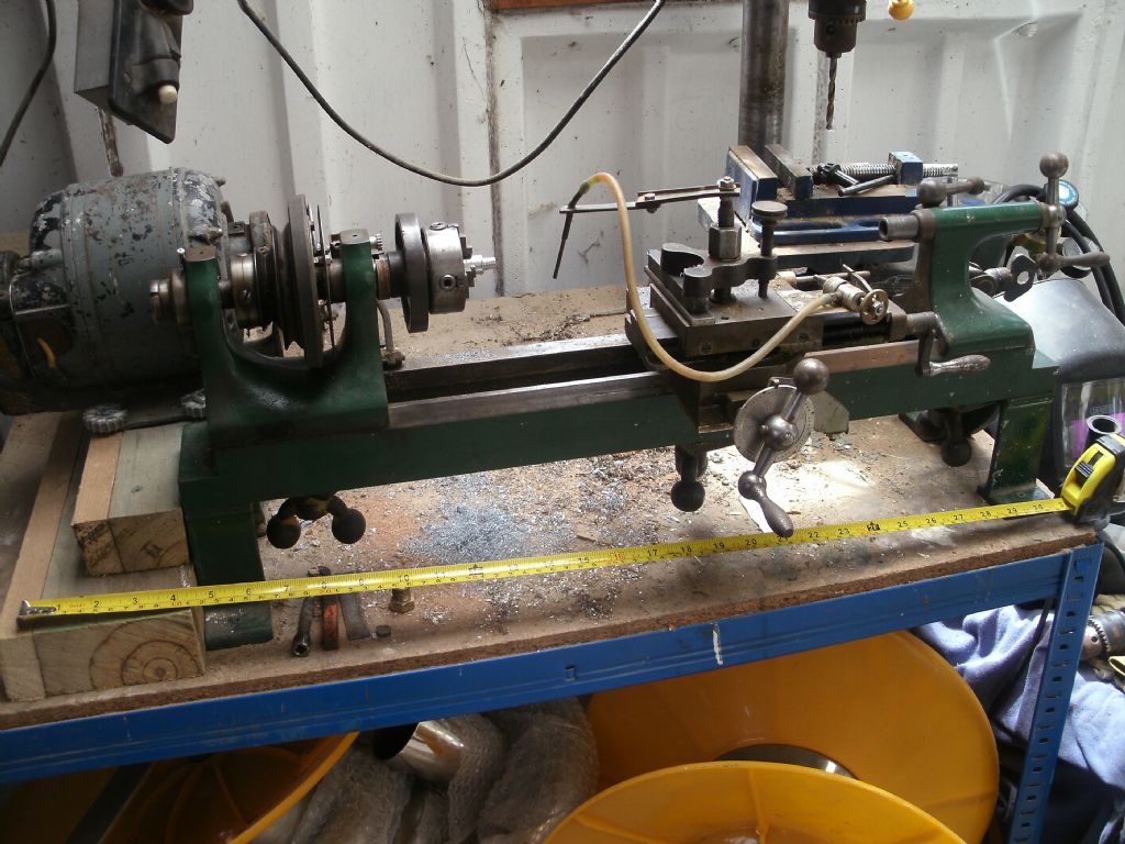

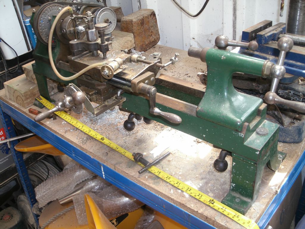

                    Thanks for the swift replies. Have added some photos now. If anyone recognises the make and model would be really helpful,

                      Nice lathe, looks very much like a Lorch model A **LINK**
                      I think your set up would benefit from a countershaft in between the motor and the lathe spindle. The current direct drive probably gives a top speed that is rather fast for the lathe bearings.

                        Agreed, it's a Lorch, appears to be in very good condition too.

                            hi,thanks for the above replys,yes in very good condition,original paintwork,all slides nicely,must have been well looked after,im now trying to find out the model and age, lookind now for a bit larger 3 jaw chuck that will fit the 20mm spindle end, the chap who sold it to me also gave me a made up pulley block with 4 different size pulleys, thanks again, terry

                              I doubt you will easily find a chuck that screws straight on to the spindle. Usual procedure is to buy a standard chuck and bolt it to that flanged backing plate that is screwed onto your spindle with the existing chuck. The backing plate will most likely need a spigot machining on it to fit the new chuck. I would focus my attention on getting the countershaft in place and get the lathe up and running and get some practice on it first. It looks like a lovely little machine. Good score!

                                It's a Lorch plain turning lathe. I have the same one, I use mine for clock repair amongst other things. As well as a countershaft please dont start it up without adding any oil into the holes on the top of the two towers on the headstock. I have a couple of cups on the top of mine where I pour in oil to lubricate it. It looks like you dont have a backgear system on yours (I dont have one either).

                                  Your lathe is about a hundred years or more old.
                                  You can find out a little (not much I'm afraid) more about it here:
                                  http://www.lathes.co.uk/lorch-model-a/
