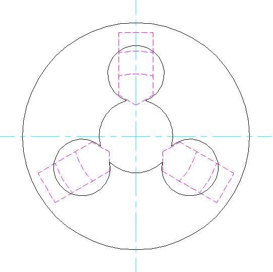

        I am looking at replacing my Pratt Burnerd 160mm D 1 4 mount chuck.
        The jaws are bell mouthed and it does not run true without a lot of fiddling and tapping things true. Rotagrip quoted around £170 for new jaws, they would cure the bell mouth problem but may still not run true.
        Looking at new integral camlock mount chucks they range from £140 at Warco to around £200 for a TOS chuck. Any recommendations ?

          Paul Lousick
            @paullousick59116
            Chuck jaws should be clamped as they would be when holding a part when they are being ground to correct centering errors. Therefore if you are grinding the inner faces of the jaws they should be pressed against the same side of the chuck spiral as they would be when holding a piece of round bar otherwise they may not centered correctly.
            A special plate as shown below is used to hold the jaws in their correct working position for grinding.
            Paul.

            Bob Brown 1
              @bobbrown1
              expander shim.jpgOr you could use something like this and use a grinder to true the jaws chuck1.jpg

                      Bernard Wright
                        @bernardwright25932
                        Folks may disagree with my method but, I've always ground the jaws off lathe, vertically on the flank of my 8" white wheel grinder, I also adjust the rest to give a slight backward angle, to grind more off the heel than the tip of the jaw, to reduce bell mouthing.
                        I grip a ground bar in the suspect jaws and take readings and mark the jaws, doing this several times does get tedious but the results are excellent.
                        The reason being, on lathe grinding/lapping leaves a curved surface on the gripping part of the jaw, which will only corresponds to one diameter, leaving horrible grip lines on others.
                        In the end I converted my stock Burnerd 3 jaw to a Griptru one, takes but a few minutes to get less than 1/2 thou tir.
