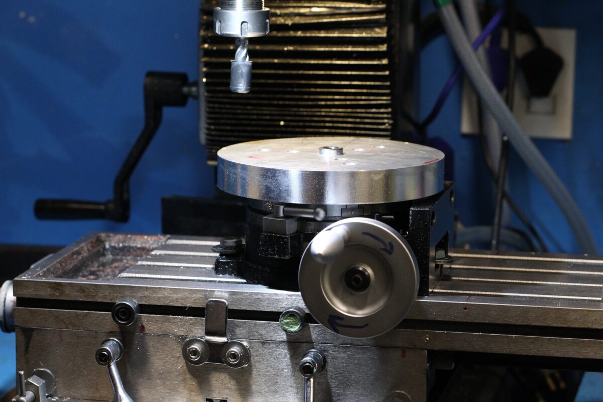

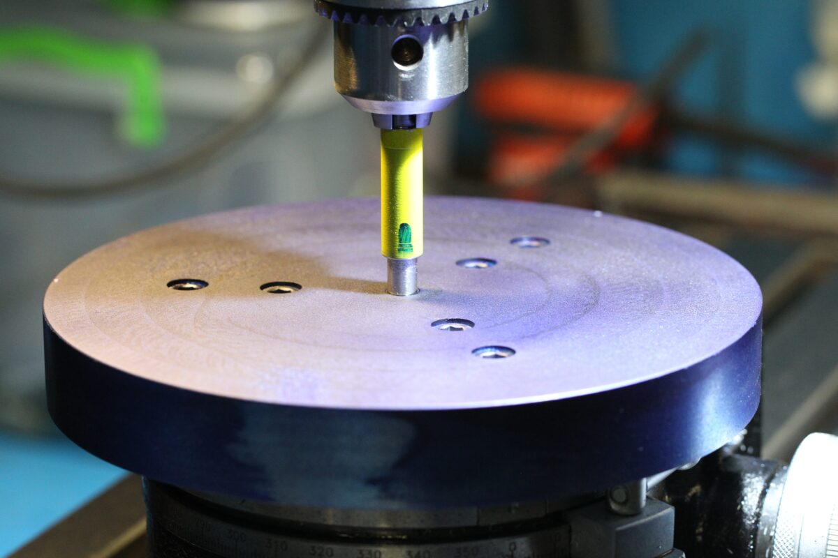

      Ok, I facemilled the underside, find the centre, dril a gole to slipfit the MT-2 shank, and bored a pocket to slipfit the top 3mm protroding of the MT2 above table.
      Now I have to decide what to do with the MT2 shank sticking out on top, maybe tread it with nut + a very short drawbar make to screw into the MT2 from the bottom.
      Plus using the 3-T-Slots on top to clamp the Disc to the table, and then facemill the top flat on the table+ round circumference of disc, then decide to drill holes for clamps.
      So the disc locate to MT-2 top as well as shank, and shank can be used to locate the whole setup to mill spindle.
      See photos:

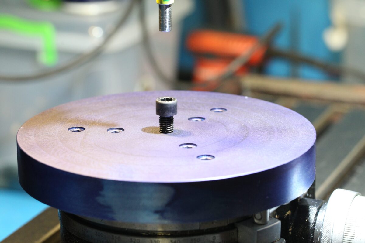

        It can be quite useful to have a spigot sticking up out the middle to locate work on but not when you want to mount something flat. If it were me I would face or mill the end of the spigot so it sits just below your aluminium table.
        Then drill and ream 6mm or 1/4″ if you are that way inclined and carry the hole down and tap M4. That gives you the option of making up some stepped spigots to locate holes as well as being able to bolt parts down using the same central hole. Upto you if you want a single long 6mm spigot and rings to fit it or make a series of stepped ones that are 6mm one end and say 8, 10, 12 etc the other.
        The thread can also be used to pull  the MT from the table if needed.

                                            #724960
                                            Chris Mate
                                              @chrismate31303
                                              Ok, I received MT2 shank (for Facemill) to use and fit Disc:
                                              Step 1:Drill hole
                                              Step 2: Bore small hole for MT2 tip.
                                              Step 3:Fit MT2 to Disc
                                              Step 4: Bore large hole for MT2 base and fit.
                                              Step 5: Fit & bolt MT2 to Rotary Table, then fit Disc over MT2 on Rotary Table.
                                              This is where I am now with the 3x T-Nuts to pull the DISC down on Rotary Table.
                                              End of this part.

                                                    Ok, I finished drilling holes 8mm, sink bolt head down in Disc with 12mm end mill.
                                                    1-Set up RT on mill table centre X/Y axis. Lock Y-Axis down,
                                                    2-Rotate table with NR1 slot in line with X-axis.
                                                    3-Use wiggler and rotate RT to centre of slot using wiggler, a centerline was scraped on T-Nut snug fitting to indicate centre of t-Slot(Good enough for this).
                                                    4-Lock RT down with its own clamps.
                                                    5-Make use of Mill table X-Axis locknuts(Set limits) to only move X-Axis between points NR1 (A) & NR1 (B) using wiggler.
                                                    6-Now I can go backwards and forward and step up drilling holes till 8mm.
                                                    7-Determine lenght of 8mm Allen Key bolts through T-Nut(Clearance at bottom)
                                                    8-Turn Allen key bolt heads down on lathe to 11.85mm to fit 12mm hole.
                                                    9-Bolt Disc down to RT…..Finished with Nr 1 A & B.
                                                    10-To be repeated for other two T-Slots.
                                                    See photos:
                                                    NR1 A
                                                    NR1 B
                                                    NR1 A & B Finished
                                                    #726446
                                                    Chris Mate
                                                      @chrismate31303
                                                      Finished the T-Slots to Disc with 8mm bolts.
                                                      1-Milled circumference of disc round from centre with RT.
                                                      2-Milled top of disc with shoulder mill flat and revoded protruding MT2 part, all flat now. Make quick centering tool. If I fit the table to the mill table I will centre it without the disc fitted, using the then protruding MT2 part with coaxial indicator.
                                                      3-I am now ready to mark out the holes(8mm) for clamping I deed to mark out, drill and tap.
                                                      -I thinking of providing extra holes for a sine-vice strong enough(Modded) to clamp parts to fit on top of disc, it may work out.
                                                      See photos:
