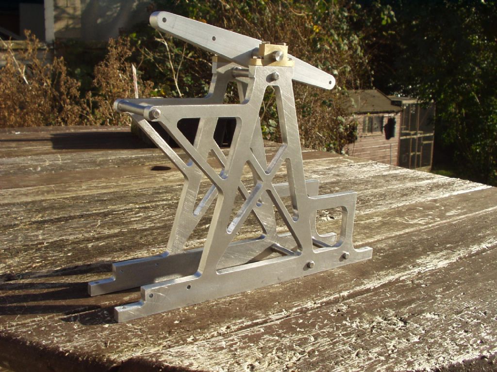

      Hi all

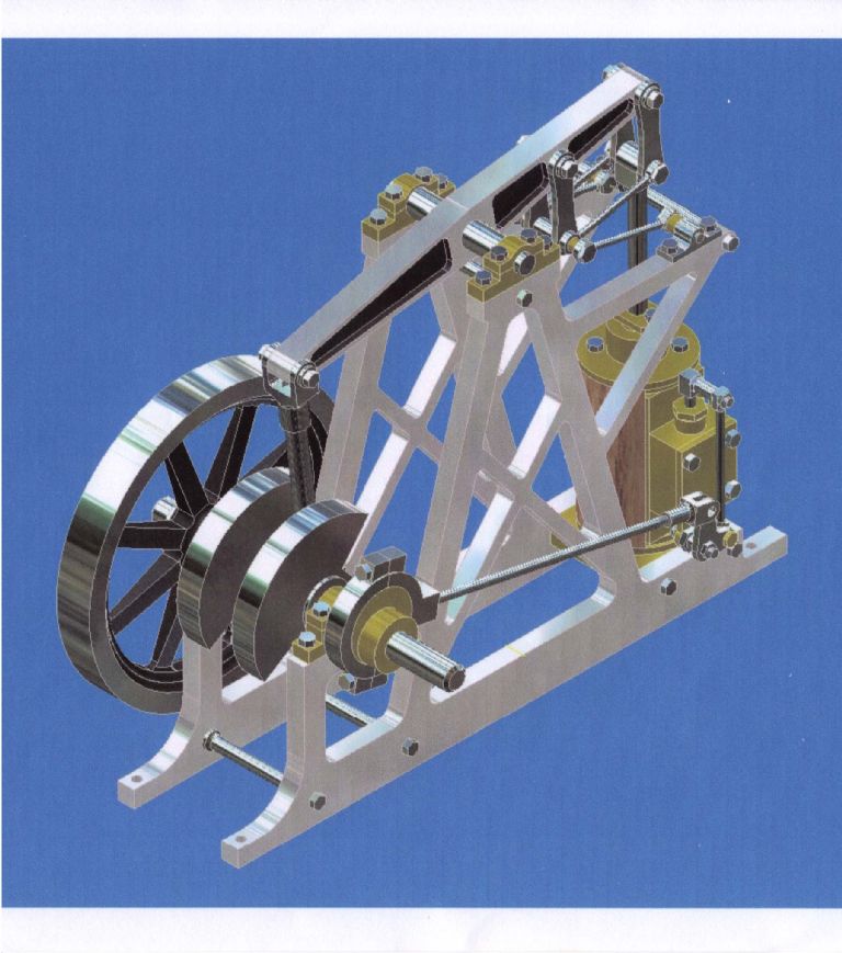

      here’s a pic of my new project, I found the plans on the internet and thought it looked different .
      the first pic is progress so far
      and this is what it should turn out like
      the frame is 6mm aluminium, I scaled it up 50% because it looked too much like watchmaking so the flywheel is 4.5 ins , length is 9 ins and height is 7 ins.

          Hi,
          Which method do you use to cut the frame?
          Could you give me the link to his plan, it looks an interesting project?
          Have a good day, Patrick

            #45094
            wheeltapper
              @wheeltapper
              Hi
              Patrick, I printed the frame plan full size, bolted the two frames together through two of the waste parts, stuck the plan on with double sided tape then drilled, sawed and filed to the lines.
              apart from the base, which was milled square, and the bearing surfaces , which were also milled square to the base.
              just the job to keep you warm in an unheated garage/workshop
              Circlip, thanks for putting up the link, I assume you’ve seen this before?
              just a warning, the plans have a page missing, it appears to have the bearings for the beam, crankshaft and the conrod big end.
              however, these are easily gauged from the rest of the plans if they are blown up full size.
              cheers
              Roy

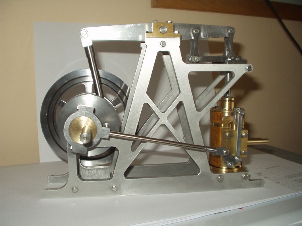

                    #51509
                    wheeltapper
                      @wheeltapper
                      hello
                      It’s finally finished
                      it runs lovely on about 20 psi.
                      I’ll try to get a video of it working if I can put video links on here.
                      cheers
                      Roy

                            #62236
                            Doddy
                              @doddy
                              You’ve inspired me to make this beam engine too, I’ve got the plans, including the missing pages ~ did you have any problems? I’m hoping to make the side frames from 6mm brass sheet/plate, unless i can pick some up from the local scrappy
                              #62242
                              wheeltapper
                                @wheeltapper
                                Hi
                                No real problems except that, being a newcomer to this hobby I didn’t know what I was doing half the time.
                                I had to evolve a way of making the flywheel without a rotary table (too expensive).
                                I must have machined it in my head a hundred times, looking for problems and when I finally made it everything went like clockwork.
                                don’t forget, we want loads of pics.
                                cheers
                                Roy
