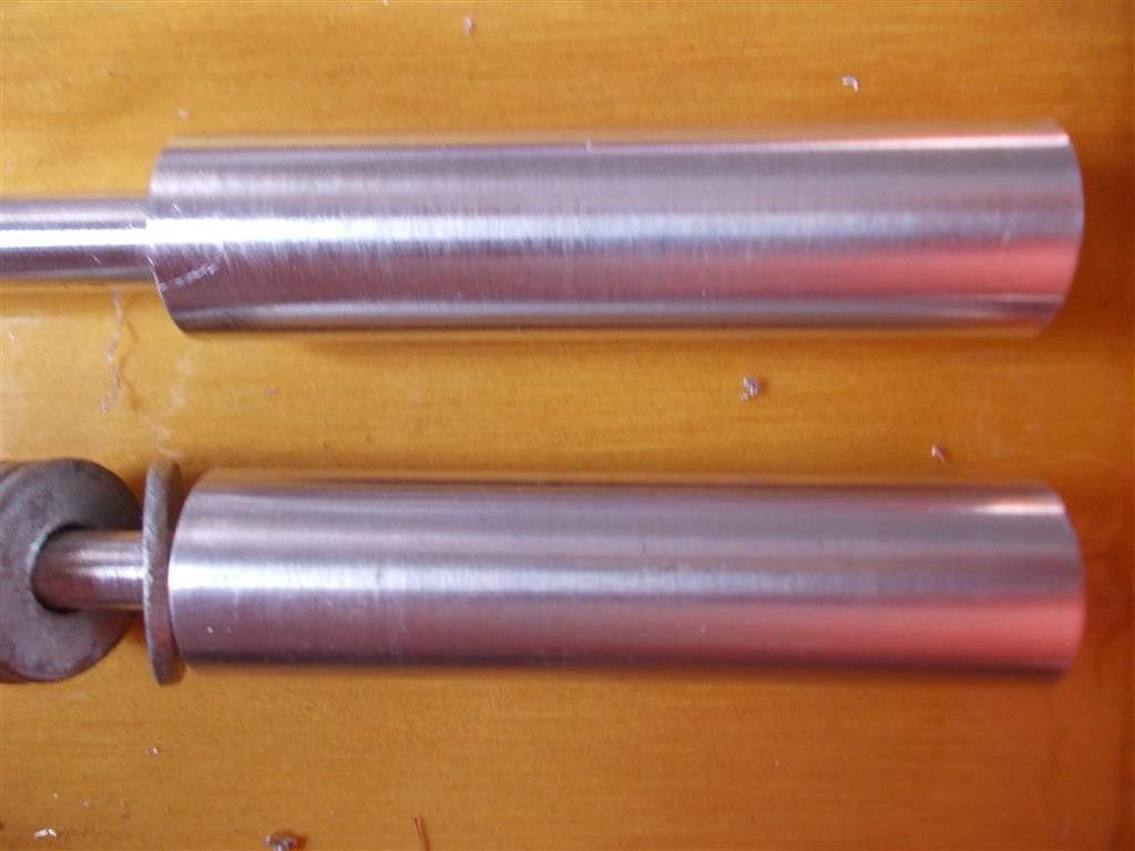

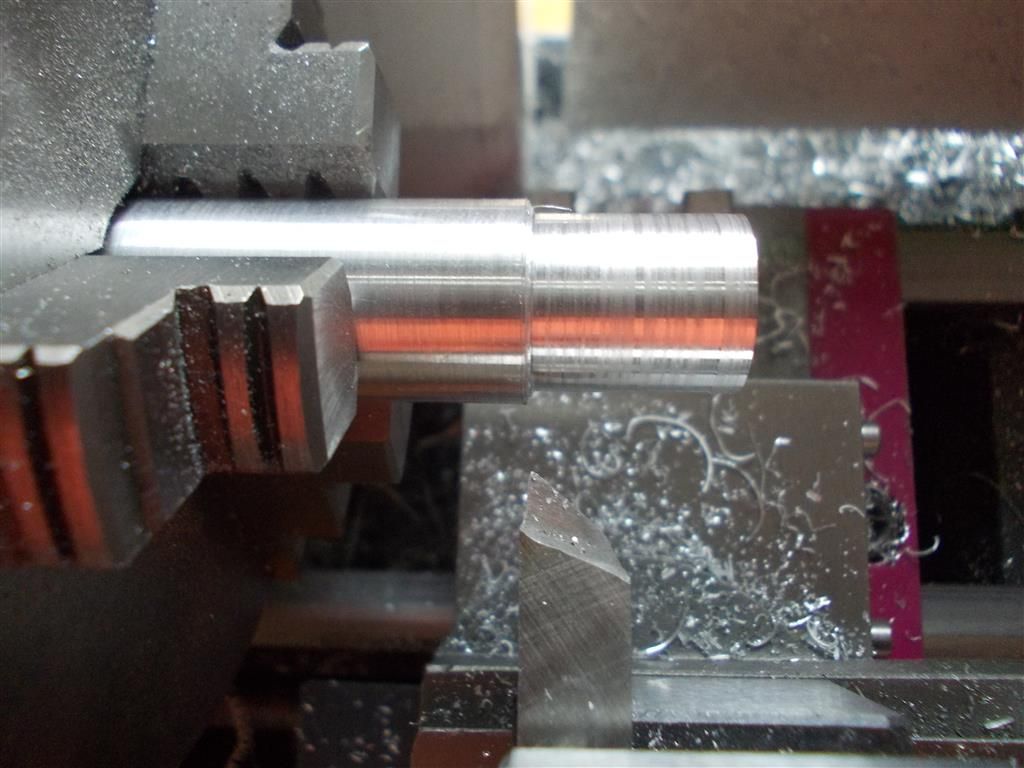

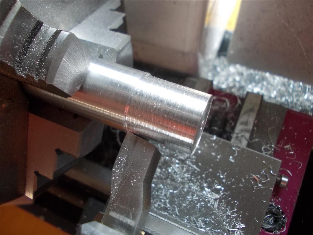

                    Here are some photos. They are the best I can do with my camera. I took 20 photos and chose the best three. In photo 3 of the mandrels you can see the finish I was getting a few days ago. The one with the washers is a good finish and what I am getting now is beside it. Photo 2 is Hopper's tool ; we know that one is sharp.
                    Auto feed is MUCH worse than manual feed. All these photos are of manual feed.
                    Did somebody mention raising the tip of the tool height slightly above centre ? How does that work as I thought the tip should be in line with the dead centre of the tailstock ? I may try raising the tool by one shim later tonight.

                      Looking at photos ,the tools are not suitable for finish turning,and I would not expect a better finish, the top tool with the groove is only a chip breaking tool for roughing and the second tool is too pointed,they both have side rake but no back rake,get someone to show you how to grind tools.
                      #204352
                      Hopper
                        @hopper
                        Hi Brian,
                        What did the tech have to say when he visited on Monday?
                        Which feed rate are you using? Have you made any changes to the feed gears at the left hand end of the headstock?
                        A couple of suggestions you might try:
                        • Drill a centre hole in that test piece and put the tailstock centre in place. Try taking same size cut with the same tool at the same feed and see how it compares. Let us know how the finish compares. If a centre improves the finish, the problem may (MAY) be spindle/chuck-related rather than carriage-related.
                        • Turn that toolbit we made around and try the other end. ISTR we put a bit of a radius on the other end which might help. The end you show in use was for getting in by the centre for facing etc.
                        • Try some different materials in case you have a piece of soft ally there, which will not turn well. Try the same ally you were using for the first mandrels you made and were happy with the finish. Also, try a bit of mild steel.
                        • Try varying the rpm. For ally about 12mm diameter ally you would usually run about 1,000 to 1500rpm. For 12mm steel, try about 800rpm. If no good, try going incrementally faster or slower.
                        • You mentioned you could see the tool moving in and out. Check if the movement is the carriage on the bed, or the cross slide on the carriage, or the top slide on the cross slide. You can check by putting your finger where the one part joins the other and feel for movement while taking a cut. Let us know what you feel.

                          The middle picture looks very much as if you are suffering from build up on the tip of the tool. This build up periodically breaks off which is why you get the cyclic variation. Hand feeding will provide a bit of variation with the feed rate which will help to break off the build up. Power feed is smoother so build up is probably worse. A dab of lubricant on the job should help considerably. Anything fairly oily will do but kerosene (paraffin) is the usually recommended lubricant for aluminium.
                          Well, that's my take from 12,000 miles away smiley

                            One other thought on your poor finish Brian. It seemed to happen at about the same time you got some materials from the scrappy. Are you getting this poor finish on material from him or are you still machining the same stock you used on the early mandrels?

                                  "Did somebody mention raising the tip of the tool height slightly above centre ? How does that work as I thought the tip should be in line with the dead centre of the tailstock ? I may try raising the tool by one shim later tonight."
                                  I doubt that anyone suggested that. Your tool tip should be at centre height. If you can't ensure that it is precisely at centre height then a thou or two below is acceptable. To set the tool, do a facing cut, starting with the tool below centre height, and gradually raising it until the pip just disappears.
                                  Have you tried Jason's suggestion of locking the carriage and using the top slide for a longitudinal cut?

                                    I did mention above centre turning in another thread. It's something people who can turn normally might like to play with.
                                    If aluminium is sticking to the tool try reducing the speed you are using by 10 – 20% . Use Hopper's tool and as he mentions a rad will help improve the finish but it will also do something else that may help. If there is any aluminium sticking to the tool it can be flicked off with say a small screw driver or what ever.
                                    Hoppers suggestion of using a centre will help correct another problem. If you don't have a revolving centre there will be need for some lubrication on it – lard out of the kitchen will help, grease would be better but if the centre is too tight it will still get hot and the ally will expand making it even tighter. It can expend when it's being turned as well.
                                    Next question is that after you have taken a cut does the tool cut again when the tool is just wound back to the start without the centre in? Much – tiny shaving etc? Also if you measure your work is it showing much taper along it's length ? Do things improve a bit if you keep taking the same cut?

                                      I will try to answer all the questions but forgive me if I miss any. I was helping my wife with her new bicycle.
                                      I knew somebody mentioned raising it ABOVE centre height but I was not sure where I read it. I have tried this and it DID improve the finish quite a bit. Why should this work ?
                                      The technician never came a second time. I was hoping he would call back today but that did not happen.
                                      I am using about 800 RPM. Increasing or reducing the speed does not seem to help the finish.
                                      This is the same Aluminium that I have been using the whole time. It is from Norweld …not the scrap yard.
                                      If I do not wind the tool out at the completion of a cut but wind it back along the piece (lazy !) then yes…..it does take quite a bit off on the return. Something I was surprised at. It has always been like this.
                                      Using the centre is probably a bit worse than without a centre ; it certainly does not improve things. I do have a live centre but it is much bigger than the dead centre, making it harder to get in close on the tailstock end. I tend to only use the dead centre now.
                                      No changes have been made to the gears. I am not going in there for a while !
                                      NIgel says the top tool is not suitable but this is the RH cutting tool from the Arceuro set. Does anybody agree or disagree with this assessment ? Which is the finishing tool in the set ?
                                      Hopper : I have tried both ends of the tool.
                                      The movement I was getting was definitely in the carriage and there was a LOT of it….you couldn't miss it. You could see the tool moving up and down as you took a cut. All movement is gone now after I tightened up the adjustment screws underneath. It took me many goes but there is now no movement at all when I try to rock the carriage by hand. This is why I am surprised that I am still having problems as I was sure this was the cause.
                                      NOTE : I prefer kerosene to WD40 but I will try both.

                                        If the tool is a tad above centre it may be rubbing slightly and polishing the surface or more correctly burnishing the surface. Did you mention how the swarf is coming off. With a good turning tool for aluminium having a good degree of rake the swarf should come off in ribbons with a nice swooshing noise a bit like cutting silk.

                                          The swarf does come off in long ribbons (nuisance stuff) but I cannot hear any swooshing noise because of the noise of the motor/gears/belts.
                                          I forgot to mention before that I did try locking the carriage down and using the top slide to take a cut but there was no improvement at all. I was surprised at this.

                                            What diameter aluminium bar do you have ? I'm pretty sure I know what is causing the problem.

                                              It is 16mm diameter.
                                              #204401
                                              Ajohnw
                                                @ajohnw51620
                                                Use hopper's tool with the radius and set it on centre with the tailstock – usual thing – a very slight touch low to actually on centre. Be sure it's not above centre.
                                                Have about 50mm sticking out of the chuck but make sure you are gripping it correctly. Face the end. If I'm right you will probably get a pip left in the middle that you may be able to keep going at to remove it or the tool might just always seem to jump under it. Often they just break off.
                                                Then take a cut along it to clean the outside diameter up. I think if you stop at the end of the cut and measure the diameter up by the chuck it will be less than the end because the bar is lifting. It can do something similar if the bar is bending but I'd be surprised given the size of cut you can take if that will have much effect on 16mm bar.
                                                As you may have problems with the first cut try the same thing again. The let us know what the difference in sizes are.
                                                I suspect the bearings are loose but it really would be best to REALLY ensure that this is causing the problem before doing anything about it. It explains the rings your getting because the cut lifts the bar but each time the feed rate drops off the bar drops and creates a ring. This can be improved by increasing the feed rate especially if power feed is being used – the cutting pressures stop high and constant enough all of the time to hold the work steady. The cut has to lift the chuck, spindle and work. I'm hoping 0.3mm is enough but the rad on the tools will help. If the feed is too slow all sorts can happen. If the work lifts as it's being cut the tool will cut again when it's run back to the start. That can also be down to the work bending – centres help with that. This is why hand feeding isn't easy because there is always some degree of flex some where or the other and even micron deep grooves will show. The better the finish produced the more apparent they will be.
                                                As this has happened rather suddenly it shouldn't be bearing wear which will cause the same problem eventually. What can happen when lathes are assembled is that the bearings aren't pushed fully home so they move when the lathe is used. My Boxford had this problem even though it had seen years and years of use before I bought it The bearings loosened each time I drilled a 1in hole. Looking at the results you have had it wouldn't surprise me that if you held 300mm of bar tightly in the chuck you would be able to waggle it about and feel the play. People are usually concerned about amounts that need a dti to detect – some also bend the bar trying. It's always best to check this sort of thing by turning unless the problem is rather gross.
