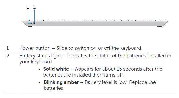

      Having treated myself to a new Dell 5400 all in one Desktop with wireless keyboard and mouse, I have failed to get the keyboard to work at all. The mouse is fine.
      On delivery the positive battery contact was not making contact with the keyboard sprung connector. I teased the connector out and it now seems OK. The keyboard was replaced by Dell with exactly the same result, dead.
      My question for computer buffs is :-Should the led's for capital lock and numerals lock light when activated by the keyboard keys? I assume that the power for these led's comes direct from the keyboard itself and there is no signal from the PC to activate these led's. I confirm the led's do not light as I thought they should.
      An alternative wireless keyboard and mouse work fine with this PC

        Journeyman
          @journeyman
          Yes power for the LED's comes from the keyboard batteries. Silly question but have you checked that there is not an on/off switch. One of my keyboards has a little slider switch that is easily overlooked and left me wondering why things aren't working.
          Some of the Dell keyboards have a little slider switch on the back right hand side.
          Edit: Add Image
          Edited By Journeyman on 17/11/2021 10:20:33

              There is no on/off switch. Re the other response I was not aware there was any communication FROM the PC to keyboard

                        Bryan Cedar 1
                          @bryancedar1
                          Silly me!
                          I should have put my glasses on but failed to spot the rather small o/off button. All working now.
                          Thanks everybody who responded. The main unit has a on/off button that is completely out of sight and IS a job to know it is there.
