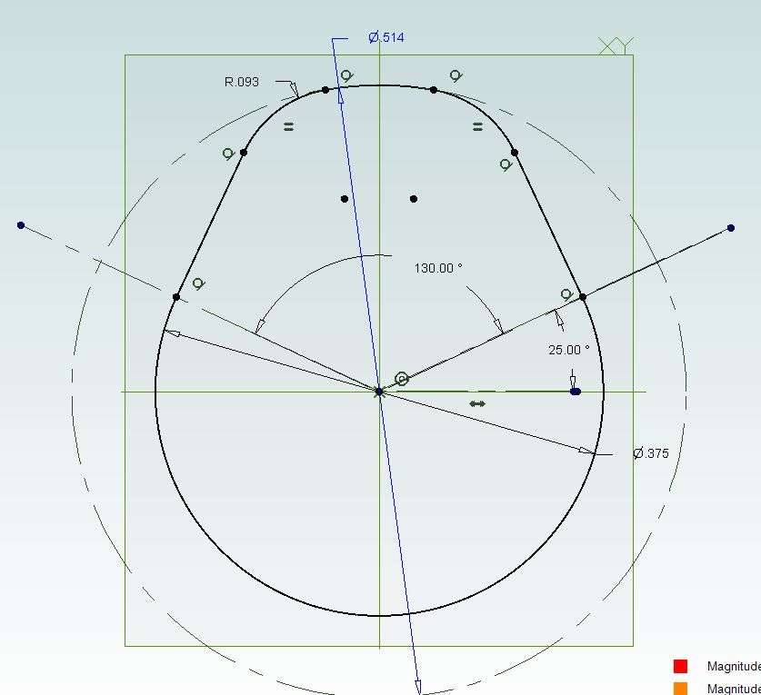

      Its for a four cylinder Gypsy engine, the plans show that the cam is built up from separate parts ie. the lobes and bearings are machined then Loctite onto the shaft.
      Now I understand what a camshaft does and how it operates but I have little knowledge of making one. After some research I feel making the lobes on my mill using small flat cuts with the aid of a rotary table would be the best option for me.
      So I need to come up with some figures for the machining process.
      The plans show just one lobe as below
      There is also a timing guide and some plans for a jig which I am not sure how its used but I assume it may be for a grinding machineimg_1297.jpg

          Looking at the timing it shows the crank moves 240 degrees for the inlet and 260 for exhaust so that would be
          120 and 130 for the camshaft . On the dials for the jig it states 130 / 140 which confuses me .

              As it is a flat flank cam you don't really need camcalc.
              Just turn up blank with a 0.514 diameter but best not to part off so that you have something to hold.
              Mount on the rotary table and zero it's handwheel, bring the cutter into contact with the 0.514" diameter and zero the axis. Put on a cut of 0.069" ( 0.257 – 0.375/2) lock the slide and make a cut. Rotate say 4 degrees and make another cut, rotarte another 4 degrees and cut.
              carry on like this with the last cut being 230deg ( 360-130*) for the exhaust and the last cut being 240deg (360-120*) for the inlet.
              You will get a flatter topped cam than shown on the drawing and the last job is to file the 0.093" radius and blend in the facets around the base radius
              *The jig probably has a larger angle so that when the tappet clearance is taken into account the cam will have an actual effective rotation therefore opening of 130/120 so machine yours to the larger angle

                  That's great Jason thanks , I presumed the flank had a slight radius, just curious but how do know
                  the flanks are flat.
                  #403792
                    As it does not give a radius on the drawing presume it is flat.
