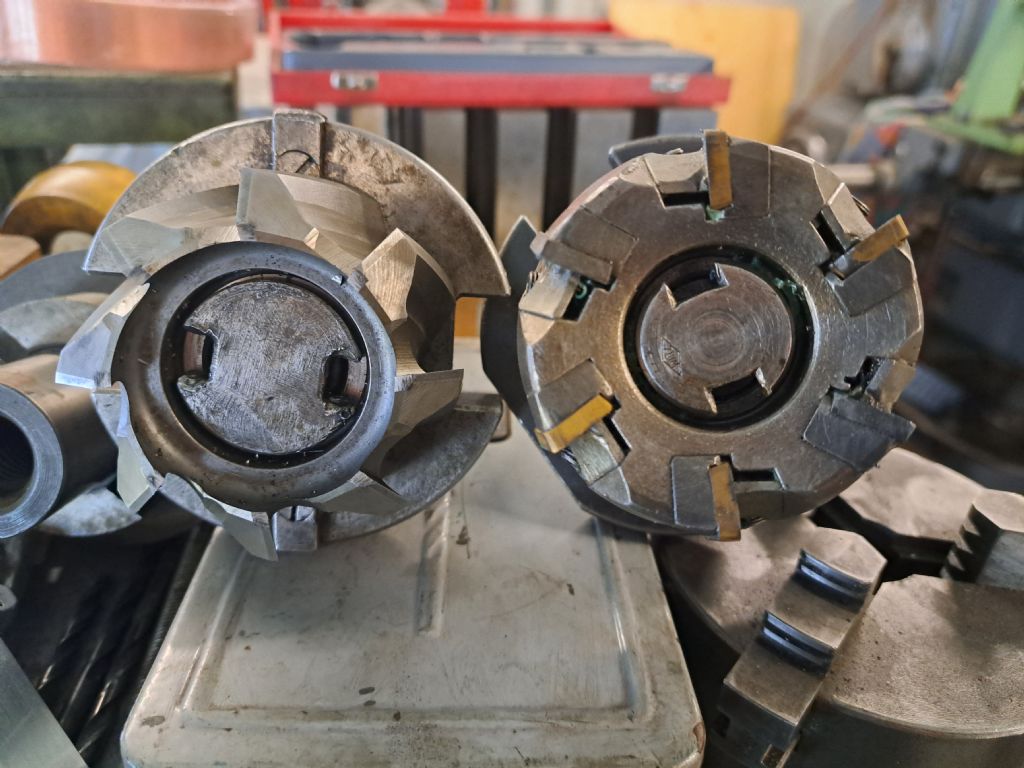

      I'm really sorry to ask such a basic question. What's the right name for the tools used to loosen or tighten the retaining bolt on these tool holders for the mill? It's a European mill and metric.
      It's my generation – we were just taught to always expect a hex / imbus retaining bolt on tool holders and I don't know what the tool is called for these.

          The name I'm familiar with is the highly unimaginative "Shell Mill Arbour Spanner", although as most shell mill arbours use a nut with four cut-outs, they also get called a "Cross Spanner".
          If you're struggling to source a two lobed spanner for it, you might find that a drum key (as used for opening 205 drums) will work on yours depending on dimensions (hard to have a sense of scale, but those look a bit like iso 50 holders) else I'd probably manufacture a beefy pin spanner from some scrap or buy a cross spanner and grind two lobes off.

            They may not have a name because they are likely to be proprietry tools which only fit those cutters. I would unscrew them with a drift and see if it was easy to make something more spanner friendly. The heads will have to be low profile, though, I made a strange mark across the work surface when the SHCS on a new shell mill contacted before the inserts did, due to an over thick washer.

                      We've got a whole cupboard of those arbours at all different sizes – 10 or 20 in total – so need a set of tools for them or one adjustable tool.
                      Thanks for mentioning mill arbour spanners – agree about the 4 points – all the mill arbour spanners that I could find had 4 points not 2 and the geometry of the points was different.
                      An adjustable pin spanner might well be a way to do it – I hadn't seen the characteristic two round holes for a pin spanner so I hadn't thought of that and the adjustable pin spanner I have here is for much smaller, lighter things.
                      There also seems to be a much heaver duty version of a pin spanner – an adjustable gland nut wrench – intended for the glands at the ends of hydraulic cylinders – so I've ordered one of those. The pins are round not square so not a precise fit but might be good enough. I'll see how things go with it and if it doesn't seem robust enough I'll turn down a piece of stock to the right diameter for each arbour then mill the two teeth in the ends of those.
                      Thank you all very much for letting me know that they're proprietary – I was beginning to wonder if I was going crazy not knowing any standard tool for them.

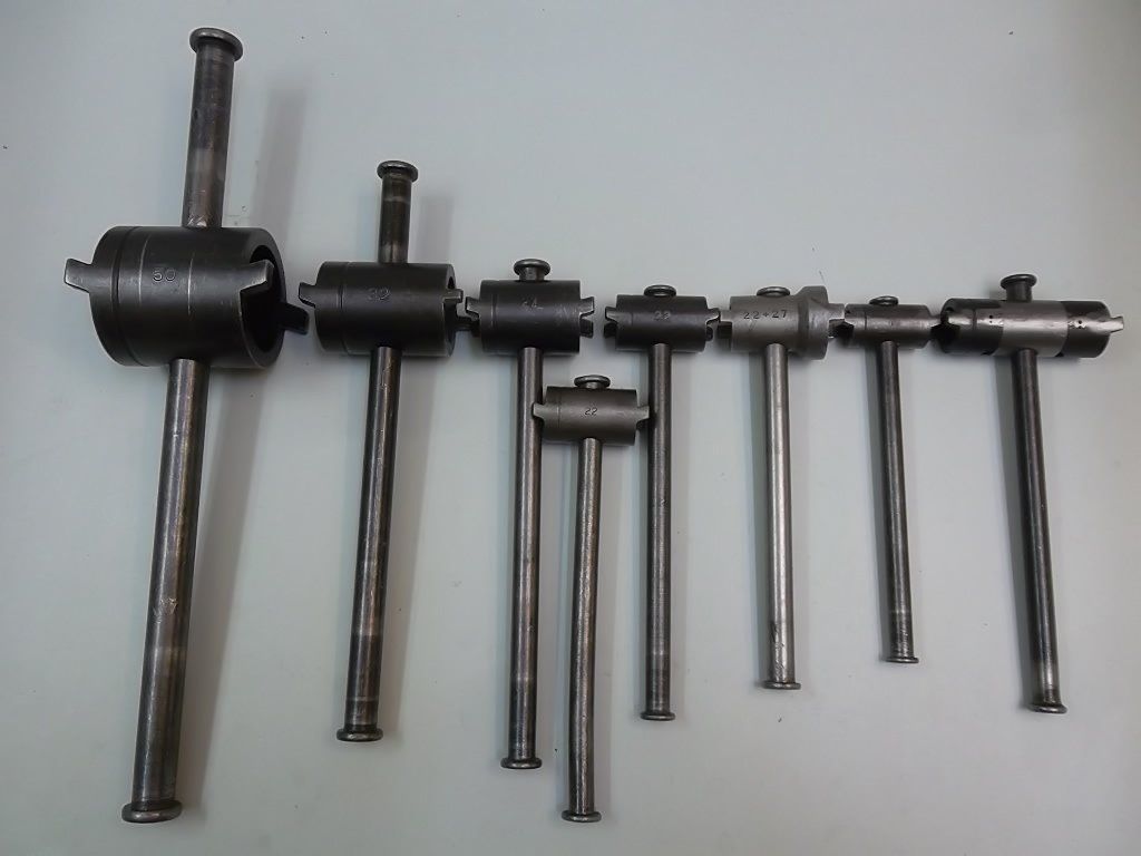

                                  I eventually found the right set of 8 tools – the seller was selling them as "Spannschlussel" so I don't think he was sure of the formal name for them either – Spannschlüssel covers a fairly wide range of tools in German. Would also have been fun to make them on the lathe and mill.
                                  Spannschlussel
