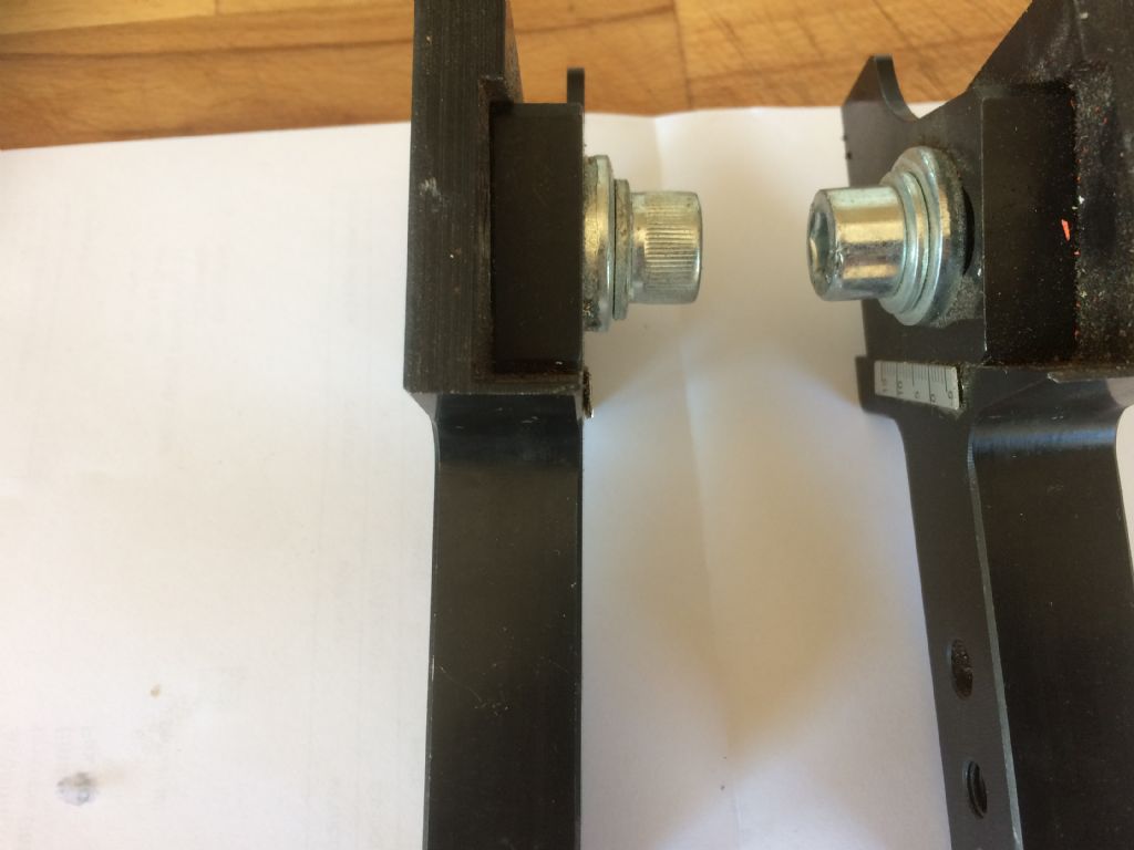

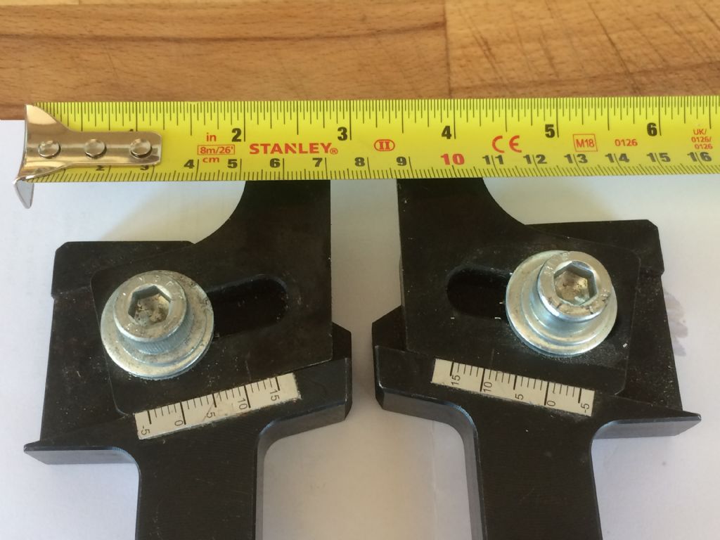

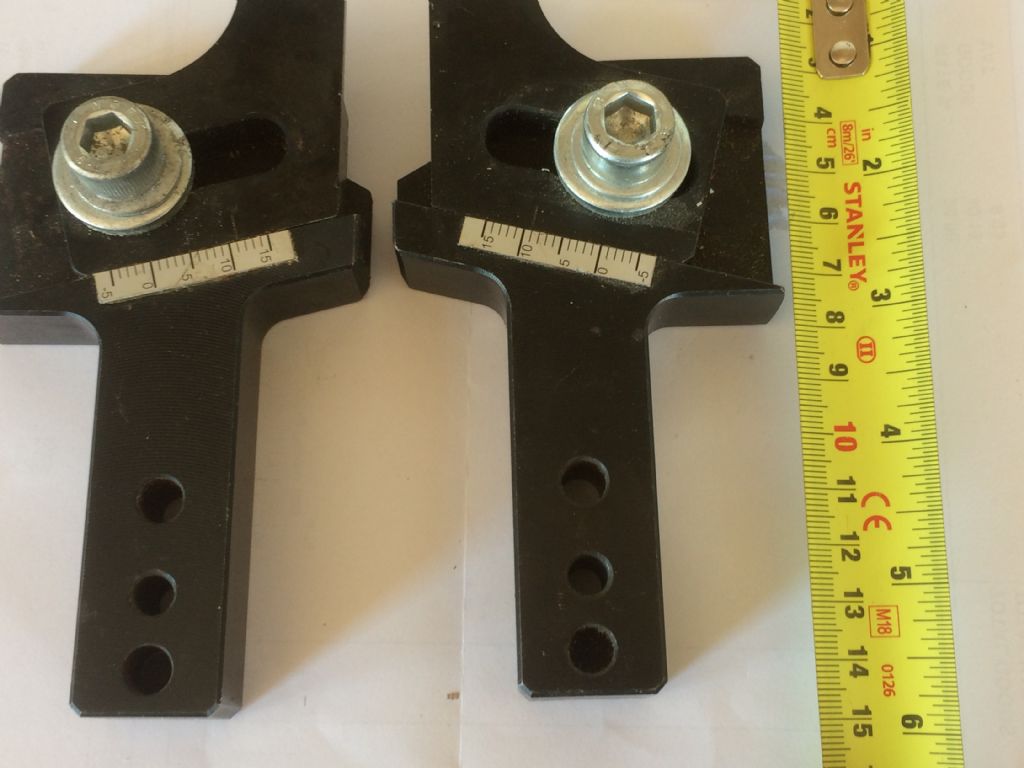

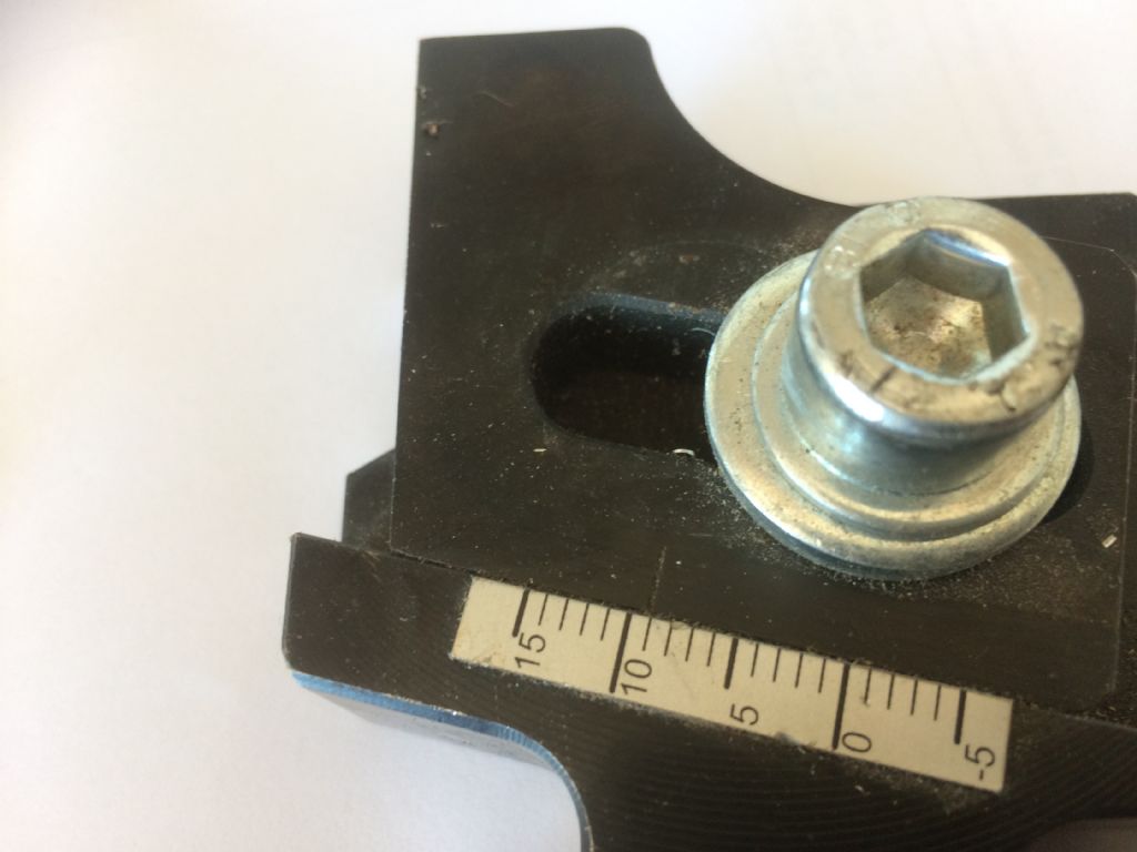

      img_1188.jpgimg_1186.jpgimg_1185.jpgmorning all these came in a box of lathe tools any ideas what they areimg_1184.jpg

          Geoff,
          The fact that they look like a left and right setting tool makes me think they might be used on something like a fertilizer spreader, or similar, where contra-rotating throwers are involved. Just cannot understand why there is a negative setting.
          We had to change the settings on a spreader recently and the instruction book was like a minefield to negotiate – what with prill size, machine height and slope, width of spread for the desired rate, ground speed, etc.
          If they are anything to do with mills and lathes I would have no idea, but at least this is giving the thread a ‘bump’.
          #473784
          geoff adams
            @geoffadams14047
            thanks for the reply they were going back in the shop as an unknow yes they are handed and the middle of the three holes is threaded
            Geoff
            #473787
            DiogenesII
              @diogenesii
              ..holders for (maybe the circular-type) thread form tool?
              #473835
                Something to do with levelling maybe, not necessarily a workshop tool at all.
                I guess the handle part sits in a missing base and is set roughly to height with a pin through one of the plain holes. Then the adjustable top part is finely adjusted to height by sliding up the scaled ramp and clamping. Something fits loosely at a right angle between the flanges at the top. Lens, mirror, parallel, work item, no idea what.
                Not a precision tool as used on an Optical Bench, but I suppose with a laser it would do a good job levelling over a metre plus.
                A couple of features don't fit with my guess:
                • The tools are right and left-handed, why?
                • What's the threaded hole in the handle for?
                #473840
                  Posted by SillyOldDuffer on 22/05/2020 09:53:30:
                  The threaded hole, plus two ‘dowel holes’ suggests to me that these might be for attachment to a beam [cf Trammel Heads] … The handed pair, featuring fine adjustment, then makes a caliper.
                  I would probably look to the picture-framing business, or similar.
                  Edit: ___ So I did look, and found this : https://youtu.be/x1n9tQrQodk
                  Not the same; but perhaps a family resemblance ?
                  Edited By Michael Gilligan on 22/05/2020 10:14:05

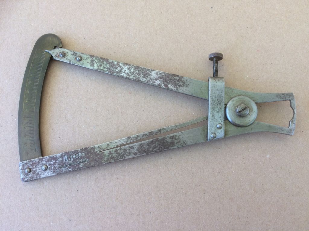

                    Add this one to the list. Its from a watch / clock maker.
                    The "bezel" is marked in degrees, 0-72 with sector markings every 6 degrees. At zero degrees, the anvils are closed, at 72 degrees, the anvils are approx 0.6" wide. Makers name is IME England.

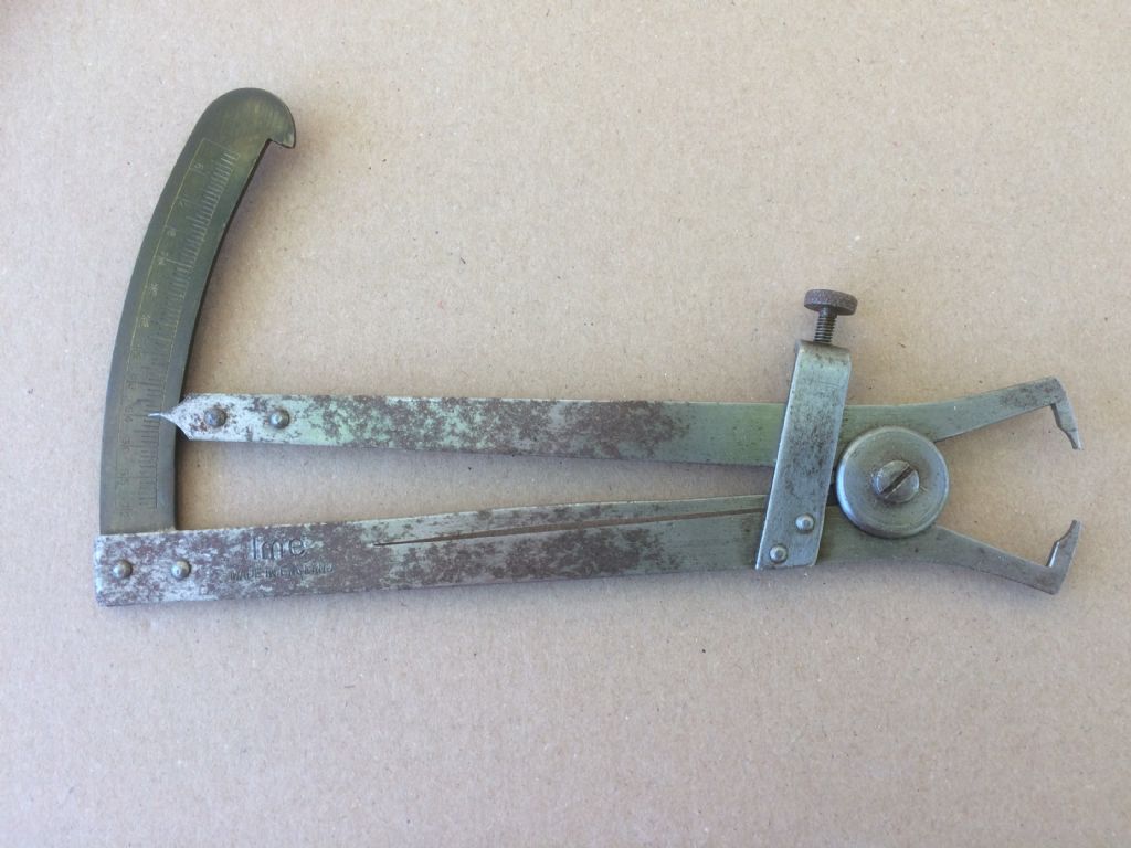

                    Edited By Speedy Builder5 on 24/07/2020 11:10:22
                    #487350
                    Martin Kyte
                      @martinkyte99762
                      The gauge is a Douzieme Gauge. Used to measure thickness of curved surfaces, for example watch cases. Increments are in 12ths of an inch. 1/12 x .72 = 0.6"
                      regards Martin
