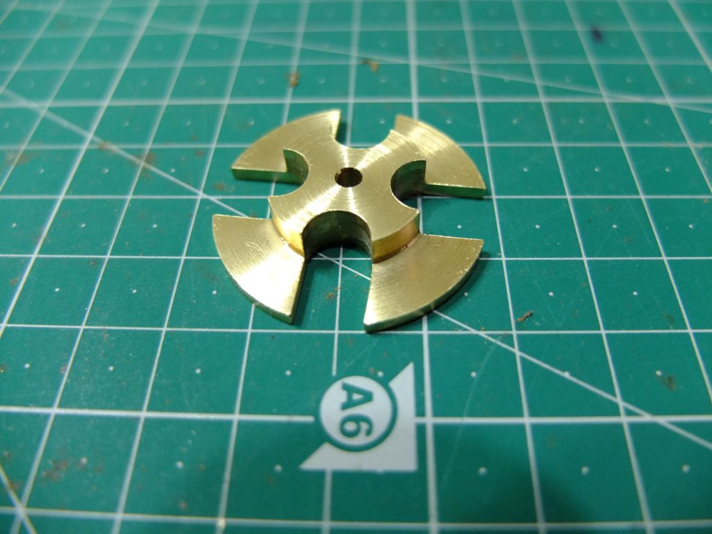

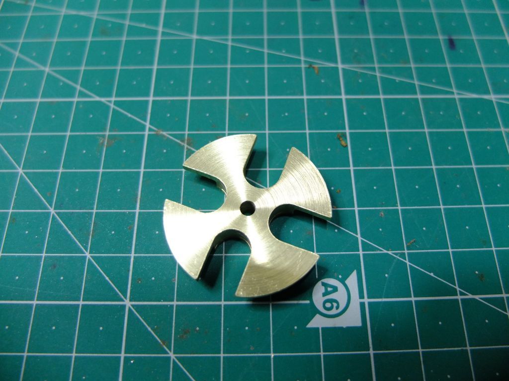

      I made this very handy gadget the other day and it has already come in useful used with the lathe and mill.
      Can anyone guess what it is for?
      No prizes I'm afraid!
      Steve

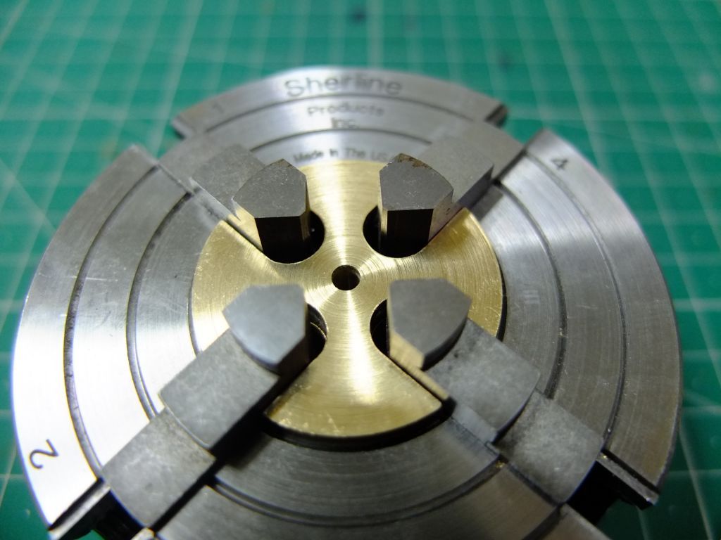

          I imagine it's for holding or centering something in a 4 jaw chuck?

                    Holding the jaws of a 4 Jaw so that they can be ground externally?

                      I made a few just like that in different lengths for gripping short parts in the lathe chuck.
                      #438673
                      Martin Connelly
                        @martinconnelly55370

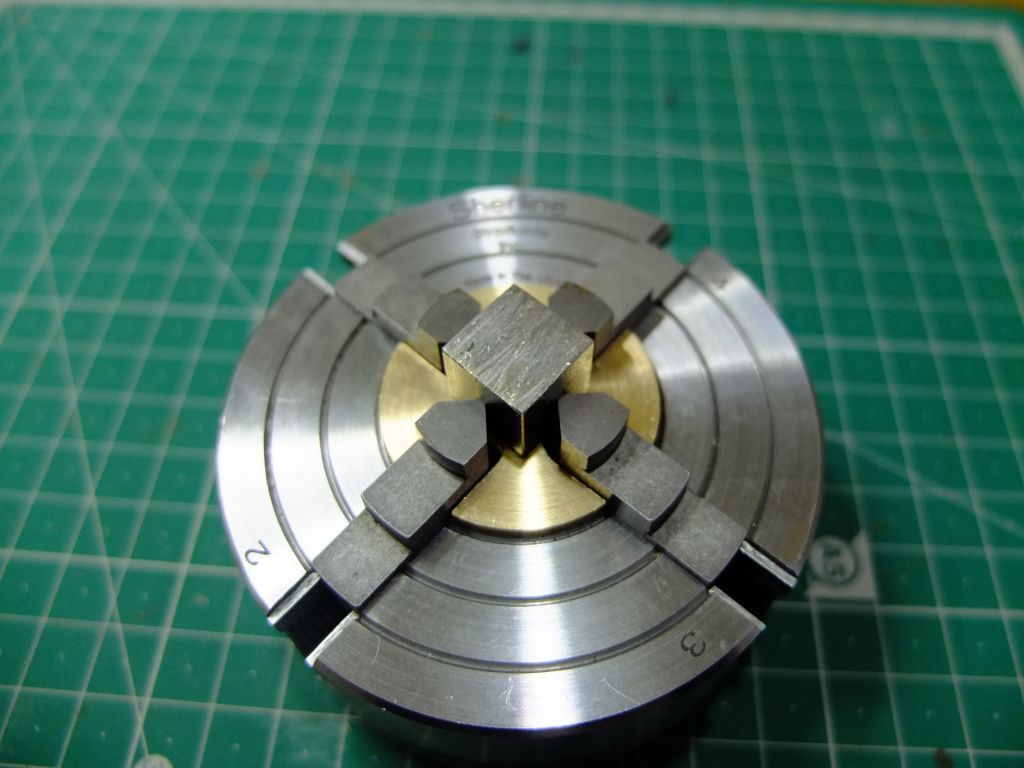

                        Back stop for short lengths in a chuck so you can machine to length easily. Very useful if you need a number of parts turning to the same length. I put a collet in the spindle and put a length of pipe or tube in the collet to do the same thing.

                            First reply (Mr. Hollowpoint) and others were correct. I've got quite a few parts to make from short pieces of 1/2" square stock. This gives me a back stop and a support for small stuff. And it also helps with centering. Very handy!
