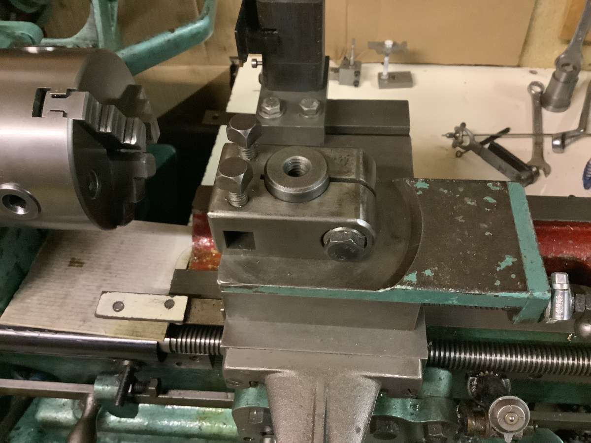

              Jss
                @jss
                As far as I know this is the only tool holder and top slide that were supplied with the Drummond and Myford M type lathes, unless I’m mistaken.
                IMG_0126
                The tool holder will accept half inch tools and there is ample vertical adjustment to get the tool to centre height. The pinch bolt on mine is not the original one, I managed to shear that sometime ago by over enthusiastic tightening.
                John.

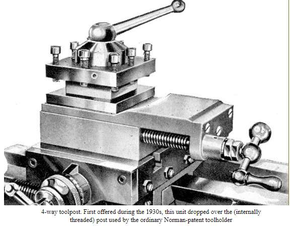

                  @danielbrannan48897
                  According to the lathe bible they did make one and it looks identical to mine
                  http://www.lathes.co.uk/drummondaccessories/

                    peak4
                      @peak4
                      Ah, but many folk would think of the one on that page as a 4 way, rather than a quick change

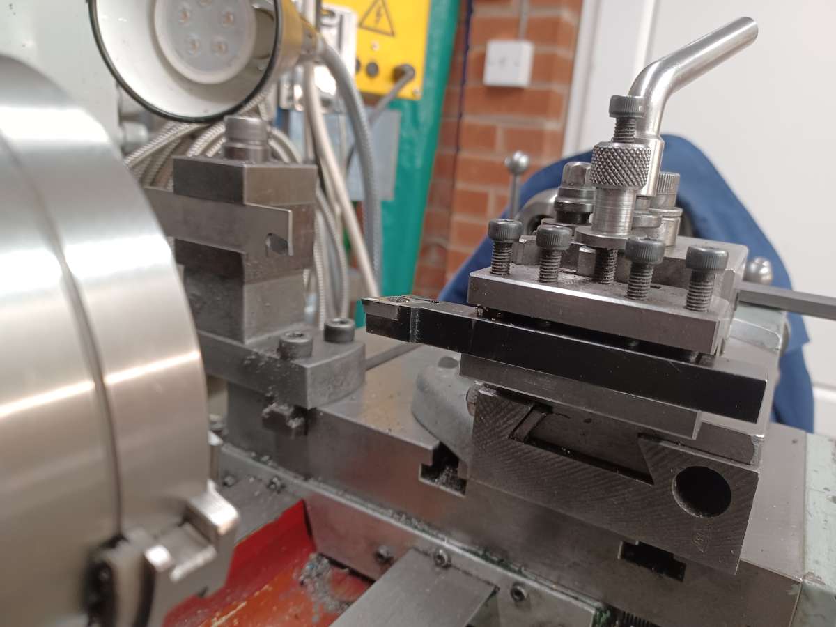

                      image_2024-02-05_183718171

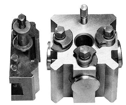

                      I was, wrongly, guessing you meant a Dickson style
                      image_2024-02-05_184006369
                      Same issue though, toolbit is just too tall to allow the top of it to drop to centre height.
                      If however, the need a very long overhang from the toolpost for access reasons on a tricky setup, the greater size slot in the toolpost allows the use of a thicker tool, just with the end ground down.

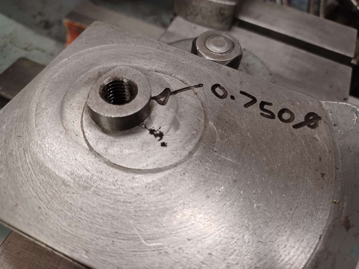

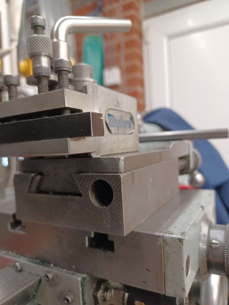

                          David George 1
                            @davidgeorge1
                            This is my M Type lathe toolpost. I have a Dixon type ho.der from Myford but I have had to remove the original post and tap a hole to hold down the toolpost and locate it.
