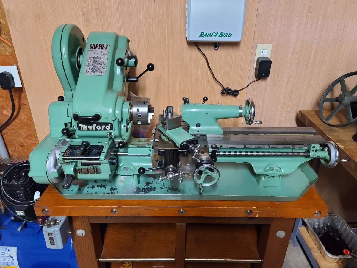

          Thanks for the suggestion.  I had considered that, but I was looking for a QC toolpost solution so that I could put the large number of toolholders that came with the lathe to use.
          Also, just for grins, here’s the lathe and its nicely done cabinet:

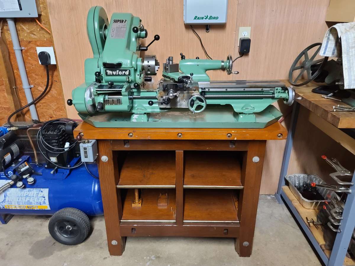

            Well, that wasn’t the glamour shot I wanted.  Let’s try this one:
            20210526_212239

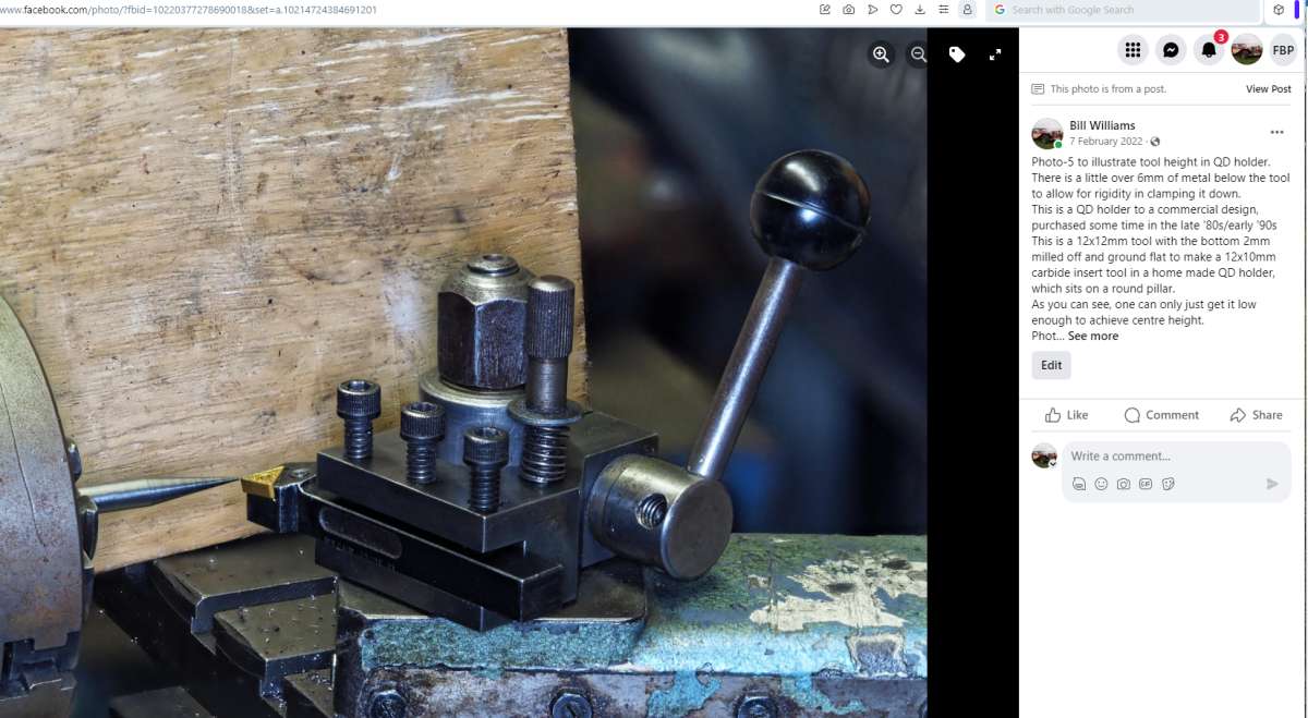

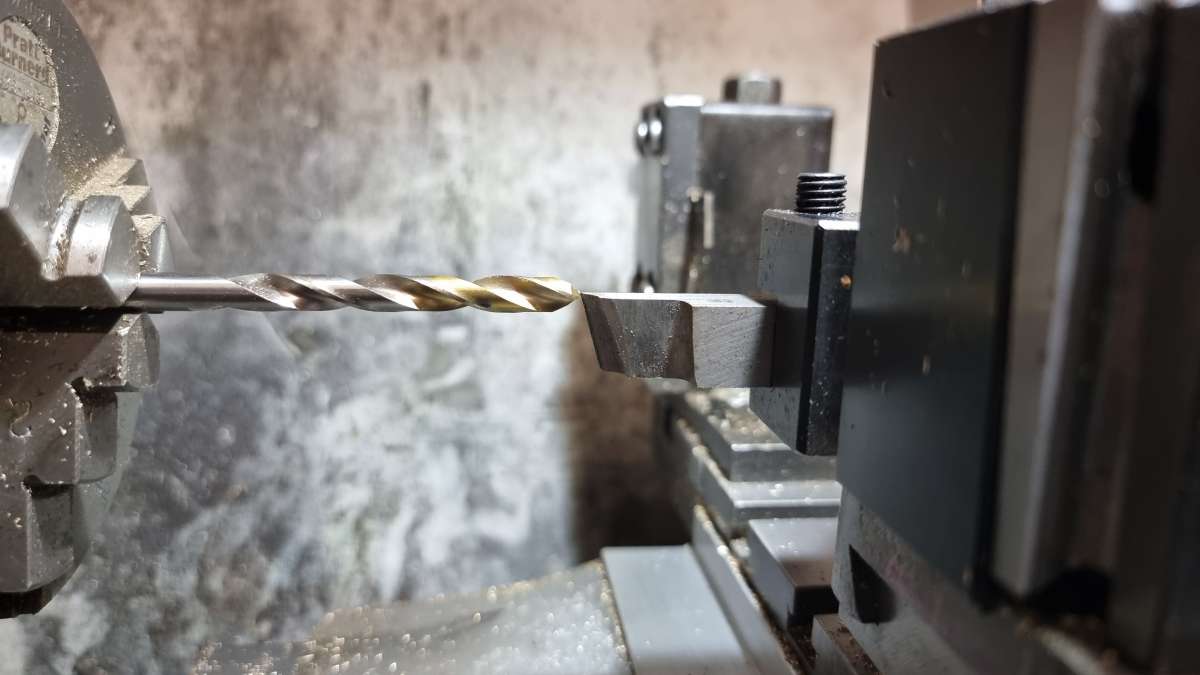

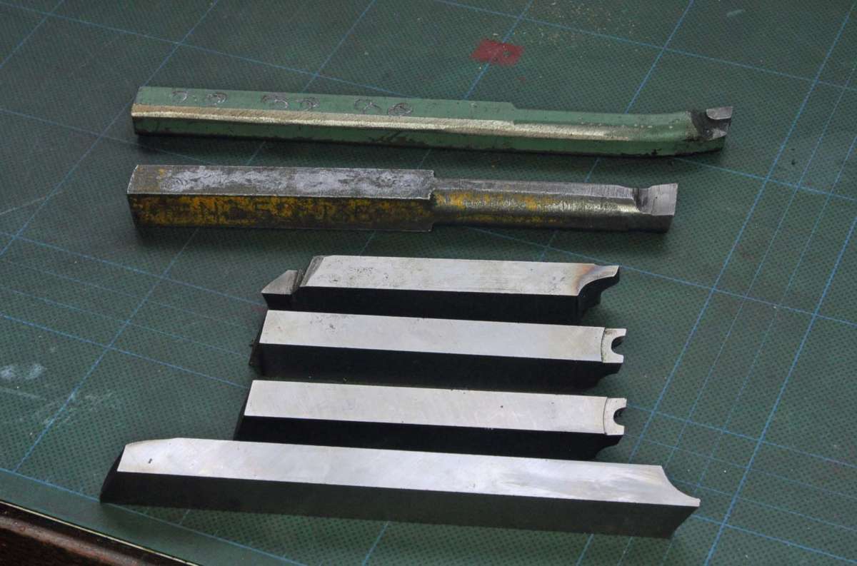

                          I’ve only got a couple of 12mm ones that I use on the Myford, but I originally milled the shanks down to a shade under 10mm thickness. Now I’ve got a small surface grinder working OK, I tidied them up to 3/8″ which give a little adjustment.
                          Seems to work OK for me, as some of my Dickson style toolholder have slots 12mm wide, so they fit quite snugly, and look designed for the job.
                          I originally use a QR toolholder based on a round post with blocks of metal which clamped around it.
                          Some of those blocks had conventional slots, one was drilled for a boring tool, but another had a ½” rebate in the corner; as in a slot, but no base to support the tool.

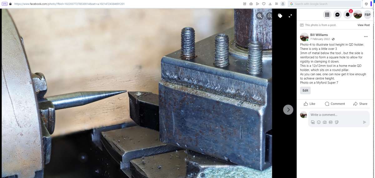

                          I then cleaned up and welded a cut down piece of bed angle iron across the corner; this gave me a very thin base, but still supported on the outer edge. Obviously this isn’t so easy with a Dickson style holder.
                          Screenshot from my Facebook album, as it doesn’t look like I uploaded it to Flickr; It used to be in an album on the old forum.
                          image_2023-11-27_213618452
                          This is a different toolholding block but illustrated the square reinforced  “hole”
                          image_2023-11-27_212701793
                          The one in the lower photo will also accommodate ½” HSS blanks. It’s been handy in the past when I’ve needed to work on something awkward which needed lots of room to keep the top slide & toolpost out of the way. If need be a small jack can be made to sit on the cross slide, to support the large overhanging tool bit.

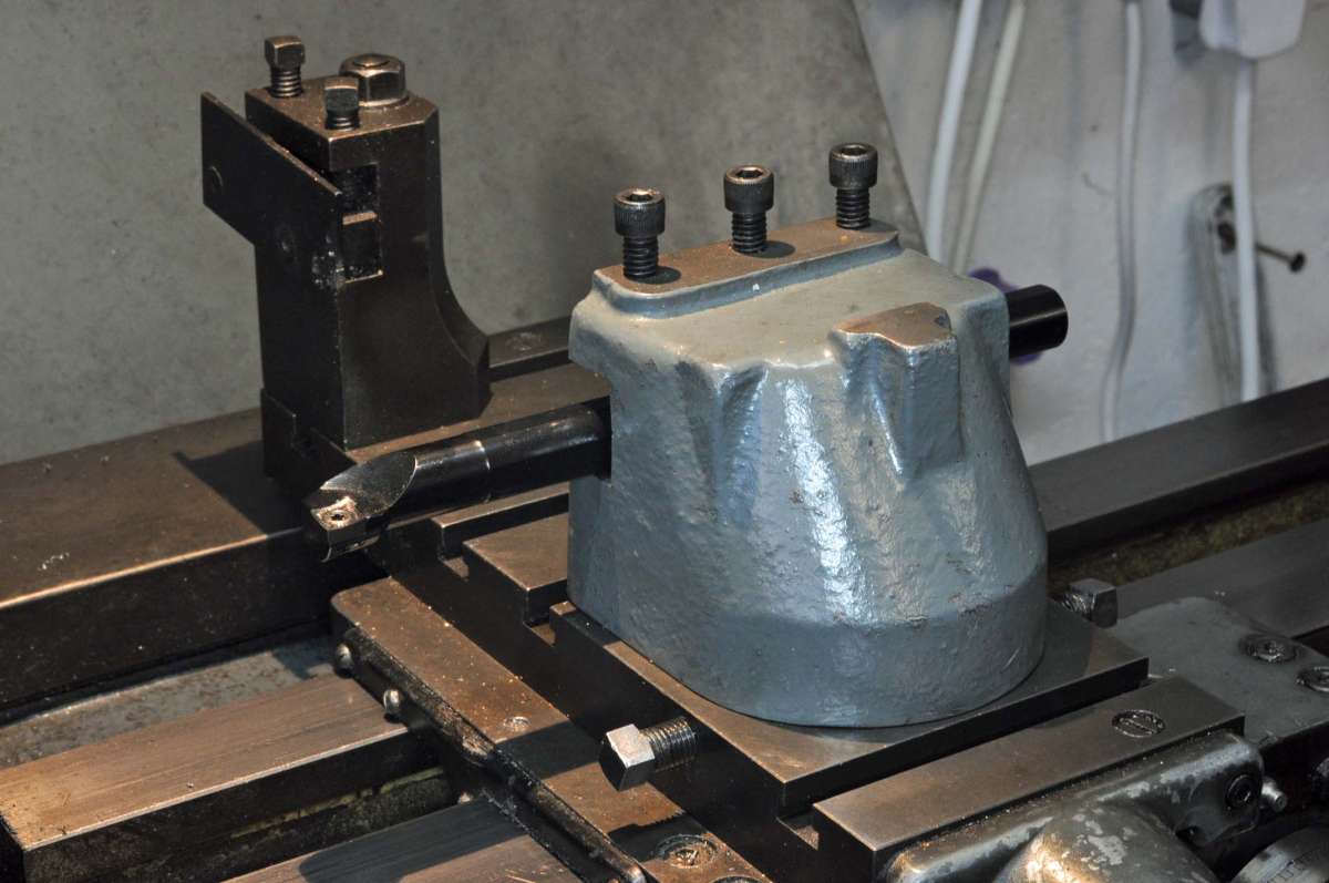

                                On my Myford S7 I use a Dickson tool post with 8 or 6mm tooling, mostly carbide insert, which has served me well for the past 40 odd years.  I do however have a few large form tools and boring bars which benefit from being as stiff as possible:
                                gib tools

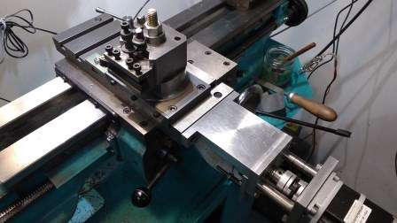

                                For these I remove the top (compound) slide and attach my Gibraltar tool post
                                gib
                                The casting for this is available from Hemingway
                                https://www.hemingwaykits.com/HK1090
                                Judging by the number Hemingway products being manufactured on YouTube recently, acquiring one from across the pond shouldn’t be too difficult.  However, the designer of this tool post, Tom Walshaw (AKA Tubal Cain), made his version from a lump of mild steel.
                                Hope this helps,
                                Rod

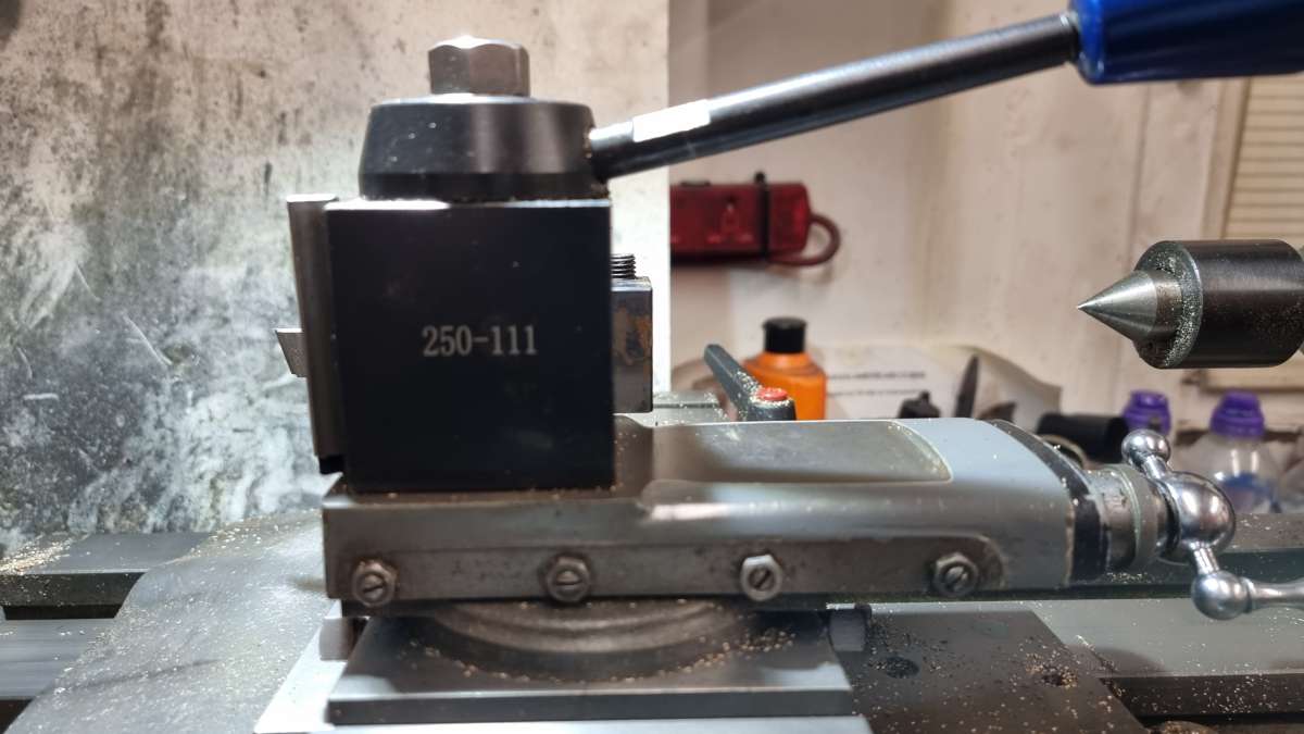

                                            I did this with my Super 7 some years ago & it is one of the best mods i have done with it. This is with a 13mm hss cutter. Look for steviegtr on youtube , all the mods i have done to the Super 7 are on there.
                                            20231130_225127[1]20231130_225238[1]20231130_225242[1]
