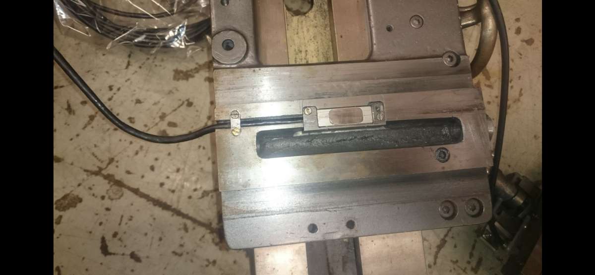

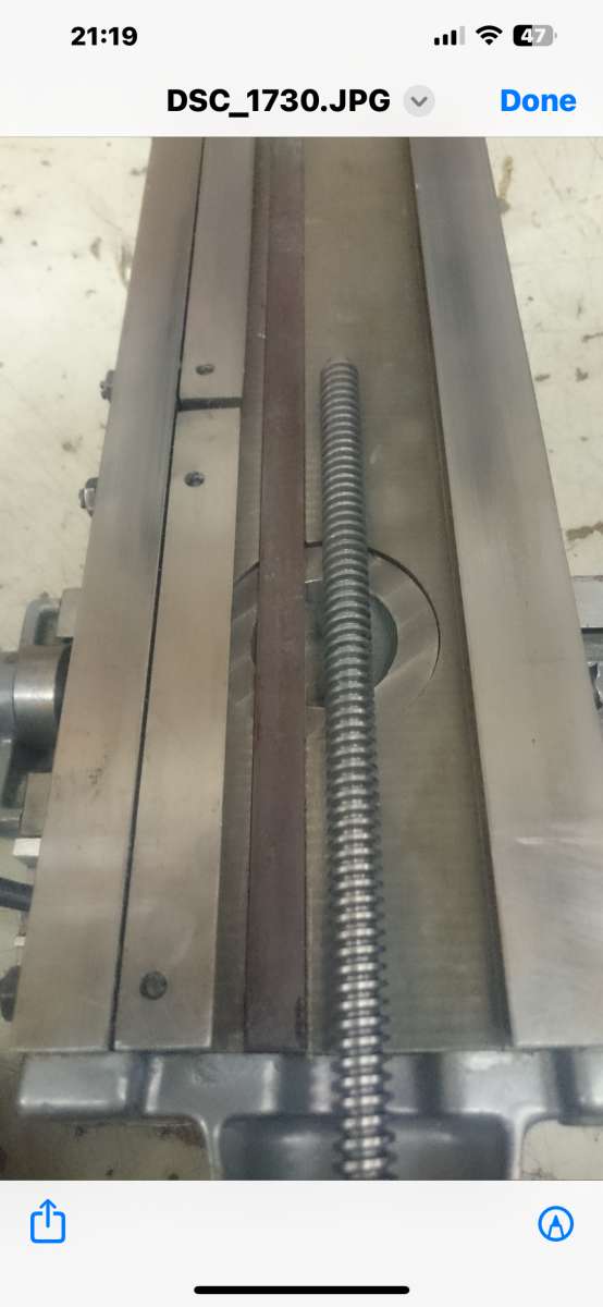

      hi all after my previous post regarding embedding magnetic scales on my cross slide, my next question is how difficult is it to remove the saddle of my Myford super 7 as I want to embed the encoder into the saddle but upon looking at removing the saddle it seems quite difficult as lead screw and apron will have to be removed first unless there is a simpler way to remove could someone advice me please please see pics to see what I plan to do thankyou IMG_4818IMG_4817

        I seem to recall that the saddle is unscrewed from the apron and can then be slid off the end of the bed, removing the apron only involves removing the right hand leadscrew bracket, none of it is difficult.

          A while since I’ve done it but the apron can be left in situ, just undo the screws at the front of the saddle and it will be free from the apron.

                    The saddle on the S7 with PCF cannot just be slid off the bed by removing the 4 apron screws as the gear that drives the cross slide feed screw extends up into the saddle preventing it from moving sideways.
                    The easiest way to remove the saddle is to remove the 2 screws and 2 dowels holding the right hand lead screw bearing to the bed and to slide out the lead screw to the right, first removing any gears and spacers on the left end of the lead screw (also make sure you remove the key and put it in a safe place, otherwise it will disappear, don’t ask me how I know!). With the lead screw removed the four screws holding the apron to the saddle can be removed and the apron can be removed by dropping it down and twisting the bottom out away from the bed to slid the offending gear out from the saddle. The saddle can then be slid off the right end of the bed after removing the hand wheel index if fitted. Re-assembly is the reverse, but when re-installing the apron do not tighten up the 4 screws, leave them quite slack. After the lead screw is installed move the saddle to the extreme right of the bed and engage the clasp nuts on the lead screw. You can then fully tighten the 4 screws holding the apron to the saddle. This ensures that the apron is aligned with the lead screw and does not twist the lead screw when tightening the clasp nuts.
                    I have done it this way many times for cleaning up after a session with cast iron  and have found it by far the easiest way.

                    grahammarch
                      @grahammarch
                      Thanks so much for the detailed explanation of removal of the saddle I believe this is something I should be able to do with a little patience and taking my time as I really want to embed the DRO encoder into the saddle as it will be a lot cleaner look for the Myford super 7 much appreciated

                        One thing I didn’t mention, is when re-installing the lead screw, look down into the apron from the right and note the position of the internal key in the gear that lead screw drives for the PCF, then align the key way on the lead screw  with it so the lead screw will slid through the apron.
