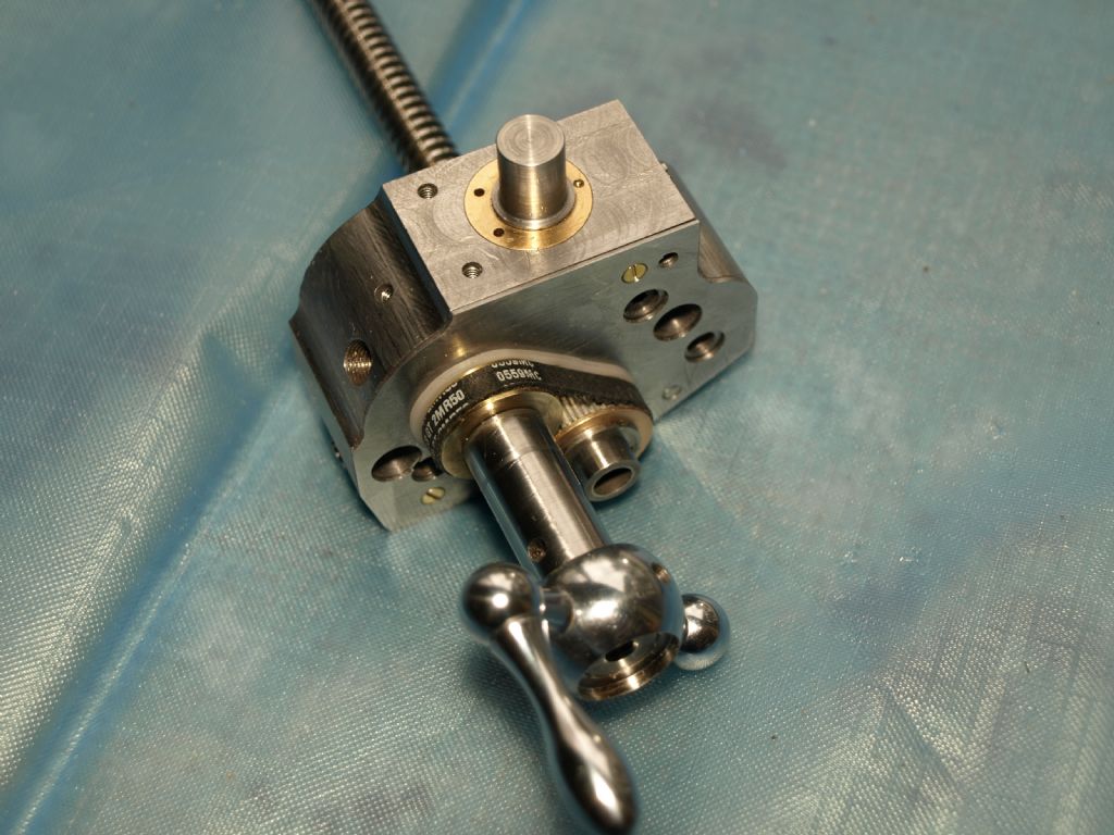

      Combination slideI'm sorry it's sideways (my phone is insisting that it be so!)
      What does the hive mind think about my Super compound slide?
      The indexing handle works as normal, albeit with horrendous backlash & not as smoothly as I'd like. When pushed forwards the small lever at the back advances the slide by precisely 1/8th of an inch & vice versa.
      Knowing something of the history of my mistress I think that I know it's precise use but I'd like to hear your unpredudiced ideas before offering my own.

          Quick retract for screw-cutting as in GHT's Model Engineers Workshop Manual

                      I too have made one, but in my case the drive is via a modified timing belt and not gearing, more complex to make but means it uses a standard leadscrew, thus keeping the rotation "normal".
                      Agree it moves the topslide away from the tailstock but the far more important use for me is in screwcutting, where it enable quick retraction of the cutter.

                        #489493
                        KWIL
                          @kwil
                          GHT+ Retractable Topslide
                          Internal photograph for those who might be interested.
                          Edited By KWIL on 07/08/2020 11:51:05

                              GHT's is normal rotation, but you have to make a LH Leadscrew!
                              #489522
                              ega
                                @ega
                                Posted by KWIL on 07/08/2020 15:10:39:
                                It is clear from GHT's description that turning the LH leadscrew and nut was challenging; I think the Hemingway kit included these items.
                                The timing belt seems ideal – thanks for the photo – but was presumably not available in his day.

                                    I like the idea of the timing belt as it uses the standard leadscrew. Bought a Hemmingway kit years ago, but never built it due to other life issues and I had converted the lathe to metric, which meant making a 2mm pitch LH screw. This method removes that issue. Have both imperial and metric screws, the lathe is currrently set to imperial.
                                    What size timing belt and pulleys did you use?
