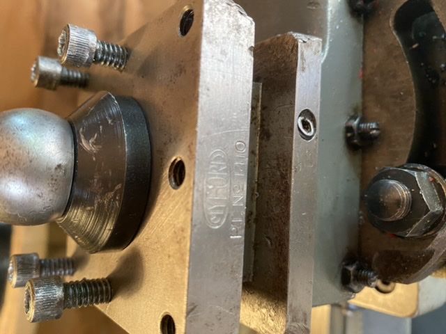

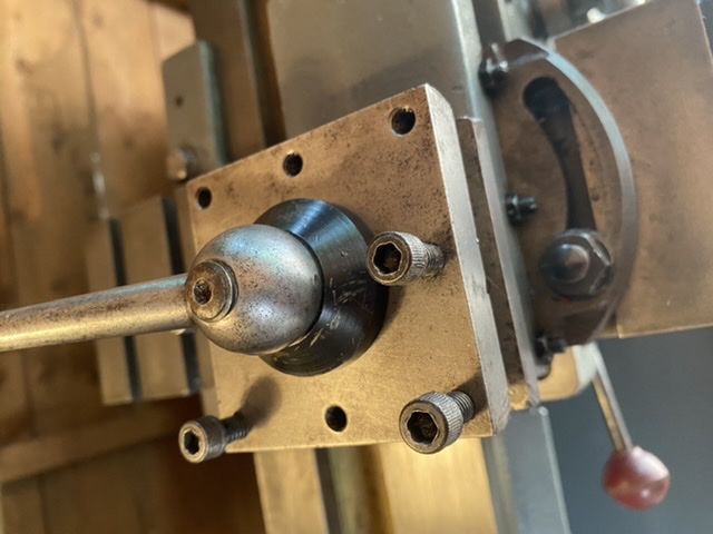

      7170f996-7e94-41a7-8f57-e40906f99346.jpegHi,
      does anyone know what size these bolts are.
      as you can see I need another 4, hopefully Myford do some spares.
      thanks

          I no longer have a Myford 4-way toolpost, but, as I remember, the screws were 1/4" Whitworth, ( or possibly 5/16" Whit.you need to measure).
          In any event, they will be available as standard Whitworth allen screws, I'd look on Ebay.

                They look like 1/4 BSW., and I no longrer have a ML7 to check, just your picture showing a coarse thread.
                If you start collecting capscrews of various sizes and threads, You will soon be able to find out such things in a matter of minutes, AND they will useful for tasks such as this, so that you can find a solution yourself…
                Expect to find threads on a ML7 to be BSW, BSF or possibly BA for gib strips.

                  Yes they are 1/4BSW – GWR Fasteners do 'em.
                  Howard, do you know if the originals had dog-points?

                    Would expect the originals to be flat ended to minimise digging into the tools.
                    In use, they probably mushroom, so might be worth turning away the first couple of threads, to core diameter, since they will be in fresh air, and doing nothing anyway. That should make them easier to remove when they do mushroom and need fettling.
                    For Chris's benefit, just go to your local hardware stockist (Here in Peterborough its Sterling Nut and Bolt ) and buy some.
                    If they have a minimum order policy, buy some others, what ever you think might "Come in handy one day" to make up the cost.

                        Surprisingly, the originals were 1/4" BSW socket head cap screws (aka Allen heads). They seem to be high enough up that swarf does not fill them up.
                        I machine the ends flat then put on a very slight dome with a file then machine the OD down to about thread root diameter for the first 1/16" or less, so that if you ever want to take it out, the thread is not burred over on the end.
                        Note when buying new screws, the length to specify is the length of the shank only, not including the head.
