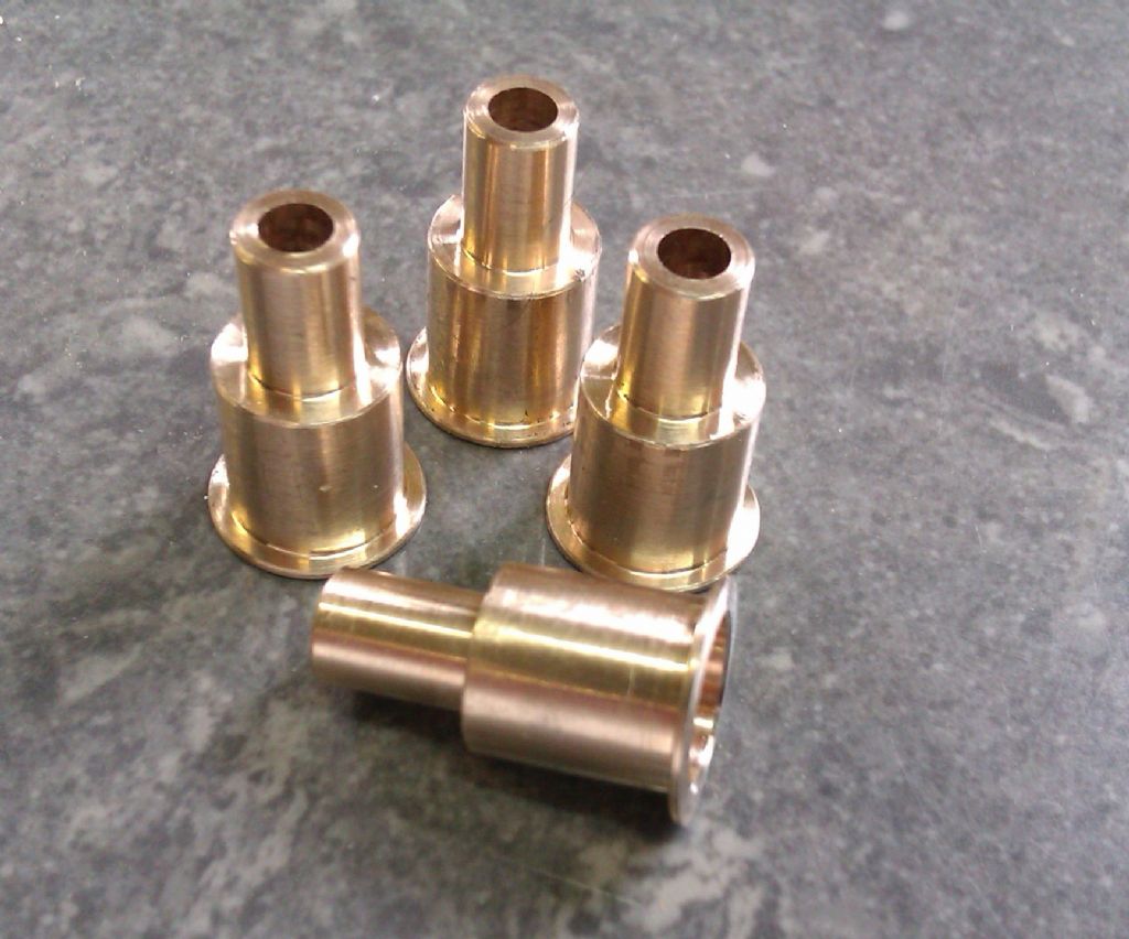

                  Matthew: I suspect that spindle speed may not be your problem. Here's a picture of a bit of 3/8" diameter brass out of the scrap bin that I've just done a quick trial on:
                  I was using the tool that just happened to be in the toolpost, with a feedrate of 2 thou/rev. The finish feels smooth and measures about 2µm Ra. The larger diameter, to the left, was turned at 370rpm, the smaller diameter, to the right, at 180rpm.
                  While brass can be machined at high speeds, it is pretty forgiving of lower speeds. So I would suggest an issue elsewhere. The two most common issues are unknown material and incorrect tooling. What are the characteristics of the poor finish?
