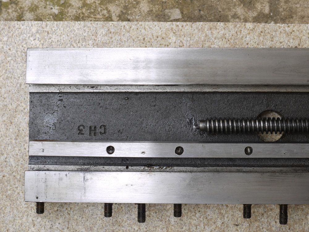

      Where can I get new gib strips for my Myford ML 4.
      #10213
      Steven Kane
        @stevenkane39097
        #469682
          I suspect you will need to make them … which might only mean ‘make from’ another item.
          Do you have the old/worn/bent ones as a pattern ?
          #469684

            #469689
              Pete
              Personally … I would use gauge plate, for its flatness, smoothness, etc.
              Lubricant can be applied
              I’m sure there will be other opinions forthcoming.

                        High Michael,
                        I do have the original gib strips in the lathe and would like to replace them with new items as I have a problem with inconsistent fit, resulting in tight spots.
                        I was hoping that the sizes could be the same as say a ML 7?
                        Myford quote online 8 1/2 inches long for the cross slide, but of course it doesn't say what the other dimensions are.
                        Steven
                        #469733
                          Posted by Steven Kane on 07/05/2020 08:42:23:
                          High Michael,
                          Steven
                          I’m sure that collectively, the forum can compare the dimensions of various strips with what you have … but that would be easier if we know what you need.
                          If it’s any help: Here’s a couple of photos of my ML7R strip, in the condition I bought the lathe
                          I think you will find it differs significantly from the ML4 version.
                          Incidentally: I managed to straighten that and polish it back to useable condition angel
                          Edited By Michael Gilligan on 07/05/2020 09:11:38

                            I think Michaels suggestion of gauge plate is a sound one. the strips are hard ground metal surface and gauge plate would fit the bill nicely. There will also be longer lasting than bronze ones which may flex with the limited adjusting screws on the ML4.
                            Alternatively you could rub the original on some increasingly fine wet and dry with oil, on some plate glass or a granite chopping board. then once done check for flatness using a verdict DTI on the surface plate (granite chopping board). If you want to completely replace it then I think that gauge plate is your first option, not sure of the dimensions on the ML7 and how they compare to the ML4. but if they are the same, a new ML7 one cut down to size would be a more expensive option.
                            #469744
                            Douglas Johnston
                              @douglasjohnston98463
                              When I made some gib strips a few years ago I used gauge plate and did as Jon suggested to flatten one surface. Incidentally the thickness of the strip does not need to be perfect since the back face is only in contact with the gib screws.
                              One other thing I did was to cut the ends with a sharp endmill (a new carbide one in my case ) so that the end edges in contact with the slide had no discernible rounding. This helps to prevent any fine chips getting trapped between the gib and the slide.
                              Doug
                                High Michael,
                                Tight spots is usually down to wear on the cast iron ways on the cross slide or carriage. The more used area gets worn away over the years. Are you sure your problem is the gib strip?
                                You should be able to rub your gib strips on emery paper on a slab of glass of granite etc to flatten them out as already suggested. They they are adjustable via the screws so flatness is not ultracriticical as they will conform to the pressure of the screws etc.
                                To make new gibs you will need to machine the angles on the edges etc. Mild steel or gauge plate will work. It is rubbing against cast iron, so a good bearing combination. No need for bronze etc.

                                                      I took the top slide off yesterday and decided that while it was apart, I would take the opportunity to clean it, sand the painted areas and prime it ready for finishing coats of Myford gray.
                                                      The gib strip in the top slide looks to be in quite good condition, but I will flatten and polish it and see then if the slide ways are worn or not!
                                                      In the week I shall be taking off the cross slide and will do the same ready for painting.
