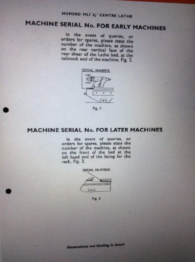

            That is a Myford ML7 i believe. It has the reversing switch . It does not have a quick change gearbox.
            Those numbers do not come up with anything. See link to myford serial No site. The number you need is usually on the front left of the main bed below the chuck. Or on older machines it is at the the rear right on the bed. Below the tail stock. They fetch strong money for a good one. Look on ebay there are many for sale. Some ask stupid money / But you should get over £1000 . Especially if it has extras with it.

                The lathe is Myford ML7. The number you have quoted is not the lathe serial number but probably the motor number which was not necessarily supplied with the lathe when new. The lathe number is stamped on the back of the bed on the right hand side ( behind the tail stock in your picture). All you could ever need to know, including a guide to the age of the lathe from the serial number is available at this link **LINK**

                                              You are presenting electric motor serial number and other data, not lathe serial number.
                                              They are not related.
                                              You will find your lathe serial number stamped on the far right vertical surface of the bed.
                                              Look on those 2 nice long shiny flat surfaces, and then look in far right corner of the lathe on vertical surface 1/2 inch wide and perpendicular to this nice, flat shiny one.
                                              That is where lathe serial number is going to be stamped.
                                              It will begin with letter K followed usually by 5 or 6 digits.

                                              #511482
                                              Maurice Taylor
                                                @mauricetaylor82093
                                                Serial number
                                                Hi ,hope this helps with serial number location
                                                Maurice
