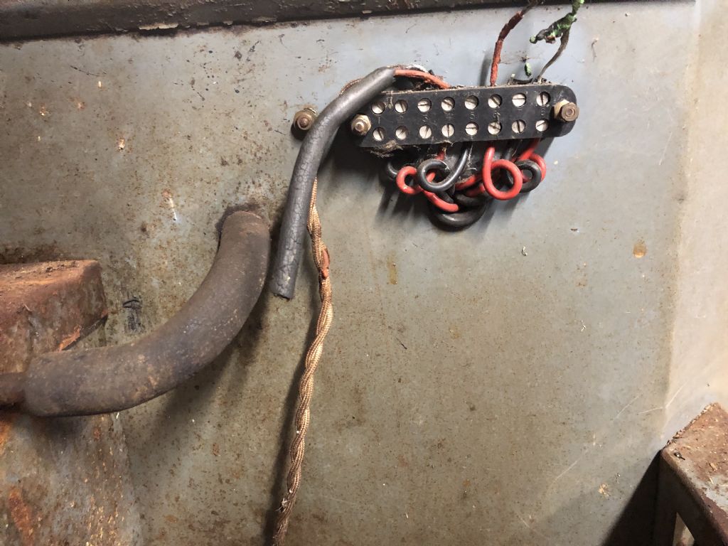

          #399409
          simon staddon 1
            @simonstaddon1
            Hi
            I bought a myford ml7 from a friends dad, but when he moved it he cut all the cables, does anyone have a photo of how to wire this one up?
            Simon
