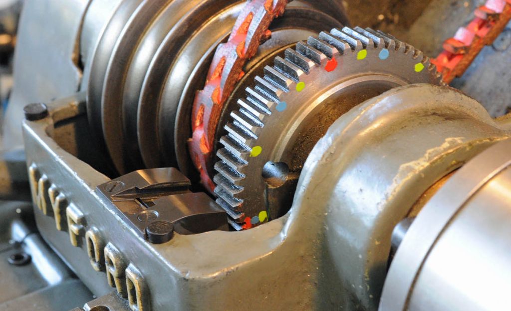

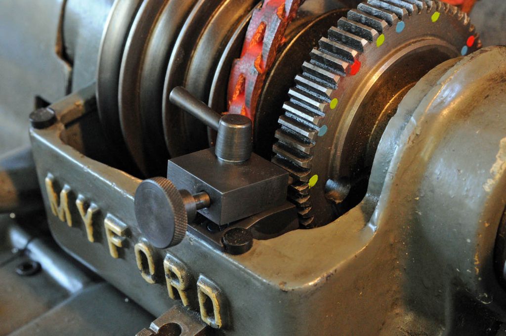

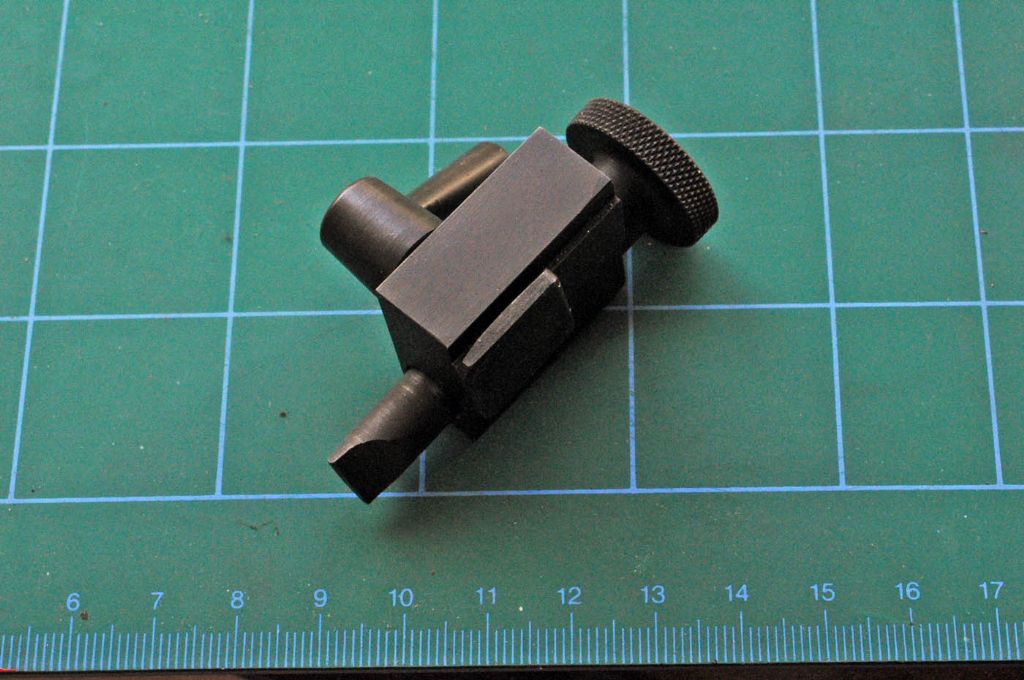

        My toolpost mill is very convenient to mount and I have been considering a similarly quick and convenient way to do simple indexing rather than mount my GHT HDA. This solution is based on Harold Hall's design **LINK** except I have made the base a permanent feature, that still allows the headstock cover to shut on to the buffers. The indexer slides onto a T slot and is secured by half a turn of the locking lever.
        The detent spring is pretty strong, hence the big knob. The traditional coloured dots are for 4, 6 and 10 divisions.

          That's cute, neat and well executed.
          Nice job!

                          I like the design and the neat way it it fitted, but I'm fascinated as to why you went to the trouble given that the VDH, which you already have, is fitted in under a minute which OK may be a few seconds longer than your bull wheel job but not much. Is the the extra time taken to wind the handle on the VDH when you only want to mill a square or drill holes on a PCD the consideration.
                          Even so I'm impressed with you going the extra distance. Once I can achieve a function with the kit I have it takes the promise of big advantages to persuade me to build more just for the extra finesse.
                          As I say this is certainly not a criticism of what it a very nice attachment just would be interested in your motivation.

                            Hi Martin,
                            Good question!
                            I guess it's because the plates and sector arms etc. are normally on the Timmins head on the mill (and I don't have to wind the the handle 4 x 15 times to mill a square)
                            Cheers,
                            Rod
                            Edit OK, 3×15 times
