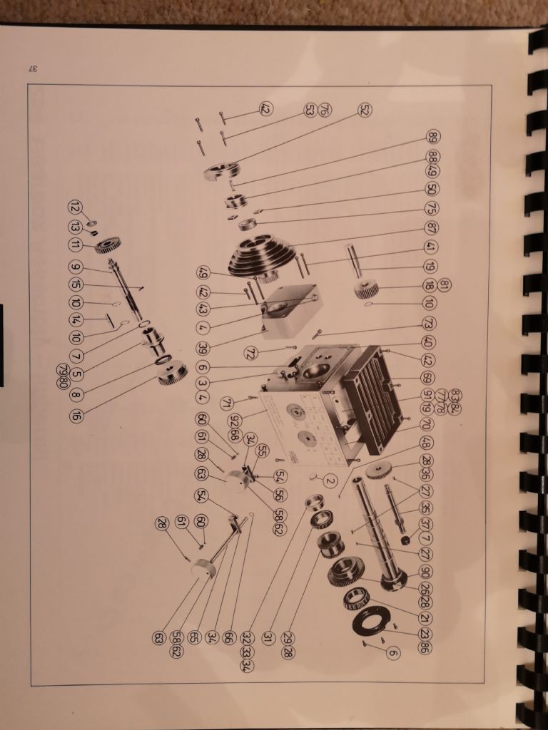

          Have you got a copy of the manual? I have a 254 V plus and a manual. It doesn't tell you how to dismantle it but there are useful exploded diagrams. Let me know if you want scans of relevant pages.

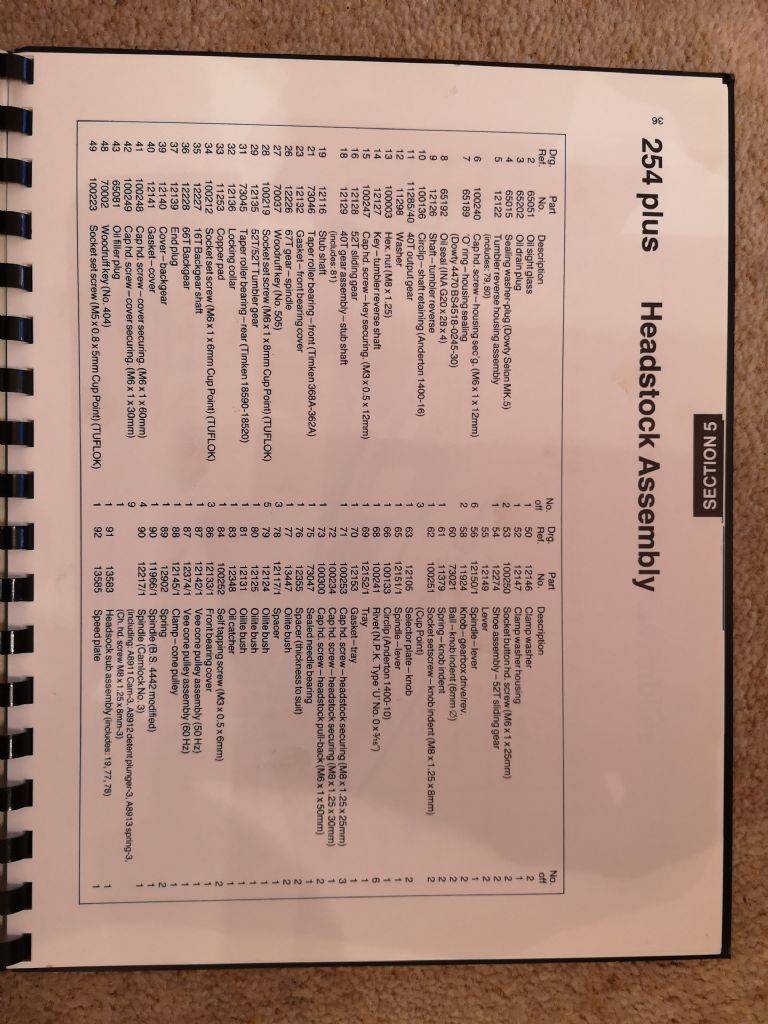

              Thanks for the reply Ian. I have a Myford manual for the lathe but it has no exploded diagram for the V Plus. If you have a diagram for this model it will help a lot. What is the procedure to get a print to me?.
              #459173
              IanH
                @ianh
                img_20200323_184050.jpgI have uploaded photos of the headstock assy and the associated parts list to my album on here. Looking on my phone it looks reasonably clear. I could email images to you if you give me an email address.

                        Ian. Again I thank you for your reply. The drawings you included are in fact the same ones as I have in the Myford manual are infact the ones for the 254 plus and not the V plus. The difference is the belt drive from the motor. The 254 plus is a single V belt and the V plus is a poly-v- belt. I have infact managed to strip the head stock and found the 2 main gear wooddruff keys are loose in the spindle. Intend to make new ones out of a cap headed bolt.
                        I am thinking that Myford didn't upgrade the maual. Again many thanks.
