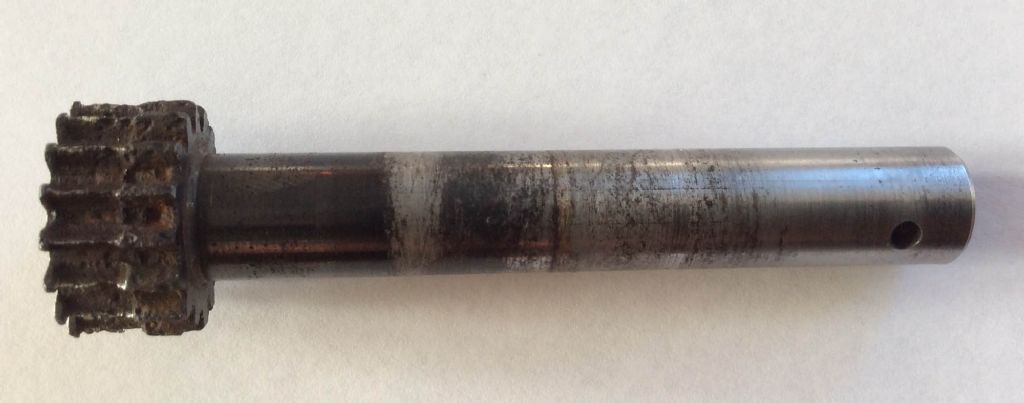

      Hello,
      I've been lurking around this forum for some time, and now have a problem that members here may be able to help me with.
      After running the saddle into the stop, the clutch did not stop a pin being sheared in the feed drive gear train in the apron.
      After stripping it down I found some of the gears were badly corroded. Bought replacements from Myford except for one gear, the hand wheel pinion, no stock. The pinion is badly worn and impossible to measure accurately
      It has 16 teeth.
      Gear is about .998” or 24.4mm diameter
      Width of gear .515” or 13mm
      Length of shaft including gear 3.900” or 99mm
      Diameter .550” or 14mm
      It meshes with the larger gear on the Rack Pinion Assembly.
      I am told by Myford the gears have a pressure angle of 14.5°, and are normally 20DP.
      The large gear on the Rack & Pinion Assembly appears to be 18DP As the O.D. for DP 18 is close to what the gear measures, 2.766” Diameter. At 20DP is come out at 2.500”
      Never needed to make any gears in the past so used Google to try and understand how gears are measured, hopefully I have got this correct.
      This is what I have worked out.
      48 Teeth and 2.766” diameter
      Measure across 5 teeth is 0.771”
      Measure across 4 teeth is 0.610”
      So is the pitch 0.161”?
      For 18DP Gear I get these results.
      PCD. Teeth Divided by DP = 2.666” For 20DP 2.400”
      OD. Teeth +2 Divided by DP = 2.777” For 20 DP 2.500”
      Module. 25.4 Divided by DP So 25.4 divided by 18 = 1.41 For 20DP 1.27
      No of Teeth PCD x DP So 2.666” x DP18 = 47.98 For 20DP 48
      This leads me to believe that the DP is 18.
      Therefore I need to find a 16 tooth 18DP Spur Gear either on a shaft, or a gear that can be pinned to a new shaft.
      I’ve looked at HPC Gears, they do pinion gears on shafts but not one long enough.
      Contacted **LINK** but not yet had a reply.
      Anyone able to suggest where I can obtain a suitable part or get one made?
      Thanks

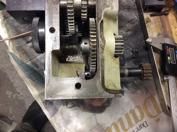

      Photo 2
      Shows where the gear locates, it’s not pushed all the way in it sits under the larger gear at about 4 o’clock.

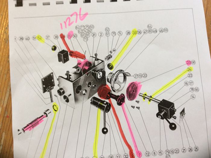

      All the four gears at the top of the apron are new, unfortunately Myford no longer stock the pinion with the small gear.
      Photo 3
      Pinion is part number 45 in the diagram.

            Your are correct in your calculations.
            It has 16 teeth.
            So round that gear up to 1.000 as 2 thou on OD is neither here or there.
            Add 2 to the number of teeth so 18 /1 = 18 DP.
            Problem with HPC is they only do 20 degrees PA
            One choice, if they do them is a gear off a Boxford@ 18 teeth as these are also 14.5 degrees PA.
