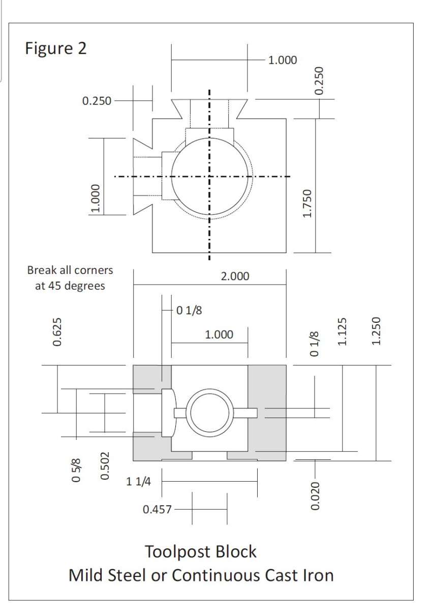

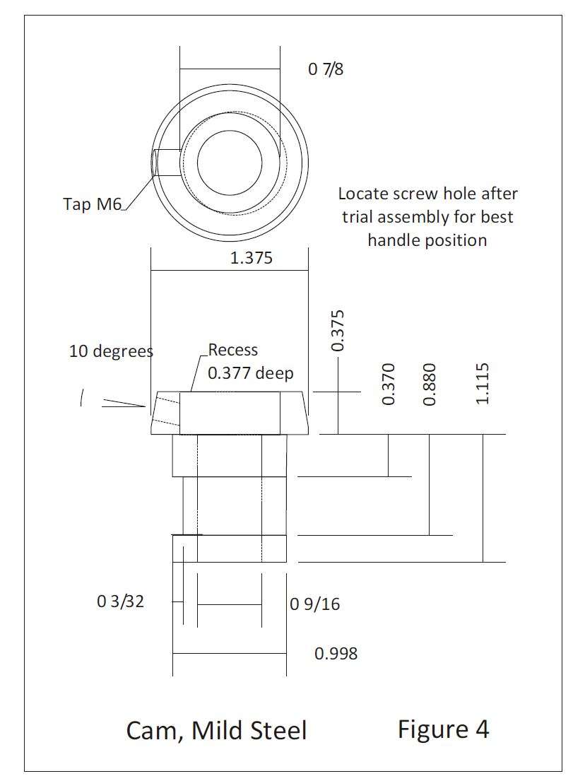

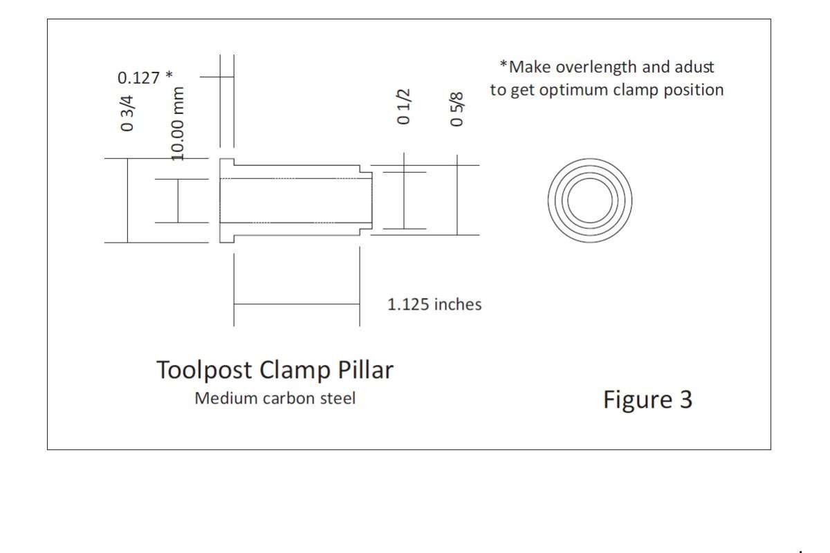

          I am following Neils design for a quick change tP . But its smaller and for a pultra lathe. Ive been following the drawings but  im not quite following a few things . Ive changed some sizes but looking at the drawings of the cam ,first ,the drawings show a hole going through it of 9/16″ but the pillar has a diameter of 5/8″ howdoes that work?
          Secondly the cam again shows a recessat the top of 0.377″ deep and the top collar at 0.375″.Now in the description that goes with the plans the section on the cam states firstly that the thickness of the top flange should be 2 thou greater than the depth of the recess but a fewlines late it says the opposite. Which is correct?
          Thirdly , on the side viewof the tool block the hole through the bottom isstated at 0.457″ but the bottom of the clampingpillar  states 5/8″ ,am i misunderstanding how this toolpost works or are these errorson the drawings.
          Thanks tp3tp2tp1errors?

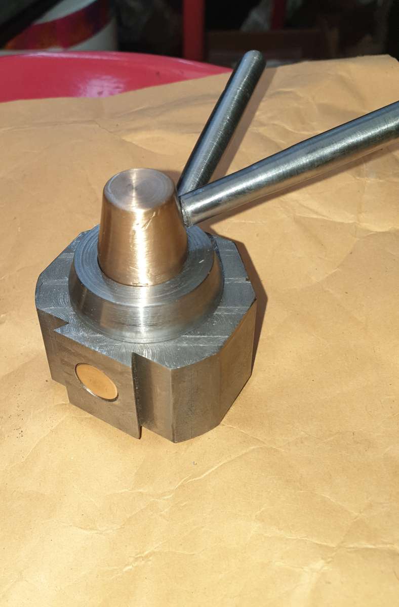

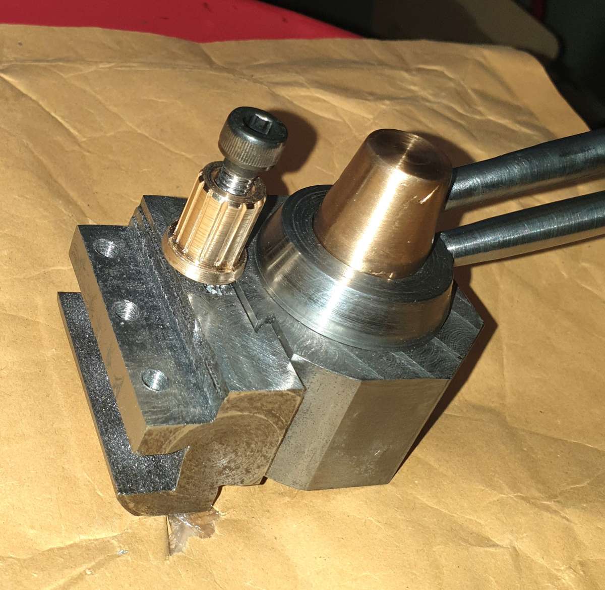

                #759134
                mark smith 20
                  @marksmith20
                  Well as there was no replies to the measurements errors  above i went ahead and made one for my little pultra, it actually works very well and is solid .Due to the not very heavy stuff i work on i made the holder to go below the compound slide to enable diffferent size toolbits to be used at centre height . The holder is made from en8 scrap round bar i had lying around , piston is bronze. The tool holder isvery rough and i broke a tap in it. But this was just a prototype holder to test it would work. The main block is around 40 mm square by about 35mm high.
