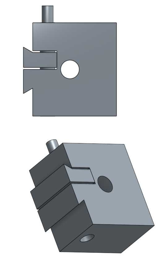

      As expressed in another thread, I'm fed up with the aluminium QCTP I got for my SPG0618A. (Real Bull 7×14).
      It's a piston type and deforms easily.
      So I'm planning to build my own. I've had an idea for how it should work, but there could be any number of reasons why it's a poor idea. I'm hoping that the collective can expose them to me before I start making swarf!
      The toolpost base on the topslide is 50mm square with an M10 thread. Standard stuff,.
      The basic idea is to have the dovetails pull in to the toolpost not push out. In the image below the tool would be pointing downwards. The rod at the top, would be threaded with a nut on it pulling the moving dovetail up. I'd put a pin through the moving dovetail and bar.
      I'd make the bar and the bore a tight fit to restrict the movement of the dovetail to lateral only.
      Toolholders would be the same shape as the current piston based ones albeit steel and perhaps slightly different dimensions.
      My concern is the rigidity given that there is quite a small volume of metal between the central bore and the trough for the moving dovetail. An option would be to bolt plates top and bottom.
      I'd clearly need two dovetails so that both turning and boring tools can be supported
      Any views would be welcome!

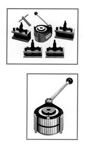

          euro-style-40-pos-toolpost.jpgMy advise would be to forget dovetails altogether, adjustable or not, and look at an Aloris ring/pin style toolpost. They are best in my industrial experience. Jpeg of this style from a Far East tool supply website is shown.

            I would be hugely inclined to bend it rather than slide it to get the grip. That looks a bit wobbly. OTOH, what do I know laugh

              I would drill and ream holes for 2 dowel pins and make them what locates the dovetail.
              I wouldn't massively worry about the material between the hole and the dovetail, I don't think too much force would transfer through it.
              Not sure if the general concept is better or worse than the usual methods of toolpost design. I guess if you can't make cams too easily it makes sense though.

                  I don't recommend dovetails in general because they are fundamentally flawed for tool holding – they do not fully restrict all 6 degrees of freedom of the tool, they are bulky, and are more work to make than simpler designs for no real benefit. However, they are traditional and conventional, which a lot of people seem to gravitate to. I suggest a few minutes study with google on jig and fixture design theory, regarding restriction of the degrees of freedom of items for good workholding and good tool design. It may change your way of thinking about many everyday shop operations.
                  Also a google of "principles of kinematic location" is useful. A link to a good article on the subject is below.
                  The Principle of Kinematic Constraint
                  Just food for thought before cutting metal. (A lot of metal, if making dovetails)

                            Jeff. In principle I can see that's a better design, It's beyond my skills and tooling to make, unfortunately.
                            Thor – that's still a push type clamp. The metal in contact is a few mm wide and 20mm or so high. I'm trying to get a system where the contact area is in 10s of mm x 20mm for more rigidity.
                            kinematics.
                            My feeling on this is that if I prevent the sliding dovetail moving away from the centre (with the bar that clamps it), and clamp it to the toolholder dovetail, which in turn pulls it against the toolpost, then I will have removed all degrees of freedom of movement – and provided a good friction surface.
                            It's actually beneficial if the moving dovetail can rotate slightly as it will take up any (inevitable in my case) errors in the dovetail cutting.
                            Pins.
                            IN the top of the top slide is a small hole which is intended to orientate the normal toolpost (it normally contains a spring and an bit of angled rod that sticks up. I'd thought to carefully drill holes for the orientations I wanted and pin this for alignment before clamping the post in place.
                            Iain
