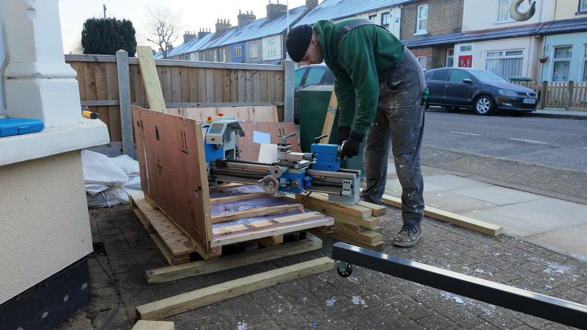

      First I swiveled it around so I could get the crane in place

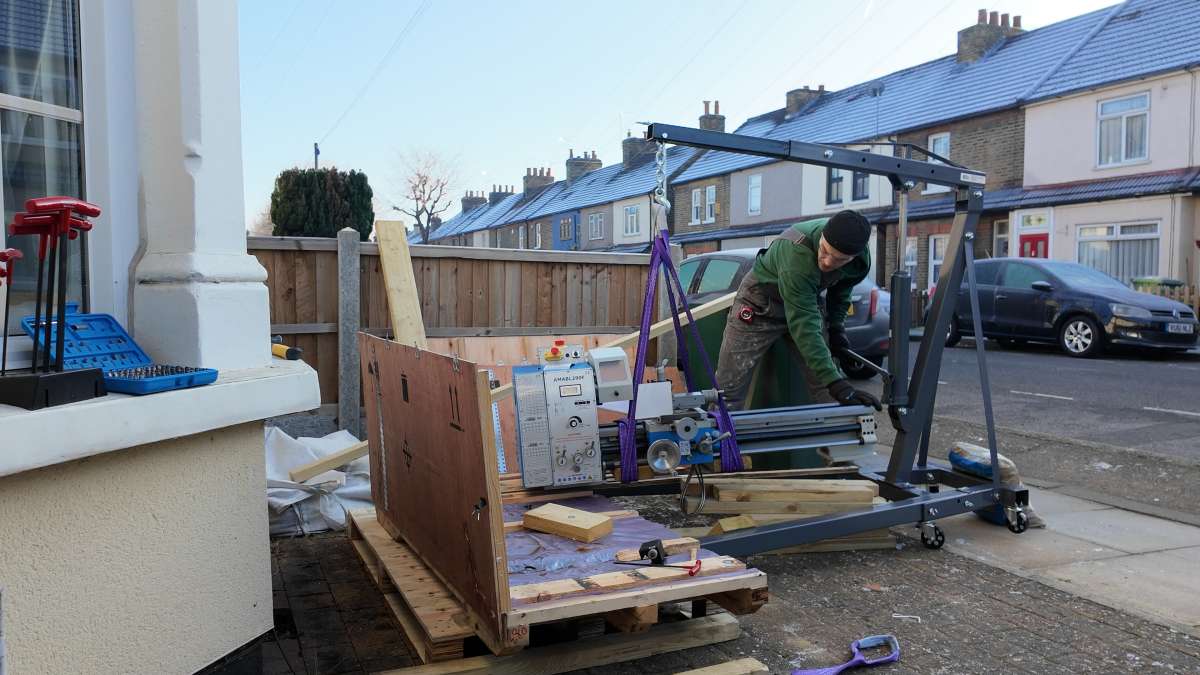

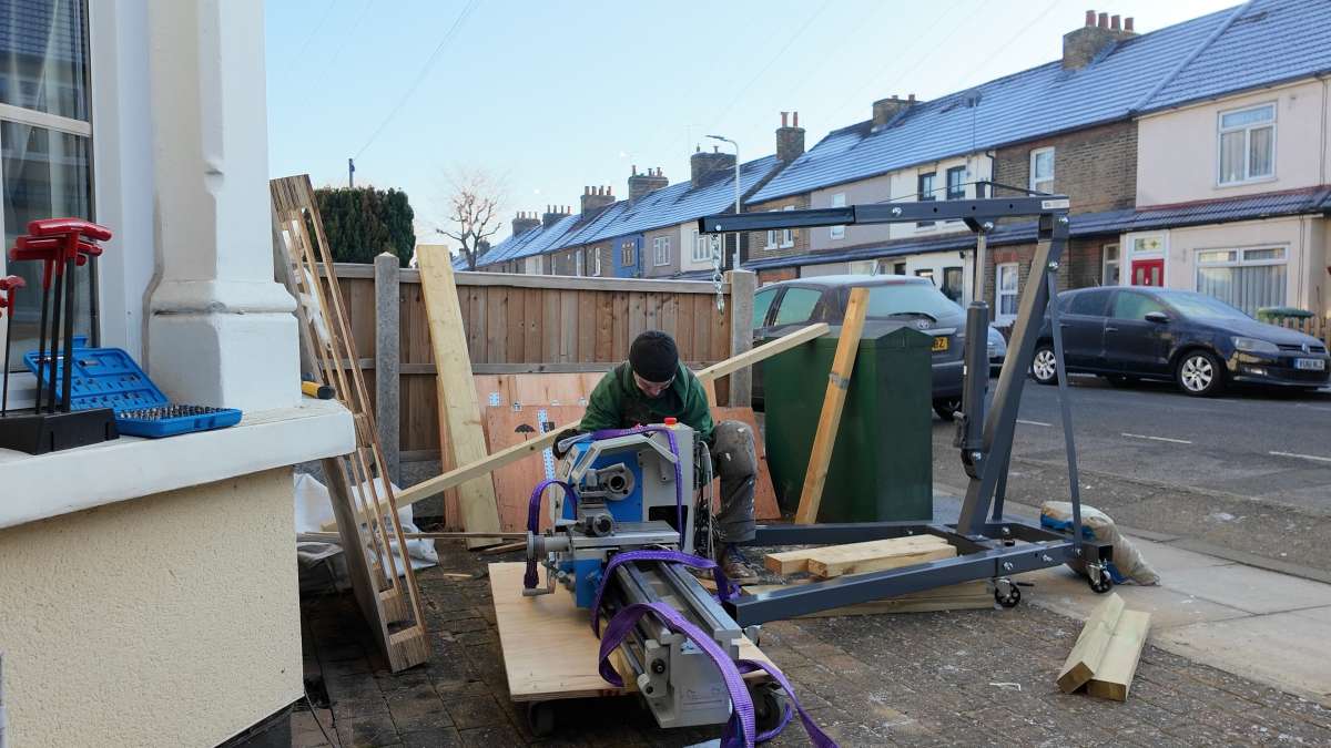

      TThen lifted up and removed pallet and placed on skate

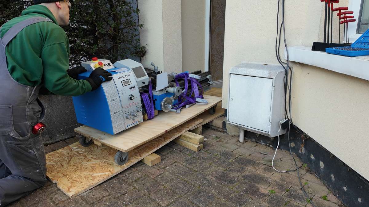

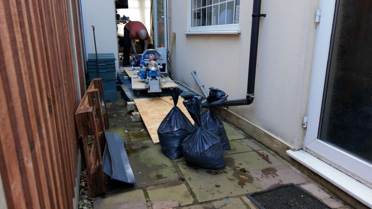

      Im in a terraced house so had to take it through the house
      DJI_20250124132502_0284_D.00_01_29_29.Still004

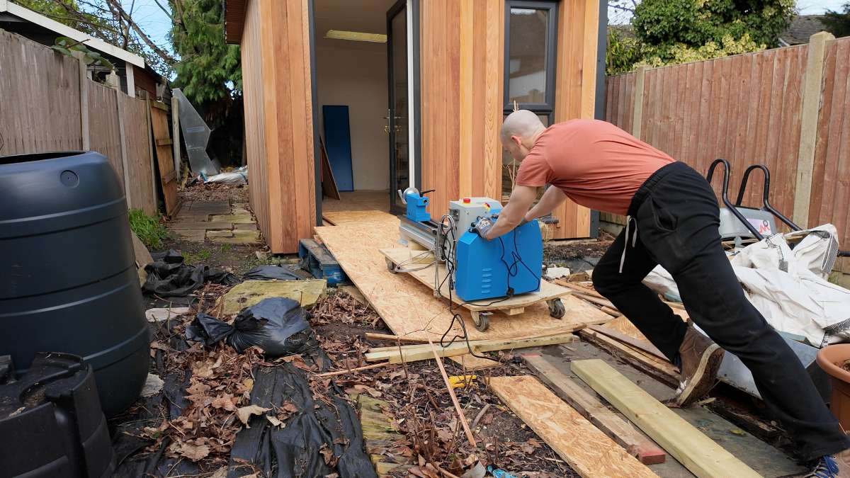

      Using pallets, plywood and some soil bags as crash barriers I was able to move into the garden DJI_20250124132502_0284_D.00_02_05_29.Still005

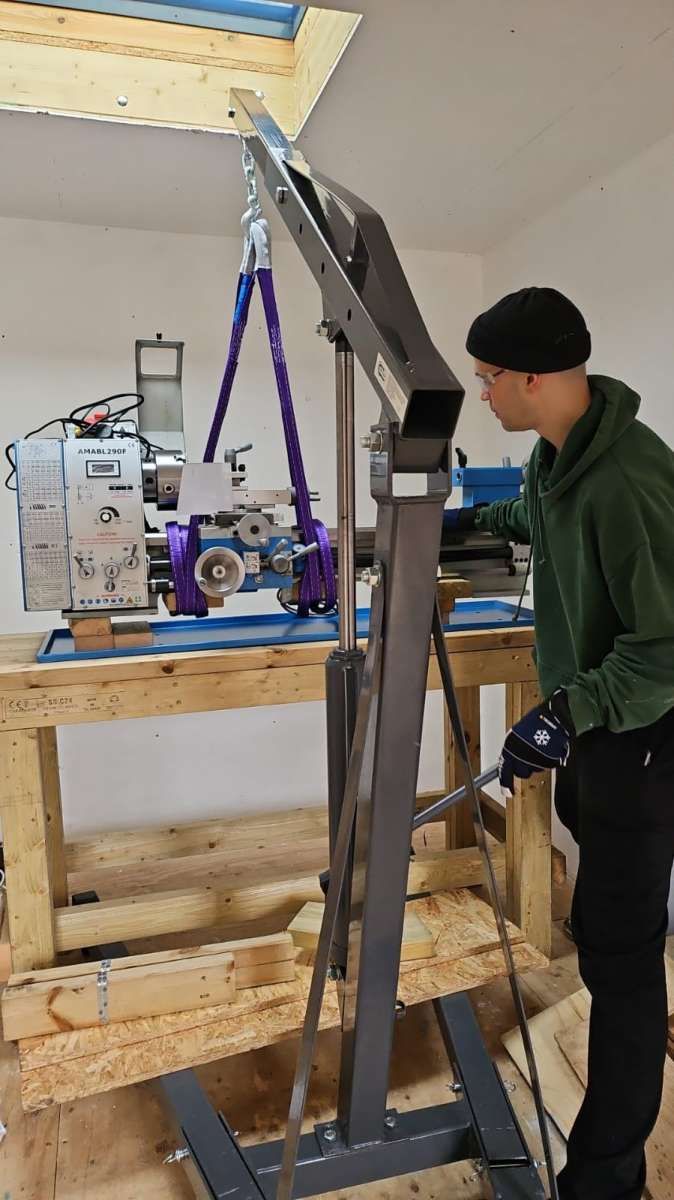

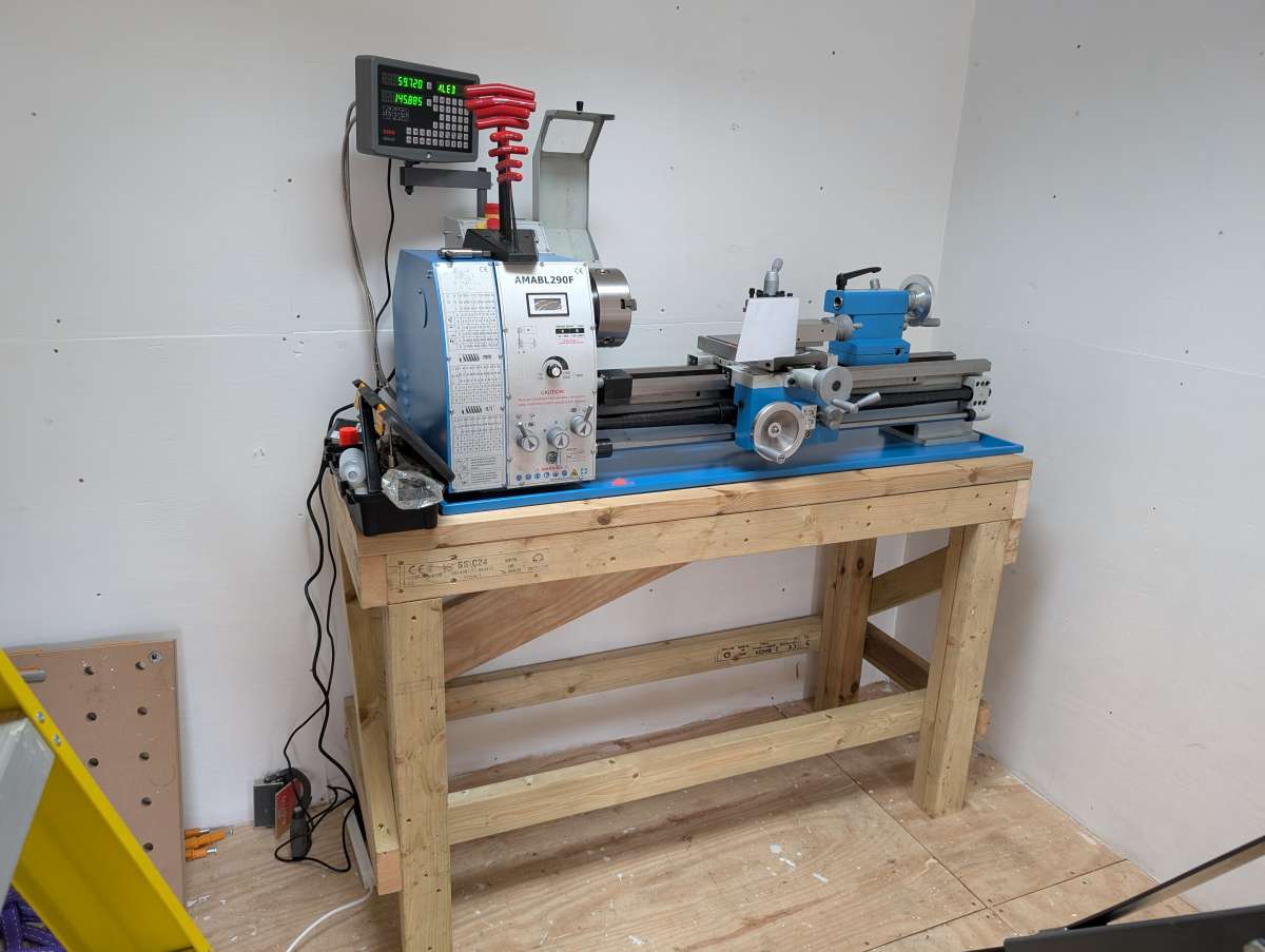

      Hoisting up to the bench, I was at the very limit of the crane to get it onto this bench and luckily I built a skylight in the shed so the arm could reach the full height, if I didn’t have that I would have had to chop the legs shorter on the bench which would have been a pain in the ass! This felt very sketchy, I was worried something would snap and slip at any point. I wouldn’t have liked to lift anything heavier and glad I didn’t get a used old English lathe now because I think this was probably the limit that I could move by myself. I do plan on buying a mill in the future, probably 450kg range but hopefully I can take apart and it will be more manageable

      Hope that helps someone in the same position thinking of buying one

          Nicely done, Sir !
          … and that’s a very classy ‘shed’
