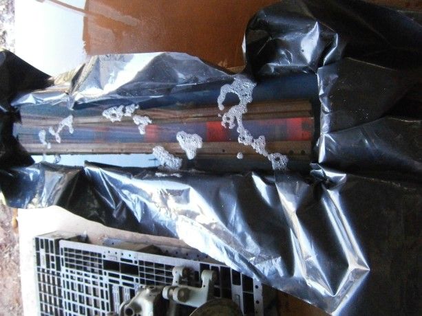

      I made a box up so that I could put the bed in a citric bath, I am a convert to citric acid now.p2230485.jpg

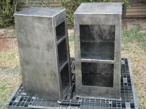

        Now that I am in gaol I have be getting back into my Hercus, before I came home Bunnings and car accessories places had mobs of empty shelves, managed to get the last two tins of spray putty and the last tin of car putty.
        After giving the cabinet and tray a citric bath, went over them with a wire brush on my angle grinder.
        Asked some one to get me a tin of Killrust Etch Primer.

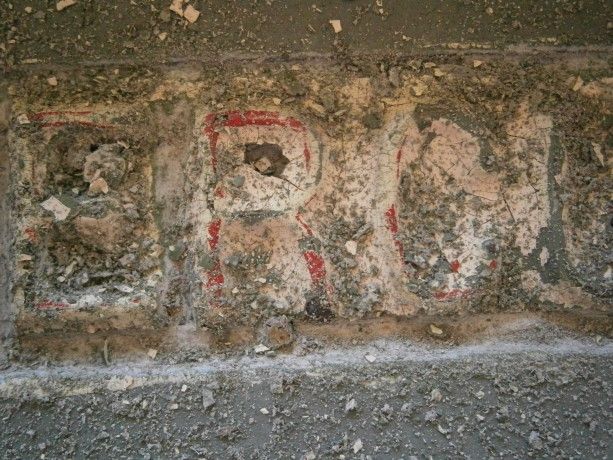

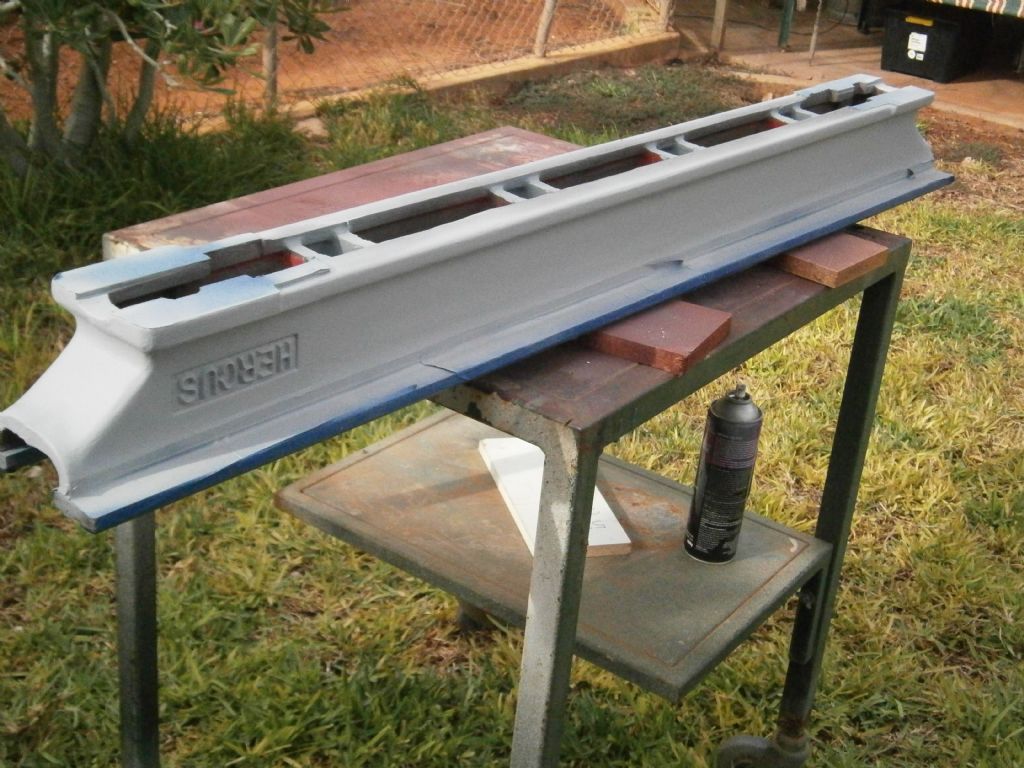

          Had a few attempts with the the car bog never used it before, finally got it right
          There was a few holes in the name so started to scrap it out eventually removed the lot.
          Raped up ready to paint
          Note the name

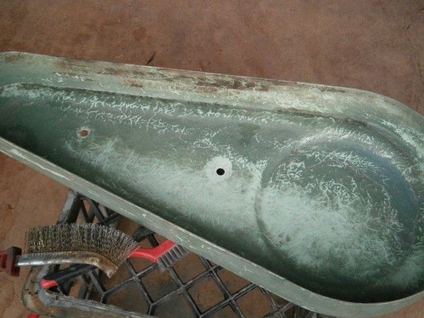

            I have used degreaser and scourer, nylon bush, repeatedly, tried a wire brush but that was to aggressive.
            How would you remove it?
