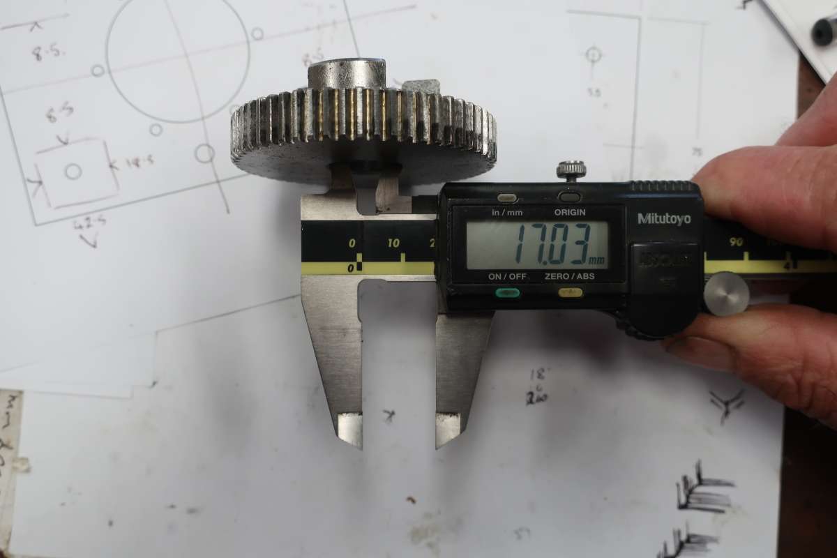

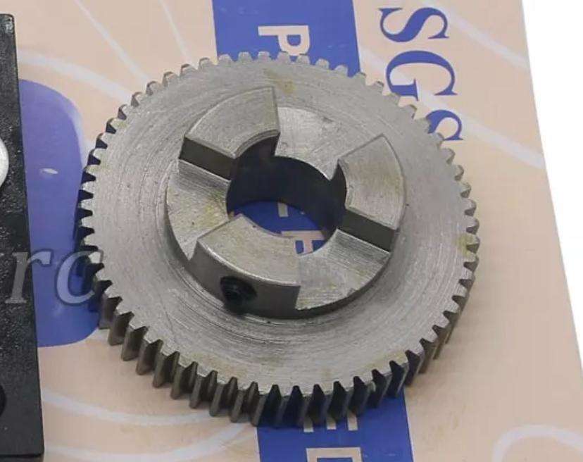

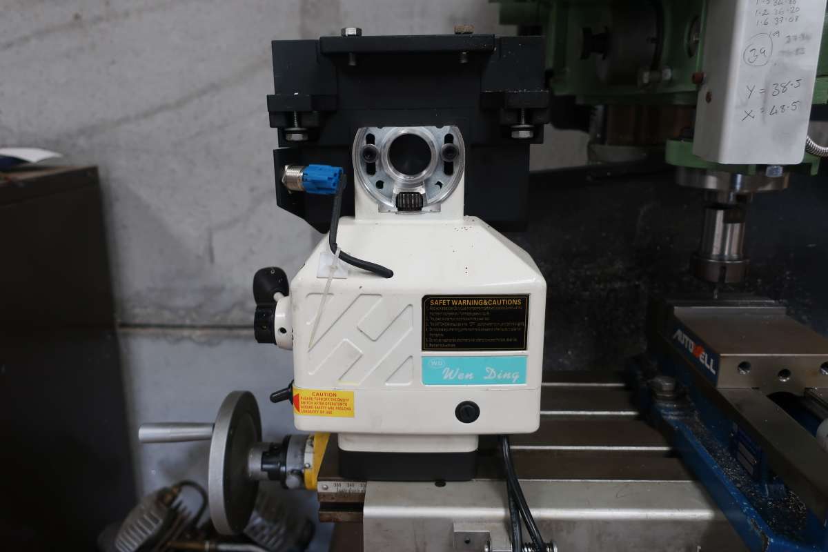

            The steel gear is for a 17mm feedscrew shaft. It should be included in a ‘horizontal’ kit.
            The ‘flexi’ gear is an internal part but a sacrificial/consumable spare hence the listings.

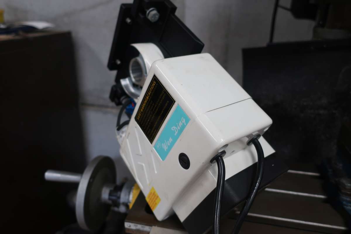

            My unit is branded as ‘Wen Ding’ but they’re all generic (you could probably get your own name put on them if you wished). I will see if I can find the original listing.

              The brand label is ‘Wen Ding’ – the description was “220V Power Feed Milling Machine Al-310S X-Axis Durable Power Torque 450in-lb UK220V” and it was clearly a horizontal model.
              Spur gear was supplied, pretty sure there was a note to this effect because the vertical-mount models use a bevel gear.
              It’s been fine, performance-wise. Good range of /and consistent speeds.
              Taking time / care to set up the gear clearance pays dividends in smoothness and consistency later.

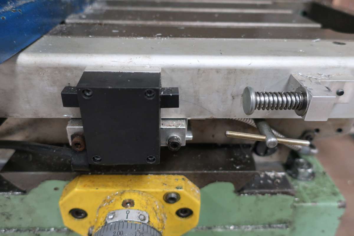

                                          I’d be very surprised if the limit switch was omitted, in the link I gave above the middle photos show fairly clearly two cables exiting the unit on the lower RH side, one is mains power in, other must be limit switches – on mine the switch was already pre-wired / installed on a lead ‘as delivered’.
                                          Agree the rapid-traverse button is also the ‘jog’ function, it’s a momentary switch on mine, so dab to jog / hold to rapid traverse..
