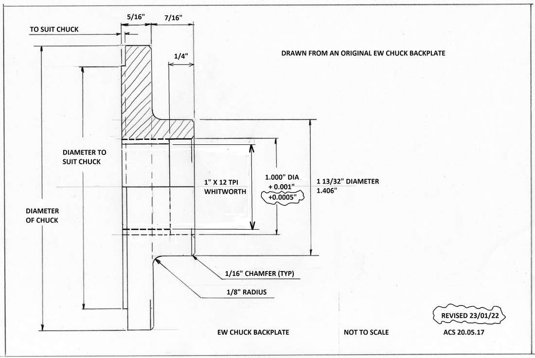

                  #739523
                  IanT
                    @iant
                    This may help James….
                    Courtesy of Alan @ Model Engineering Norge (which is a site any EW owner should check out)
                    Regards,
                    IanT

                      #739642
                      Howard Lewis
                        @howardlewis46836
                        Use thread gauges to check that the thread angle and pitch conform to the drawing above.
                        Not knowing the lathe, guess that it is quite a few years old, and if of British manufacture, would expect the thread form to be Whitworth.
                        Assuming the aim is to produce a backplate , or catch plate to screw onto the sapindle, the most likely option will be to screwcut the thread. Thread depth will be 0.0534″
                        Tracy Tools do not show a 1 x 12 tpi Tap in their ncatalogue (It would take a lot of torque to drive one anyway.
                        You could rough it it out and then finish it with a thread chaser, or a single cutter from a Die Head, (In a  0.8932″ bore there may be enough room for a single single Die Head cutter).
                        You could make a plug gauge to check the internal thread, using the thread on an existing backplate as a gauge to check the thread on your plug gauge, as you make it.
                        The item will be located by the 1.000″ register, so the thread is to pull it into place, so ABSOLUTE precision of the thread is less vital.   Once in place, on the spindle, the final machining of the OD and the face and register for the chuck can then be done to maximise concentricity.
                        Howard

                          #739737
                          James A
                            @jamesalford67616
                            Thank you for the drawing and for the advice and suggestions for checking and cutting the thread. The drawing is escpecialy helpful.

                                  #811763
                                  BB12
                                    @bb12
                                    On Martin of Wick Said:
                                    BTW, Tracy Tools sell a 1″ x 12 whitform tap, but I would not advise attempting to hand tap at that size.
                                    It is not an easy task but I have just finished fabricating a mild steel backplate for a 3-Jaw chuck acquired recently on eBay. I recommend Tracy Tools for prompt service and sound advice, and have been using them since the 1960’s when they were located in Dartmouth.
                                    When I contacted Tracy Tools regarding Whitform taps, having read this Thread, Russell Coates advised me to carry on & use the 1″ x 12 UNF Taps I had purchased from them many years ago but never used!…
                                    I am please to report that the UNF taps were a great success and the new backplate fits perfectly. Obviously one of the most important elements is the turning of the 1″ diameter internal register which ensures the mounted chuck will be concentric to the EW Arbor. Similarly it was necessary to then mount the blank and finish turning the OD, and Raised Face to match the 3-Jaw chuck’s recesses.
                                    My conclusion is that a 1″ x 12 UNF thread is absolutely fine and I am glad I listened to the sound advice received from Russell.
                                    Hope this is of use to EW owners who may like me have felt unsure of how to proceed.
