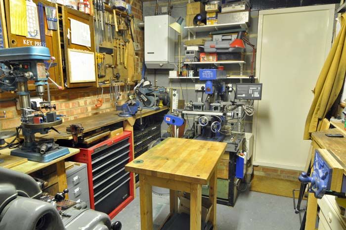

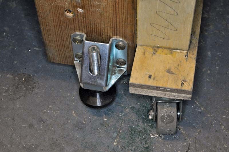

                      I have a bench in the middle of the workshop which I use as a tool table and which can be wheeled close to the lathe or the mill as required. This bench also serves as a woodworking bench which needs to be solid enough to stand some hand planing, in which case I lower the feet:
                      The fact that each foot is lowered individually means that I can get it solidly levelled on the slightly uneven concrete floor. I store some cast iron dumbell weights on a lower shelf which keeps the centre of gravity low.
                      The feet were from Axminster. I have also used these to level my Sharp milling machine on its stand.  (The photo of my unusually tidy workshop was taken before I added the feet to the mill)
