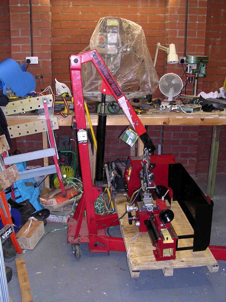

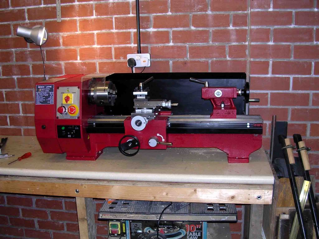

                                                  Steve Withnell
                                                    @stevewithnell34426
                                                    There is one thing you cannot use rollers on – horses. One of the most scary lifts I've been involved with. The vet had it drugged up to the eyeballs and it still managed to kick seven shades out of everything in range.I'll dig out the photo's if I get chance. At least if a machine does go over thats an end to it. They don't keep waking up and trying to kill you. The Vet got close to being a 999 call, he had a bad limp afterwards.
                                                    I have also managed to outrun a flanging machine (think about a Brideport but two foot taller ) when the scaffolding roller got stuck and the whole thing went over.
                                                    Anyway, back to earth, how do you get a hobby lathe out of the crate and onto the bench single handedly?
                                                    Put the straps around the bed at the balance point and just take the weight to check balance and see if the lathe is going to misbehave, if it is re-adjust the straps and test it again…The engine crane is pointed at the target bench…
                                                    Magic happens…as someone said already, never lift higher than you need to. Moving the pallet, you only need the lathe high enough to get the weight off. Keep an idea in mind of where the lathe will be if the crane or straps fail. Stay out of that place.
                                                    That's what the job looks like working on your own. I put the straps around the balance point on the bed because I couldn't bear the argument about putting the straps under the spindle.
                                                    The C6 from memory is about 135Kg.
                                                    Steve
