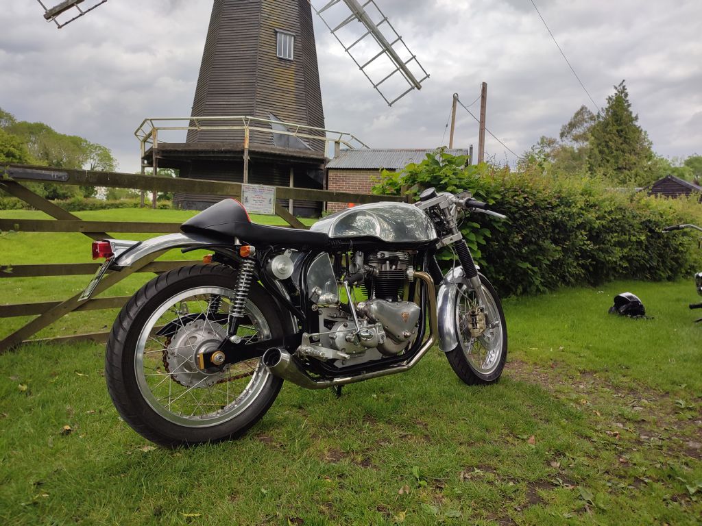

      Hi All
      New member (although I have been looking at the forums as a guest for a while). Thought you might like to see a picture of my Triton I finished last year complete with lots of home made parts.

        Very nice indeed Phil.

          Nice windmill, can’t make out what the sign on the gate says. Is it open to the public?

            Stelling Minnis, Kent
            Usually open on Sundays and Bank Holidays in the summer

              Very nice triton, looks like a big bearing 650, plenty of braking power from twin discs and a custom swinging arm for the slimline Featherbed frame. The windmill is nice, too.

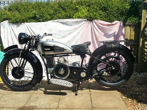

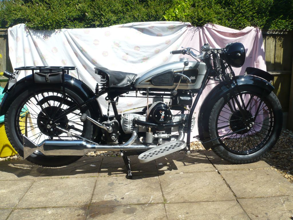

                Hi all,
                It has been a busy few months as previously stated I started work on the Douglas beginning of January and it was completed last week, it ran, a little lumpy so that needs looking at but it was pumping oil around and the generator was charging. I have not ridden on the road yet but everything seems okay, but it's far from original the rivet counters will have a field day, I had a pile of parts which were Douglas and from the 1930's but from different models so it took a bit of working out but I am happy with the way it turned out.
                This is what I bought………………
                Lots of stuff had to be made like wheel spindles, fork spindles and bushes, steering damper, drive sprocket, headlamp is homemade from a Lucas and Miller bits with a Chinese lens thrown in. The rear carrier was also made, the leather tool box were from ebay, all we need now is a V5c from the DVLA.
                Kind regards Colin

                  Congratulations on a wonderful build which must have caused some head scratching at times. I find such 'restorations' much more exciting that those which tend to stick to the original designer's thoughts.

                    Looks good Colin, don't worry about the rivet counters, hope the summer is good.

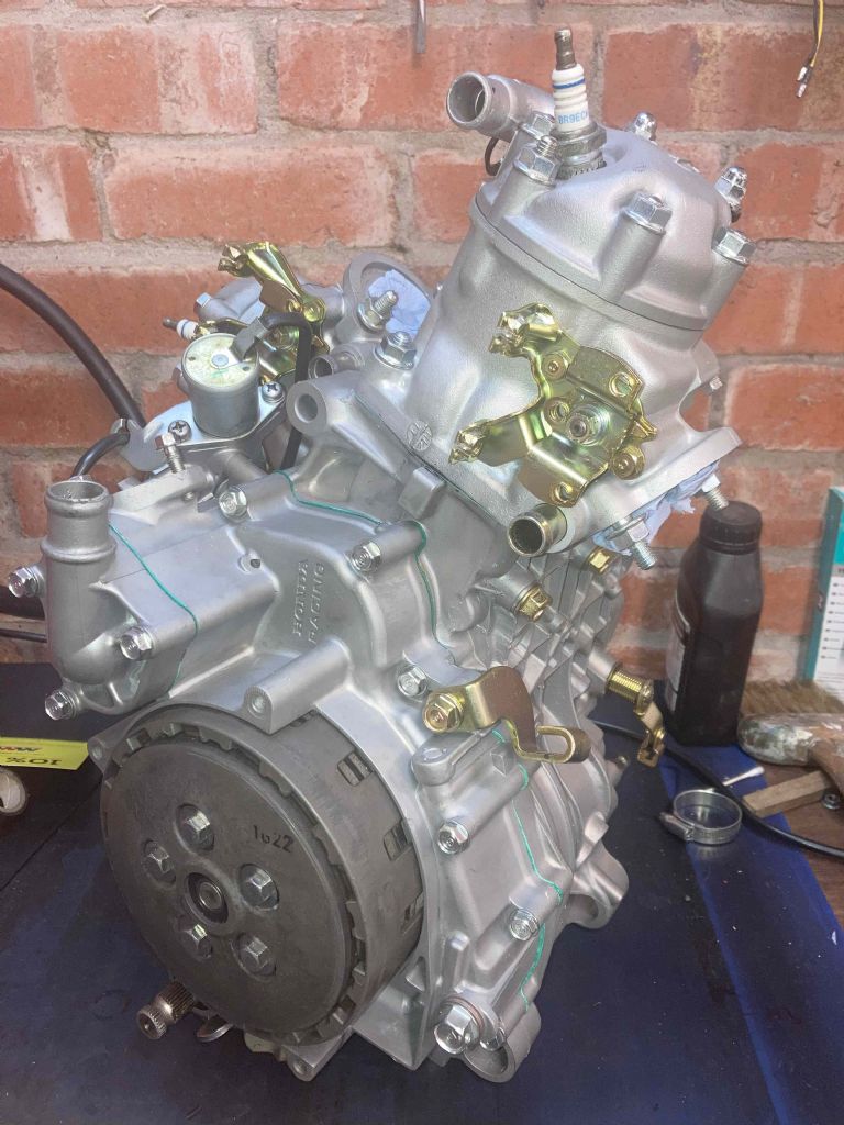

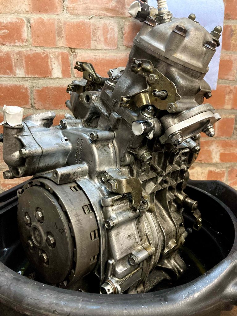

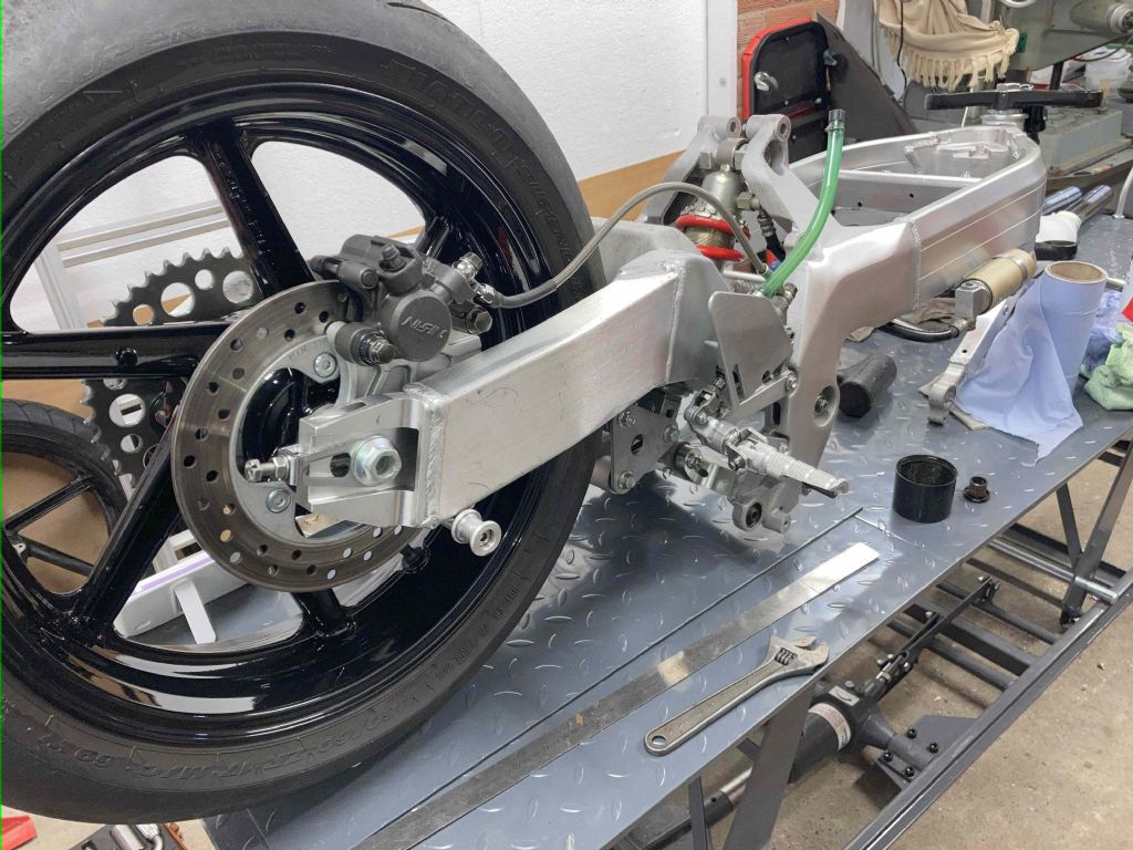

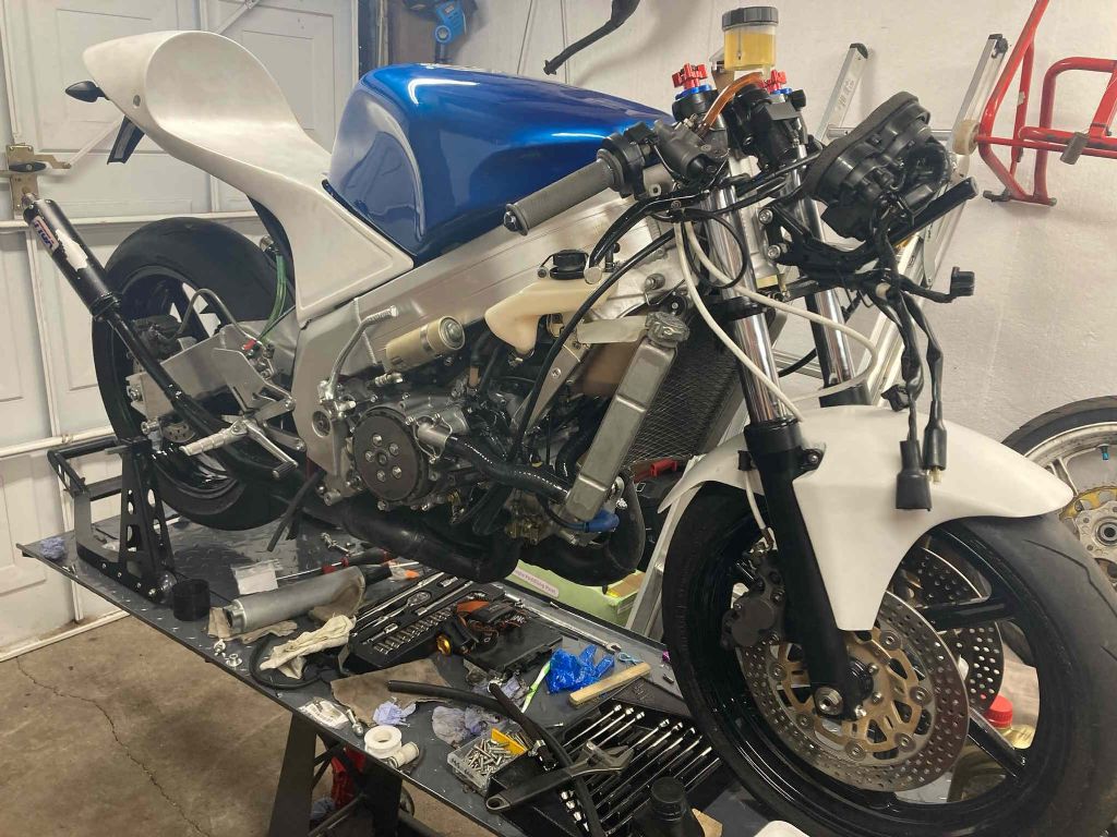

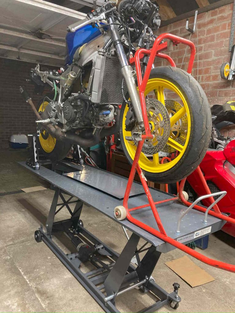

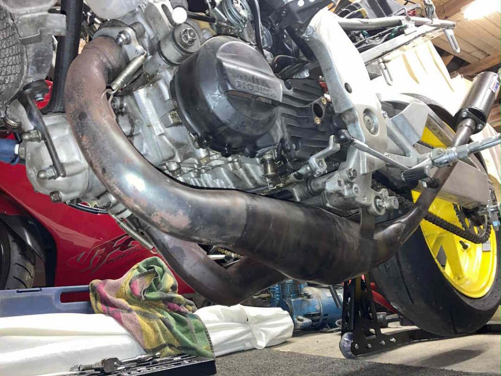

                              Oooooh, I didn't know we had a motorbike page! here's my 2pence worth, although its "only" just over 30 years old, it's nearly as old as me, so to me, its a classic! I'm perhaps a bit younger than your average demographic on here (sorry guys!)
                              It's a Honda NSR 250 (MC21) they only sold them in Japan, but when they had a surplus, some of them went to the Aussies.
                              I acquired it about 3 years ago if I recall correct. It was a race bike in pretty poor condition but it sounded great. Under the microscope however, the crank bearings had more float than anything I've ever seen, the wiring loom had several bare wires, vital bits were missing out of the carbs, needles were worn and loose and it was completely missing the oil pump system and there was a patch on one of the aluminium cylinders (the front/lower) that was missing the nicasil plating – I'm sure I found many other things that weren't right but they all just got picked up along the way.
                              It's built from new parts, pretty much all genuine honda apart from the odd bearing/seal which were NLA. New crank, rods, pistons, rings, cylinder plating, all bearings, seals etc etc. I rebuilt the carbs, sourced and reinstated the oil pump system so it was no longer on premix, rectified some issues with the electronics, had all the nuts/bolts/washers from the engine and chassis replated (3 batches, yellow/gold, bright zinc and black) rebuilt the front forks, powdercoated the wheels, restored the frame and swingarm etc etc etc. All cases stripped and vapour blasted, some holes repaired from a snapped chain etc.
                              I've been riding it for the past 18 months (with fairings and lights of course!) as my daily (summer) bike for commuting and pleasure and it's been great….. but I'm making a few changes, getting rid of the modern aftermarket subframe and seat unit and going back to the standard subframe and undertray/rearlight with an aftermarket GRP race seat unit – nothing wrong with the modern alloy subrame and skinny seat, I thought it might be a bit uncomfortable on my wrists but it's actually fine – I just prefer the original style GP seat units of that era.
