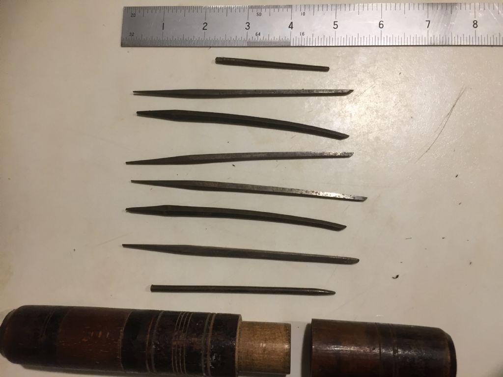

      Having a tidy up I came across a mysterious wooden tube containing eight tools:
      The one at the top appears to be a miniature tapered reamer (which makes me wonder about clock-making), the next six have what look like hand forged square section tangs and the bottom one has a slightly mushroomed head which makes me think it might be a tiny chisel.
      No idea where these came from – anyone recognise them?
      Robin.

          Quite probably engraving tools, Robin
          http://expositions.bnf.fr/bosse/grand/214.htm
          Image located via Wikipedia

            Robin,
            As Michael G says these look very much like gravers, they are missing their mushroom shaped wooden handles.
            Essentially they are a metal cutting chisel but not struck with a mallet they are driven into the metal by hand pressure alone.
            I used to watch a Sheffield hand engraver at work and marvelled at the strength and control he was able to achieve.
            I still have some of his work which I really ought to photograph and post here.

                Is there a hole in the end of the case to take the shanks?

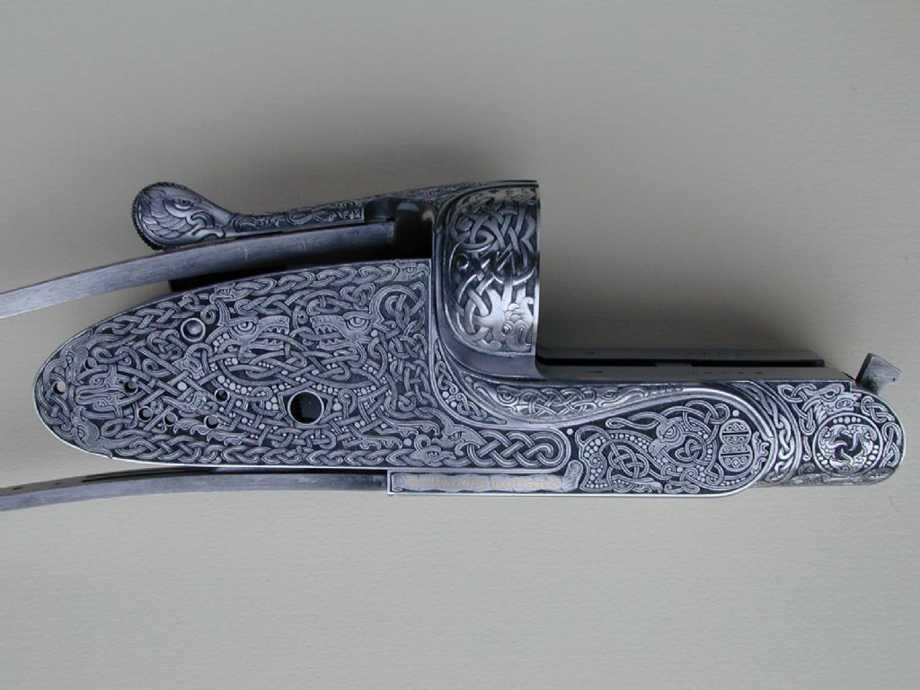

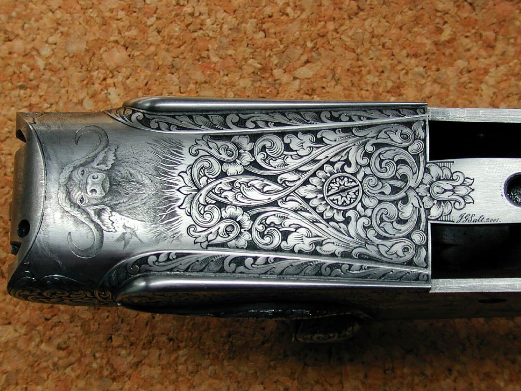

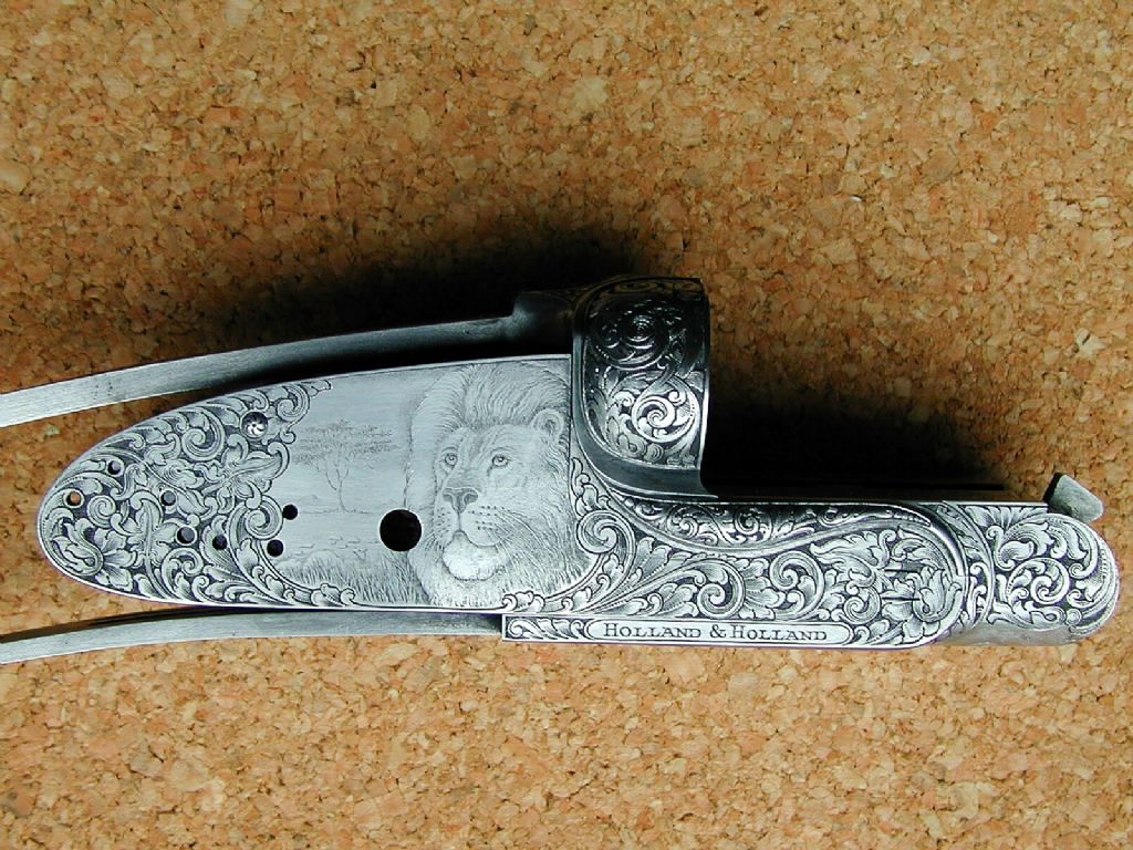

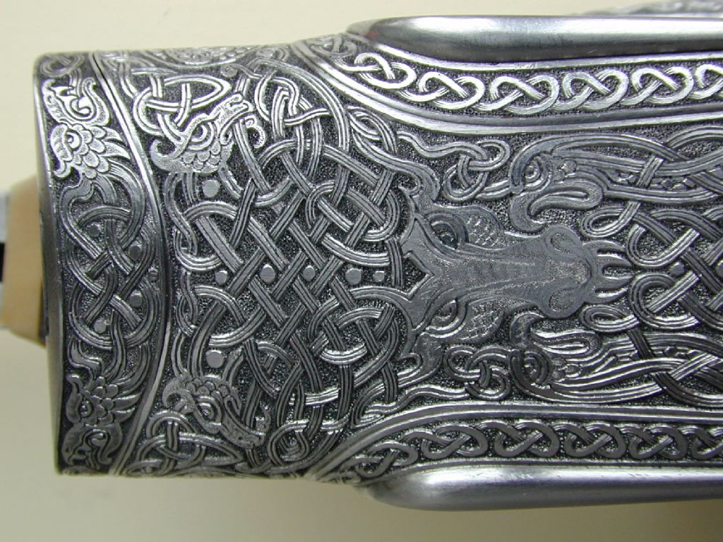

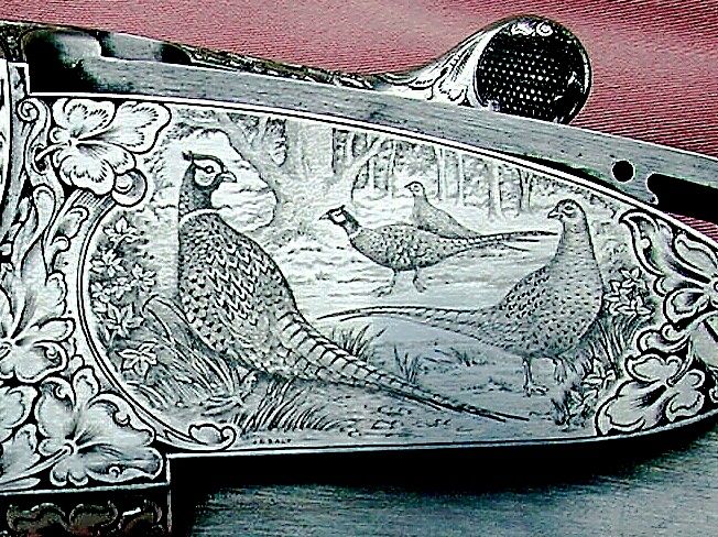

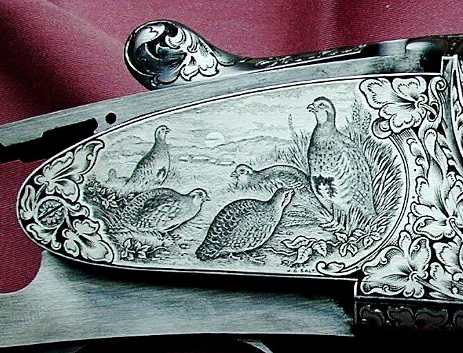

                  A very good friend of mine was a master engraver who used to decorate the expensive guns of the prestigious gun makers. When he finished a gun, which took several months work, I used to photograph them for him. Here are some examples.

                    Wow

                      Wow + 1
                      I've seen it being done, it is a fascinating process – and knowing that one slip could ruin weeks, if not months, of work must be nerve-wracking.

                        Some top notch engraving there, shame it seems to be dying out. The only guy that I know of still doing gun work is Don Blocksidge but apparently he's no spring chicken and never took an apprentice on to continue the skill.

                          My friend's name was John Salt – if you look closely you can see his name in the bottom 2 photos. He died a couple of years ago.
                          He taught me the rudiments of engraving some years ago, but I'm still very much a novice.

                            Beatiful work by Mr Salt, Gary … and your photos are a fitting tribute.
                            Thanks for sharing them.

                              Remarkable craftsmanship.

                                Real works of art, a pleasure to view. Interesting that the engraver has been thoughtful enough to depict your target just in case all that crusted port and vintage cognac has clouded your memory.

                                  Factorial Wow!

                                    SO sad that such skills are dying out with such craftsmen.
                                    With the increasing rarity, it no wonder that examples are becoming astronomically expensive.

                                      Gary, the bottom three pictures are signed, you missed one.

                                        They are used for turning arbors and pivots for watch and clock making,I have some in the same wooden tube and use them occasionaly when turning thin items.
                                        Frank

                                          I am happy to be wrong, and learn something new, Frank … but :
                                          I have never seen curved gravers being used in an horologist's lathe.

                                            Both suggestions seem possible but.
                                            They look a bit slim as graving tools and the ones I have seen (and used / played with) were quite a bit shorter with a bend right at the end to angle the cut near parallel to the work. The long curve also fits with the idea of producing a cutting force almost parallel with the work face, It is a very scary business. I couldn't stand the tension; I'm clearly not of the right stuff.
                                            I have seen YouTube videos of turning clock arbors and it involved a technique more like wood turning; Hand held with a rest. Those tools could possibly be used for that too.

                                              It's interesting and rather awe-inspiring to see that the decorative work of many otherwise functional items made now, still often uses motifs developed hundreds or even thousands of years ago, as the second of Gary Wooding's photographs show by all that Celtic knot-work.

                                                That's why I posted this link, Andrew:
                                                **LINK**

                                                    Thanks for replies.
                                                    AdrianR – no hole in the end of the case for the shanks, it's just a rather nicely turned tube.
                                                    Consensus is that they are hand engraving tools. I had a scratch at them with my hardness testing files, probably not that accurate but somewhere between 60 and 65 HRC at the business ends, 40-45 at the tangs, so presumably made with some care. I'll make mushroom handles and have a play.
                                                    Wow^(Aleph_null) on the gun decorations – amazing, thanks for posting those pics Gary.
