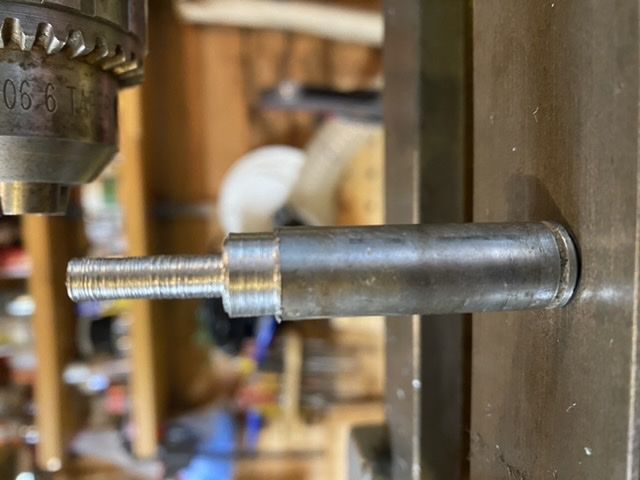

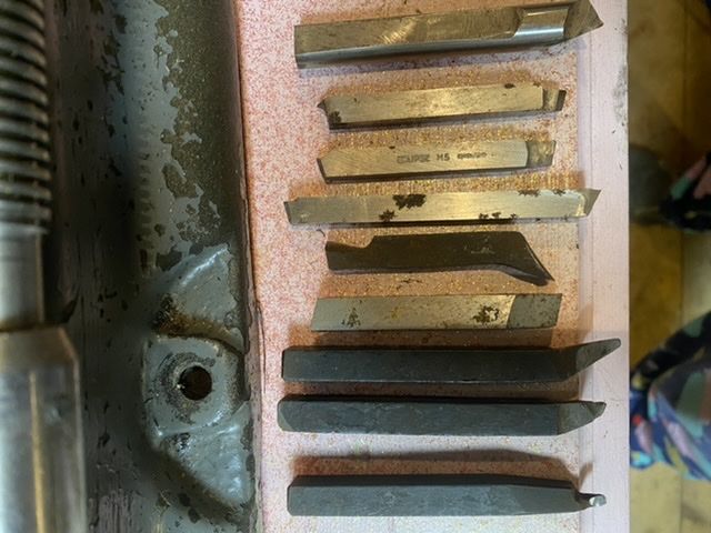

      06f034db-1788-404b-9312-b28873b9a1cb.jpegce3e1ade-019a-4c57-981c-ad9695940e36.jpegHi everyone,
      a couple of things I need help if that’s ok.
      in one pic you can see the tools I got with the machine, are they ok or should I buy some new one, also what’s the round one for.
      another pic shows the first bit of turning I’ve done since school, along time ago.
      it looks very rough to say the least, is it the tool I used or me or maybe the metal.
      it not very good at all.

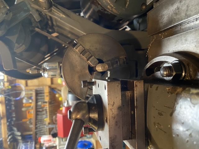

      the other pic shows the tool towards the metal bar I was turning, if you can see it, my question is, the tool seems to be very low of the turning piece, should the tool be basically level with the centre of the piece your turning.

          Yes the tool should be exactly on centre
          easiest way is to trap a strip of metal about 6” long between tool and work. It should be vertical Use strips of flat, shim or even cut up tin cans to bring it up to height. I
          it looks very low opin your photo

            I agree with the centre height comment above but a few other points (I would say that your photo angle is tricky to see how far below your tool point is);
            The metal you have used looks like a component rather than a new piece of bar (I'm looking at the recess at the other end). Perhaps you are trying to turn something that is quite rough and or hard? A fresh piece of known bar might help.
            Are you aware of the correct speeds and maybe depth of cuts – or are these your next questions?
              The material they are made out of will be just fine, but they will need to be sharpened – even if they happen to be sharp now, they won't stay that way for long. Sharpening can be a bit of an intimidating topic to start off with, but watch a few videos and read a few books and then get your hands dirty and it will make sense. A basic bench grinder is all you need – there are usually loads on Gumtree and Facebook Marketplace for not very much.
              Round tools are generally used when you want to be able to fine tune the orientation of the cutting point, such as in a boring bar. Not quite sure what this particular one is ground to do, but people do all sorts of things with HSS cutters.
              It could be a bit of all three. The biggest problem is that the tool does indeed need to be at centre height – one easy way to text this is by almost touching the tooltip and a centre in the tailstock. People will say to be a tiny bit over or under for different applications but the basic principle is it has to be on the centre, or your tool is at the wrong angle to the material it's cutting. Your tool there is quite low so the material itself is trying to "climb" over the tool – that's why the finish is worst at the tip, where it's most slender.
              The tool could be not-sharp, and your tool-holding might not be rigid – everything has to be tight all the way from the tool-tip down into the carriage, through the bed and back into the headstock. And the metal you are cutting might not be ideal, though it looks like you've chewed it up pretty well! In general though having material of a known standard and thus properties means you have one less thing to second-guess.

                  It's difficult to see, but it looks from the first picture like you're using a slotting/parting tool on it's side? This would explain the poor finish and low tool height.

                      Looking at your selection, the tools all seem still serviceable, perhaps with some judicious re-grinding.
                      The shiny ones are of High-Speed Steel (HSS).
                      It's not entirely clear to me if some are lying on their sides; so the clearance angle, if that is what it is, on the fourth down is a bit large but that should not matter. For steel and phosphor-bronze, the top of the tool should slope 2-3º or slightly more, diagonally down away from the very cutting-corner. Aluminium – the slightly more. Brass – flat (0º ), giving more scraping than shearing. In all, the flank and front face below the cutting-edge is angled back below itself for clearance.
                      The top one was perhaps of special purpose, and being round bar, unless there is a flat along its underside it needs to be held in a shallow V-groove pad or a clamp-block, in the tool-post . It might cut neat chamfers.
                      The dark ones: high-carbon steel (like cold-chisels etc.). Fine, but they will not withstand much heat without losing the temper, spoiling them. That with the long slender "neck" will work into the corner of a wide groove. Next down; a general, and very much used, knife tool for straightforwards turning including facing. No.3's semicircular end may have been for profiling grooves for, e.g., sealing- or oil-retaining rings. Don't try to use it as a parting-tool: it will jam in the cut.
                      The tool in the middle may be another "special". Hard to see its geometry properly but it might turn the right-hand face of wide grooves, cutting towards the tailstock.
                      Height:
                      I usually set my lathe tools by pointing them at a centre or scribing-block, then fine-adjust if an initial facing leaves any centre-pip on the metal.
                      A properly-set tool leaves no pip, but by shaving it down, not shearing the last bit by force (tool too high). If the tool obstinately refuses to remove the pip, it is too low.
                      A tool-post without height adjustment of its own, such as your 4-way one, needs a good assortment of shims for packing the tools to height. Save expensive "shim stock" for its intended use, aligning machine parts. Instead, off-cuts from ordinary strip or sheet metal, including from food tins, etc.
                      Even semi-rigid plastic. Some of my shims are from expired plastic bank or club membership cards – a fairly tough, precisely-finished material, so ideal shim where it won't become hot.
                      Many model-engineers make a simple height-gauge for tool-setting.
                      High-speed steel tools are fine, and have advantages over carbide inserts, not only by being much cheaper. (I use both.). They are relatively easy to sharpen many times to a standard that will give you decent results; and are less fussy than inserts which are really made for quite specific materials and cutting conditions. Some aver insert-tooling can only work at very high speeds, but that is not quite so. They work like that in industry for rapid production at very high repeatability. The HSS tools sometimes give a better finish, especially on steel not of free-cutting grade.
                      [If the work-piece is to be welded, especially for anything critical, it must not be of a free-cutting steel anyway. Their additives, usually lead, embrittle the weld.]
                      Grinding:
                      As Calum says, a simple bench-grinder is fine for HSS tools. In fact it is necessary!. It takes some practice but you can grind a tool free-hand to give good results, even on the crude rest usually fitted to these grinders.
                      A final honing by oil-stone or lapping-plate will help give even better finish, but the finish is mainly dependent on tool geometry, speed, feed and material. The very tip should have at least a tiny radius in plan, even for turning into a shoulder as on your sample.

                          In your picture, the tool is well below centre height. That tool, or any other, will, not cut properly.
                          It MUST be on centre height. Don't go above. The tool will not cut, just rub.
                          If the tool is off centre height, when you face across the end of the bar, it will, leave a pip in the middle.
                          As I said earlier, make yourself a Centre Height Gauge (But fit some more clamping screws into that 4 way toolpost.) Rigidity is important, so clamp the tool securely, and keep tool, overhang as short as possible.
                          If you want to know how, PM me with an E mail address, and I'll send a picture of one or two that I have made, with a few notes.
                          Until then, as said, trap a piece of thin steel between tool and work. If the steel is vertical, the tool tip is on centre height. Ifv it not it will not be vertical If it leans away from you, the tool is too high, towards you it is too low.,.
                          Don't worry about all the different tools, at this stage.
                          Just learn how to grind a plain knife tool and start learning with that. The fewer variations that you have, the better you will learn the effect of any change that you make.
                          One of the first techniques that you need to learn is how to hand feed at a steady and consistent rate.
                          For roughing, you can feed REASONABLY quickly, but. for finishing cuts, tghe feed rate needs to be small, of the order of 0.004" – 0.002" per rev.
