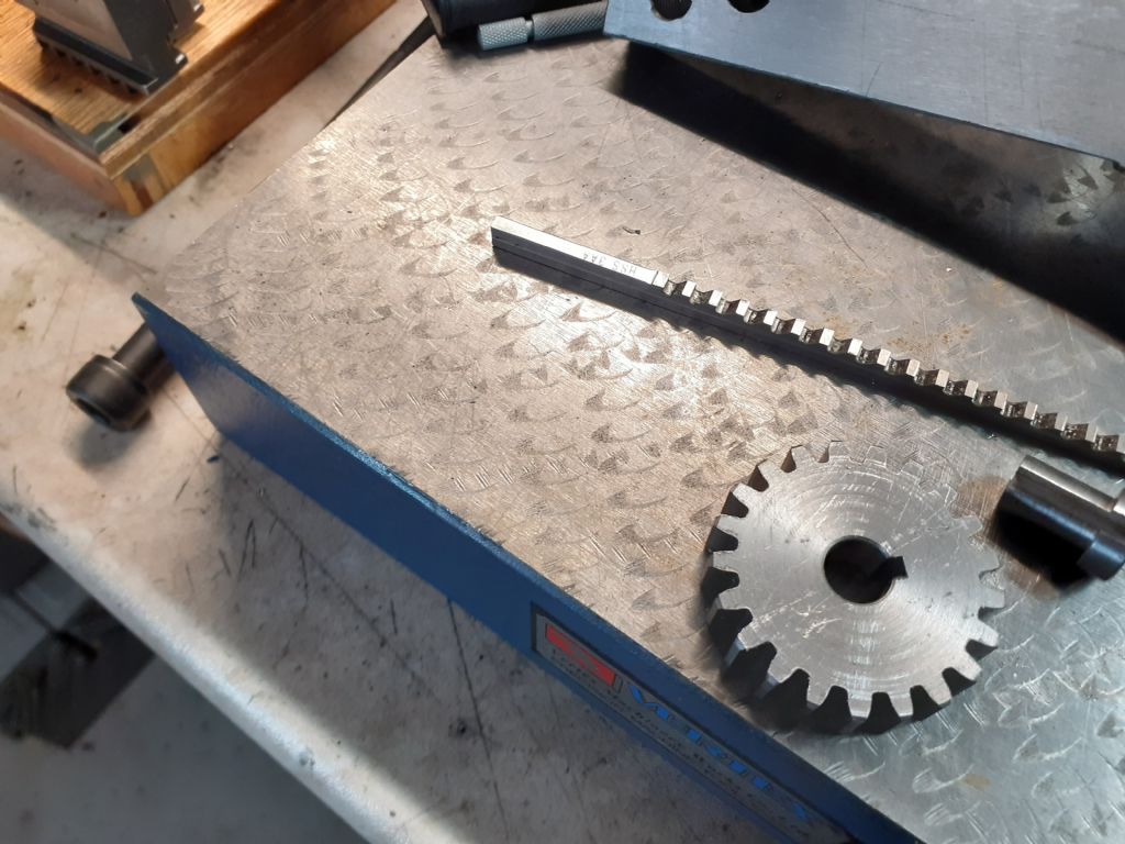

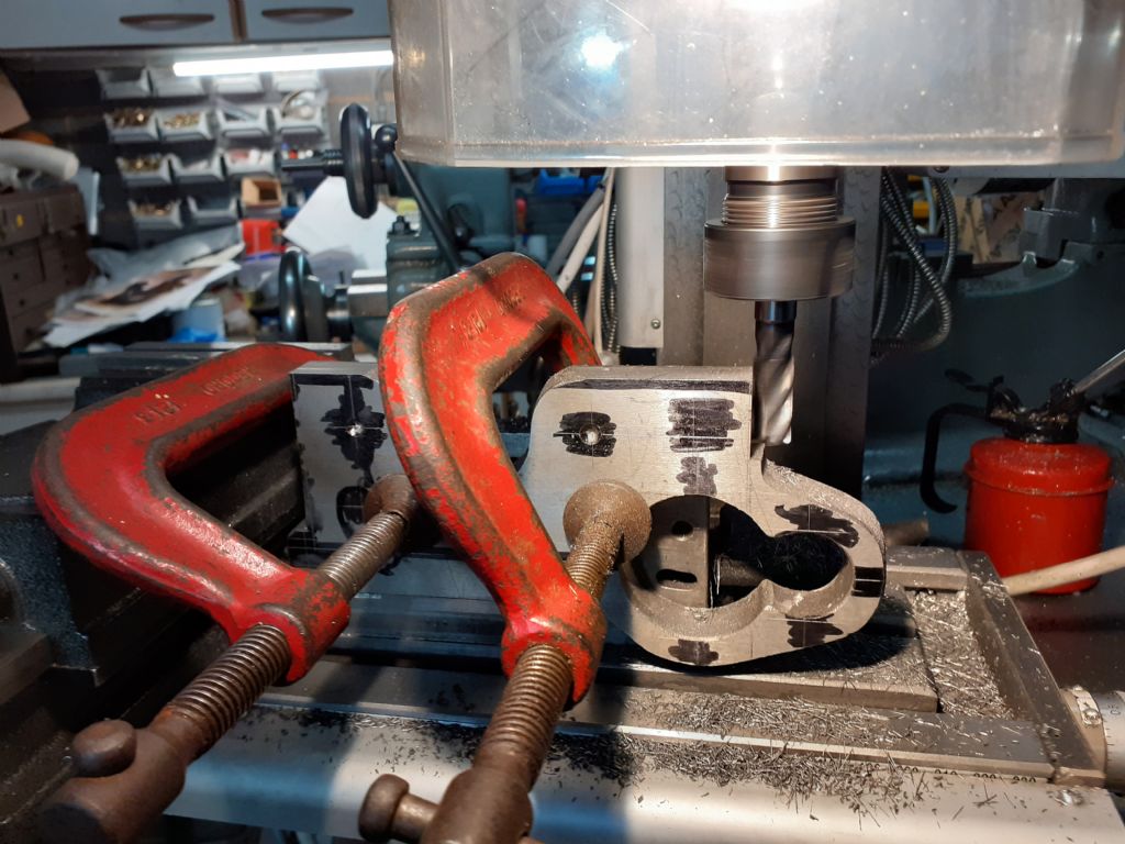

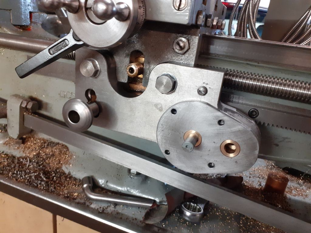

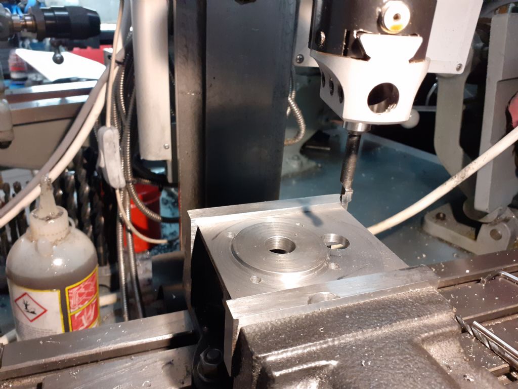

      I was offered a casting from Geoff Walker to buy, which when done, would fix the wrong direction of handwheel which catches me out ocasionaly. The casting came flat ground at extra cost but it saves machining a large area and removes any scale and less dust on my mill. I marked it out whith an angle plate and height gauge to check that it will clean up and holes in correct position. I then datumed up edges with carbide milling cutter ready to clamp flat and drill and bore holes etc.20200121_093219.jpg

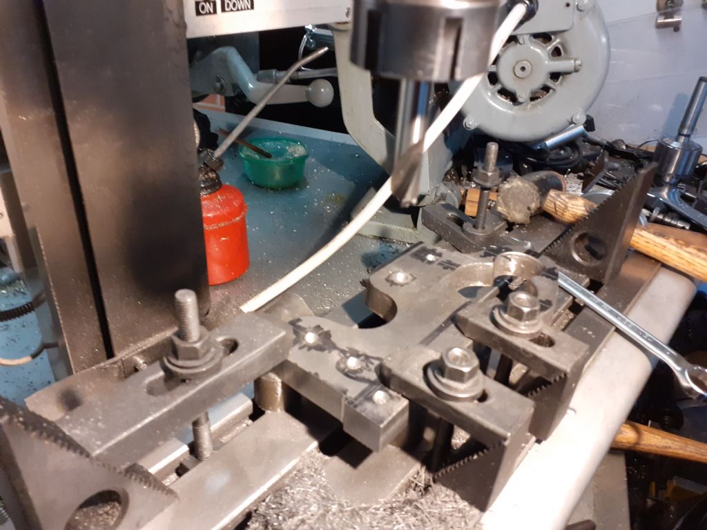

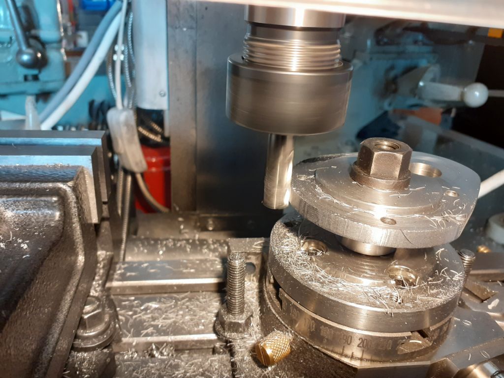

      Then I clamped it up flat on buttons so they can be moved about to drill and bore etc and blend radius corners.
      The next job was to bore the clearance holes for the gears.20200124_154022.jpg
      The slot for the leadscrew nut casting lock was done later just spun round till both holes were in line and the slot was milled straight as the radius was large and and shaft didn't touch the sides.

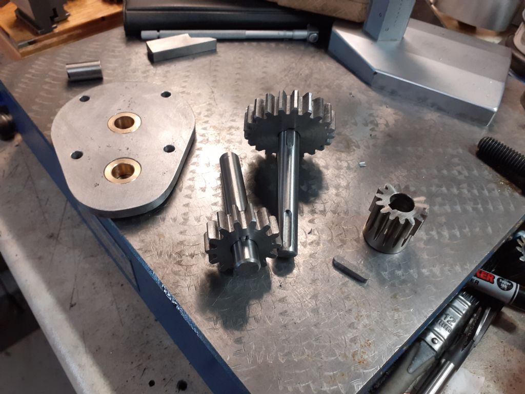

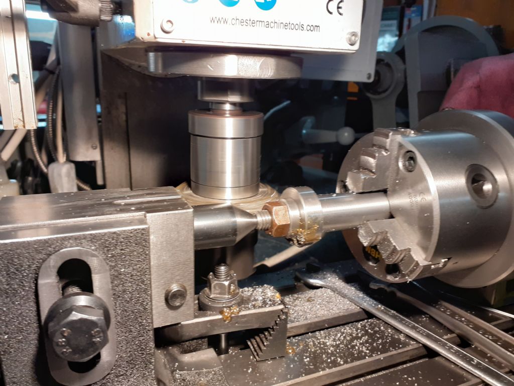

      The gears were made next and I had to make a new plate for the dividing head I had from the Midlands exhibition. My daughter bought me the arbour for the mod gear cutters and so I only had go buy two cutters one for each gear tooth count.
      The gears were also broached for a 1/8 square key as well as cutting the other side into the 3/8 silver steel shafts.
      More to follow.

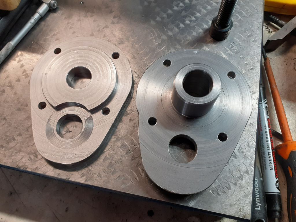

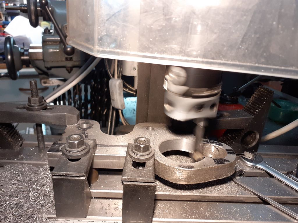

          The gears etc
          The side plates were firstly cut in the 4 jaw chuck then on a rotary table and finally angle plate of tapered shape. Also the bonze bush clearance was cut.

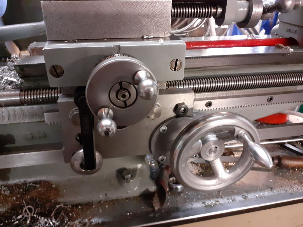

          The bronze bushes were turned a light press fit to prevent spinning. At this point I could try to see if it Fitts an no problem except the gear for the rack unknown to me was to long and was catching the rack support strip but machine 0.050" off the lengthsolved that problem.

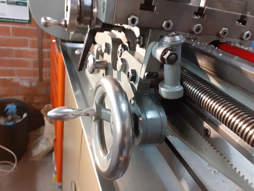

          The new handle came as the old one has a taper pin fastening and I didn't want to change it.
          Assembled it before painting no problem and fitted the screw cutting indicator with a new bracket to plate ready for painting.
          Final on lathe and finnished.
          Job done.
          I found that to remove and replace the plate I had to unscrew partialy, the shoulder screw pivot for the leadscrew bronze casting as you pull out the plate. To do this I put a screwdriver slot in the end of the shoulder screw thread so I could use a screwdriver down the tapped hole to partial unscrew and screw up on assembly, and then lock the locknut. problem solved.

            Nicely done. Quite a lot more complicated than it appeared on your posting on the Drummond Group. YOu should post a link from there to this.
            What is the blue lever hanging down? Saddle lock?

                Bazyle the handle is a saddle lock. It is simply a threaded rod pushing on a piece of phos Bronz with an angle on front face so the saddle is clamped to the main guide face. It works great when facing or parting.

                            Thanks for all your praises but if it hadn't been for Geoff Walker who picked up mistakes in my drawings in time I wouldn't have finnished it yet.
                            Geoff. Sorted the gear problem and as usual it was me. I had measured the distance to the casting and had not taken into account the upstand pad which the rack sits on so the end of the gear was catching the pad because it was too long problem solved. Also the new bracket for the thread indicator needs redesigning as the tailstock catches it.
