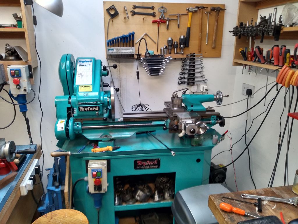

            John Haine
              @johnhaine32865
              This is my S7. It's tucked into a corner with the big mill on the left and in a gap at the end of the bench on the right (orange handled screwdriver). The front of the swarf tray is 60 cm from the back wall, the gap between the mill and the wall with the shelves is 150 cm. It's just about convenient to work on but I wouldn't want any less space.
