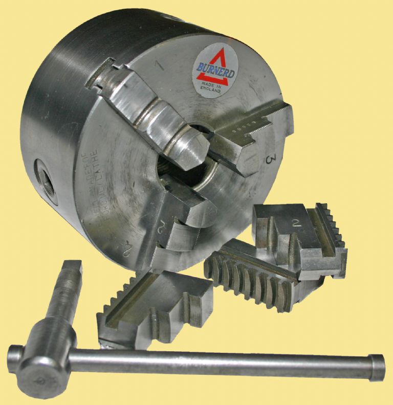

  • #486548
    fastdave
      @fastdave
      Need a best as opposed to a best as for this one – help please.
      I have even watched u tube on grinding out a bellmouthed chuck – I have one which is old and has seen some abuse, and grip is poor. To eliminate the bearings and the spindle, I plugged in the 6" 4 jaw chuck – and it turns beautifully and parallel – even looking at the jaws, they're in a poor state – so also are the outside set that came with it.
      It just feels crude to insert a round grinder and spin the chuck, also someone suggested using a boring bar.
      Both are within my scope, but I can't help but feel that some ingenious engineer is going to come up with a tried and tested method, or at least confirm the use of the above method/s.
      Any takers?

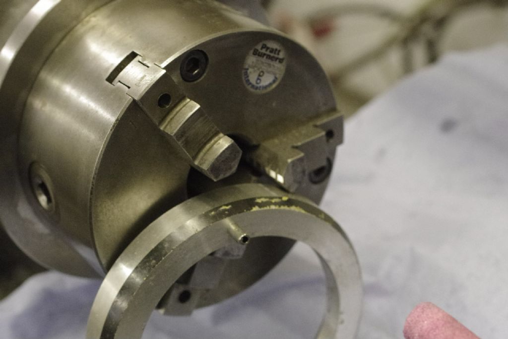

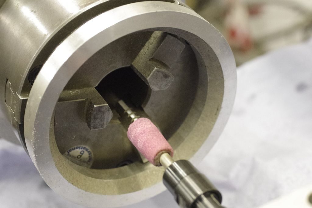

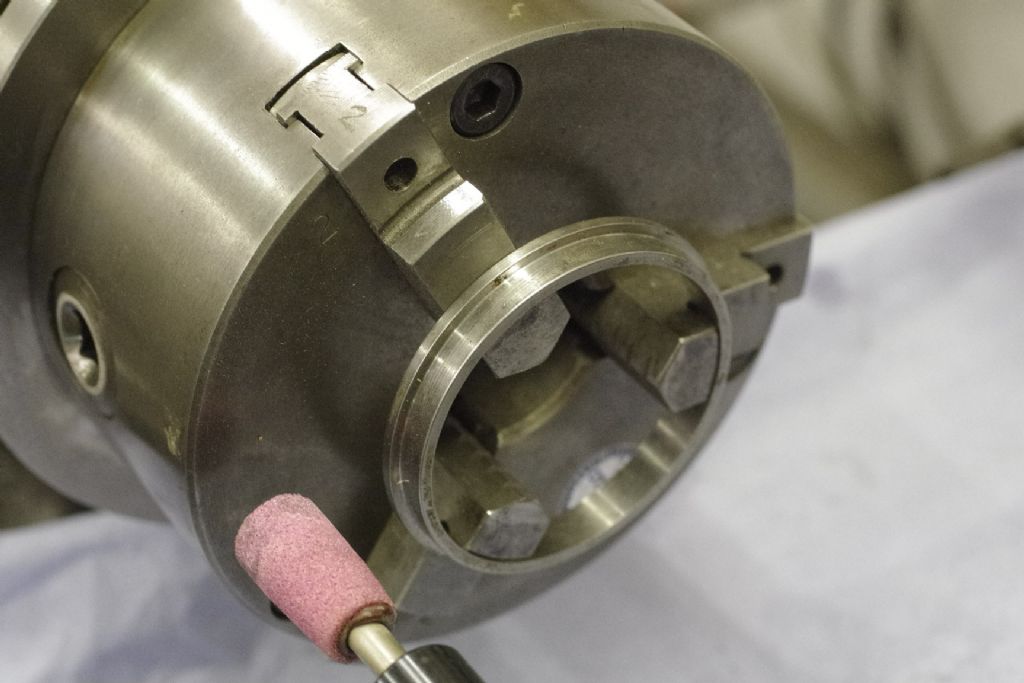

        Hopper
          @hopper
          Dremel grinder mounted to the toolpost works just fine. As long as you make some kind of spacers that push the outer ends of the jaws OUTWARDS while the grinding is being done. Several of the YouTube videos have it all wrong and are actually pushing the jaws inwards by using rings around the outside of the jaws in various places. Below is the traditional spider or clover leaf plate used for many years to true up chuck jaws. Worked a treat for me on two old chucks so far.
          picture 11. chuck regrinding. stop grinding when all three jaws are evenly ground..jpg
          Edited By Hopper on 19/07/2020 12:52:43
          Edited By Hopper on 19/07/2020 12:54:52

              #486581
              Martin Kyte
                @martinkyte99762
                All that the spider does is push the back of the jaws into close engagement with the scroll as if they were gripping a workpiece in the normal way but leaving the faces of the jaws clear for grinding.
                Yes the dremel is spinning. The grinding head is introduced to the centre of the chuck and a cut slowly put on. The length of the jaws can be ground then. Increase the cut and repeat untill happy.
                regards Martin

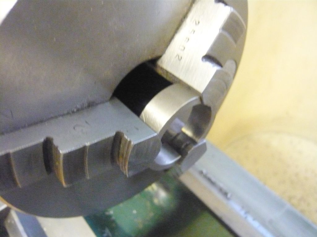

                  Alan Jackson
                    @alanjackson47790
                    I made three equal length spacers cut from a steel ring and insert them as shown . Works very well
                    Alan

                            #486622
                            old mart
                              @oldmart
                              _igp2649.jpg_igp2645.jpg_igp2647.jpg_igp2648.jpgI started grinding the jaws for two 5" Pratt Bernerds yesterday at the museum. Doing them properly is a long tedious task. First, they have to be dismantled and cleaned, or any precision grinding a chuck full of muck is a waste of time. Then a method of tensioning the jaws is required. I chose to drill the jaws with a solid carbide drill. Tensioning rings of just the right size for each diameter of chuck are needed. The optimum diameter to set the jaws at for grinding is just inboard of the hole in the chuck body, that is also best if you also decide to do the outside steps at the same time. With holes drilled in the part of each jaw as the photo the ring is attached and the jaws tensioned inwards to grind the inside surfaces. If the outside steps are also to be ground, the jaws must be tensioned outwards. As our chucks have loose registers, the first step is to get the chuck body running true and fully tightened using the six mounting screws for the backplate. The lathe was running in reverse backgear at about 60rpm, and I set the carriage feed to move to the right (check direction in a safe position) and took 0.0005" deep passes, about three passes between adjustments. The first jaws were true in about 0.002" of cut depth. The outside steps trued up in only about 0.001" and purely by luck with the jaw settings, the whole surfaces cleaned up straight away. You could try checking the radii with a dti to get the easiest clean up.
                              I only got the inside jaws finished on on of the chucks finished, so I have a way to go yet. The extended nose die grinder was very good and an improvement on the straight drill that I used to use before.

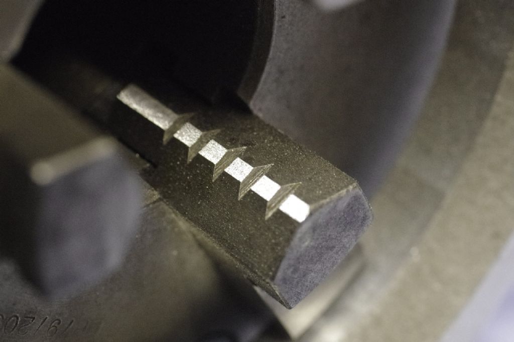

                              #486638
                              Sam Stones
                                @samstones42903

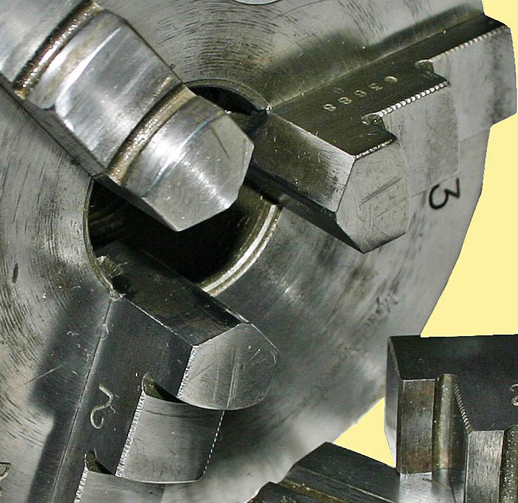

                                I have a question … ‘Are your chuck jaws through or case hardened?’
                                Applying lapping compound to a ½" diameter brass rod, I honed the gripping faces of the (outside) jaws of my ML7 Bernard three jaw.
                                At a slow spindle speed and the bar gripped in the ½" tailstock chuck, I slid the tailstock and the brass rod back and forth while occasionally adding gentle pressure to the jaws. I continued this process until there was a clean line from the front to the back of each jaw.
                                Later, (after much use) I noticed the appearance of a pattern on both the gripping surface of the jaws and marks in material e.g. aluminium. The imprinted pattern showed how the core material of the jaws had been impressed, while the ‘skin’ had remained less so.
                                While I have no direct photographic evidence, I found that the jaws were not through hardening but case hardened.
                                I have mentioned this elsewhere but as I recall no one responded, presumably because no one else had observed the same effect or that it is not important.
                                At a guess, the chuck was new and came with the ML7 between the 40’s and 50’s.
                                Any comments?
                                Sam

                                    Pondering further on whether the ML7 Burnerd 3-jaw chuck jaws were case hardened or through hardened, I’m now wondering if the results of my (brass bar) honing exercise produced this (geometric) shape to the gripping area of the jaws, and that what I thought was an imprint of the hard skin (marked in orange) and softer core was incorrect.
                                    Although it’s still an open question, I have no way of finding out because I sold everything in’007.
                                    Sam

                                              #486816
                                              Sam Stones
                                                @samstones42903
                                                Fastdave,
                                                Apologies for hogging your thread.

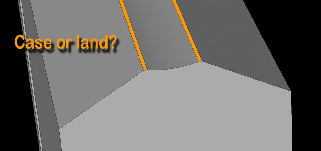

                                                Rather than leave it hanging however, I have to accept that my cheap method (brass bar honing) has its limitations. As you suggest Hopper, there could (would) have been errors associated with the fit of the jaws. The one certainty was that whenever I gripped a ½" diameter piece of material especially ground stock silver steel it was pleasing to see it running true, whatever that means. It was irrespective of whichever of the three chuck key holes I used.
                                                I’m more convinced than before, that what I believed to be indications of case-hardening were nothing more than variations in the degree of ‘penetration’ between the (orange) ‘corners’ and the ¼" radius ‘channel’.
                                                Old Mart, your comment about broken teeth adds to my probable error in that there was damage of that kind to one of the jaws, which may (or may not) have been damage I did or was the result of the previous owner. I certainly don’t recall anything going ‘with a bang’.
                                                After a bit of Photoshop jiggery-pokery in the hope that I could see more of the honing, I was puzzled to see ‘deckled’ edges on both sets of jaws. I can only assume they were from single file strokes during de-burring at the time of manufacture.
                                                Sam
