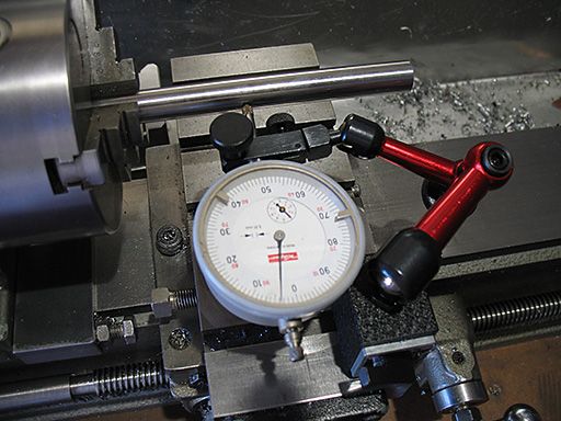

                          I pulled out the gib and measured it for wear. As expected, there is some difference in thickness along its length. The front end measures 0.1270" (both top and bottom), while the both the middle and back end measure 0.1255" on the top and 0.1260" on the bottom. So a maximum difference of 0.0015" which I suppose isn't too terrible considering the age of this machine.
                          Unfortunately, there is definite crabbing going on. A dial indicator held out against a ground and polished rod in the three-jaw chuck at about the distance of the end of a boring from the center of the carriage shows a total movement of almost 0.020" between forward vs backward motion (it was even worse before I removed, cleaned, measured and reinstalled the gib). That seems to be way, way more than the wear on the gib could account for and indicates wear at the back of the carriage dovetail.
                          In the short term, yeah, make boring cuts in one direction only, dial the tool away from the cut when withdrawing. Fussy, but should offer better results than what I'm currently getting.
                          Longer term fix would be to try to scrape the carriage and/or bed a little to try to get more accuracy into this thing. Of course, I have zero experience with scraping and the rest of the machine is also pretty worn (spindle, bed, etc.) so I do not know if it is worth my time… except as a learning experience. Honestly, I'm beginning to think I might have to rub some cash on this problem – meaning a new lathe – but if I go that route I could always hold onto this and try the scraping when I have nothing to lose.

                            You have to remember that you are exaggerating the error by having the clock extended.
                            There is a back up plan, and the lathe can always be salvaged. Odd items for ML 10's always appear for sale.

                              Graham, it is true that the extended position of the clock does exaggerate the error, but as I said, the clock is in approximately the same outboard position as my boring bar. Thus, I expect that the clock is simply showing what is happening at my cutting tip in that position. A cutting tool held closer in to pivotal center of the carriage wouldn't show quite this severe difference.
                              Be that as it may, I'm going to have to continue to use the lathe as is at the moment (better to have something than nothing).
                              Nevertheless, when my courage is a bit more 'up' I'll start some inspections of the back dovetail on the carriage as you have suggested.

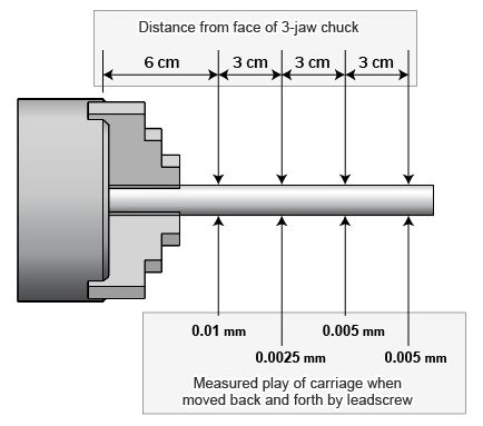

                                Had a good breakfast and then wandered out to the garage to run some measurements as Graham suggested.
                                I once again measured the crabbing motion, this time with the dial indicator more central to the carriage.
                                The measurements I obtained can be seen in the illustration above.
                                The free play listed was a little bit dependent on the speed with which I attempted to advance or retract the carriage.
                                The carriage could be made to move (almost) the length of the bed but the gib was really pretty tight for this – maybe a wee bit more than I would like. The motion of the carriage became tighter and more difficult as it approached the tailstock. In the other direction, toward the chuck, moving the carriage was very difficult approaching almost impossible when moving beyond its position as shown in the photo.
                                As a slight bit of good news there is not enough space on either the left or right side to insert a 0.04mm feeler between the rear dovetail of the carriage and the matching dovetail of the bed.

                                    I think you are chasing completely the wrong issue. If having to move the cross slide back at the end of each pass is your biggest problem in life you are truely a lucky man. The only thing that should matter in this area is whether your alignment of the headstock and lack of bed twist allows you to cut a parallel bore.
                                    The place where this movement matters is when the carriage is locked and you are facing off a big flat plate. You just need to determine a method for getting the carriage in the right poition for this operation to be true before locking.

                                        Glad my advice worked out, with errors like that I would leave well enough alone and modify my method of working.
                                        A Clock (DTI) is truly a wonderful thing, as are feeler gauges which are very often over looked. A clock in skilful hands can save a lot of worry when it comes to machine tools and wear.
                                        One thing I would do is make some felt wipers with metal protectors for that bed. These will slow down any future wear and keep the bedway lubricated for longer.
