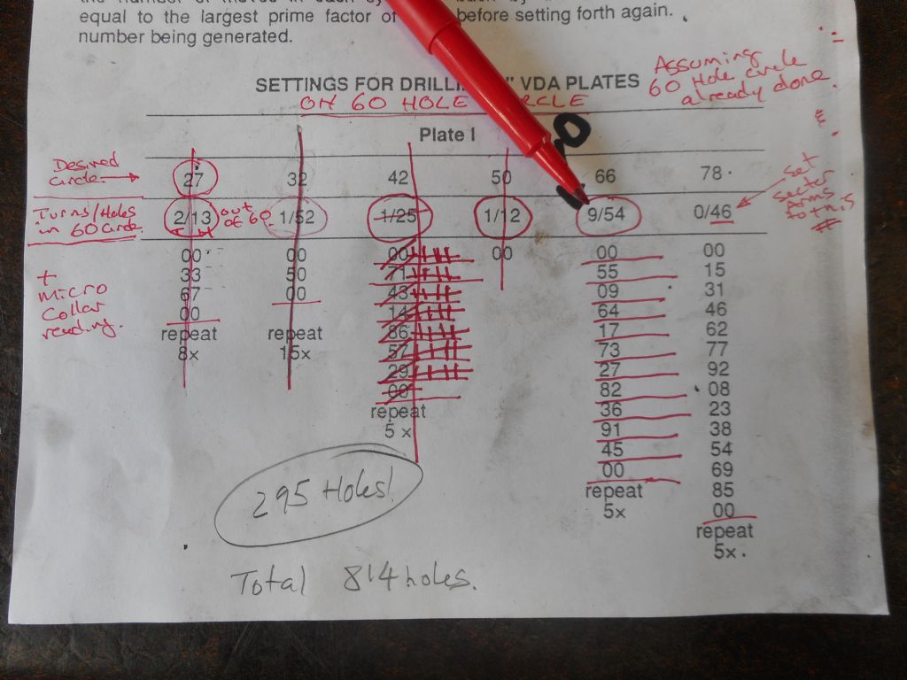

        I mentioned this in another thread but thought it might be useful to record this error in Geo H Thomas's book "Workshop Techniques", page 202, 1998 edition.
        In the chart giving the settings for drilling 4" VDH plates, the number of turns of the indexing handle is wrong on the 66 hole column. The chart as printed reads 9 turns plus 54 holes, shown as 9/54.
        It should read 0/54.
        I've checked the math on this and proved it by successfully drilling the 66 hole circle.
        Unusual to catch old GHT in an error, but I suspect it is a printer's typesetting error that went undetected by Saint George's posthumous editor.
        The error in question is pointed to by the pen. change 9/54 to 0/54 and carry on with the job as per normal, working your way through the micro adjustment graduations as they are shown.
        It seems like such a glaring error – 9 compared with the 0 on the next circle etc – but I almost fell for it, thinking it must take multiple passes around the job to get the desired holes but luckily stopped to check the math and it don't work the way it's printed!
        Happy drilling.

              Don't have my scratch pad in front of me but the math goes like this:
              For 66 holes, the angle between two holes = 3600/66 = 54.54
              54.54 is the angle in tenths of a degree, due to the 3600 in the formula, rather than 360.
              So, we use the sector arms to mark out the 54 tenths of a degree. In a 60 hole circle used for indexing in this case, each hole = one tenth of a degree. (One revolution of the handle = 360/60 = 6 degrees. 6 degrees divided by 60 holes = .1 degree.)
              Then we use the micro adjustment dial to move the 00.54 tenths of a dergee each time.
              So the movement becomes 0 turns of the handle, plus 54 holes in the 60 circle, plus 54 graduations on the micro adjuster. Result, as tested = 66 hole circle perfectly formed.
              Alternatively, if you follow the 9/54 misprint, each movement equals an angle of 9 x 6 degrees = 54 degrees, plus the 54/1000ths put on by the micro adjuster. Or 54.054 degrees. If you drill 7 holes to this specification, the seventh hole will fall at the 378.378 degree mark. which is 13.378 degrees past the first hole you drilled. Nowhere near the needed 5.45 degrees between two holes in a 66 circle. It's just totally wrong. Whereas the 0/54 formula is spot on.
              I think I got my math right – but I majored in English Lit so don't take it for granted. smiley

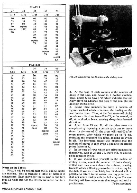

                  #314348
                  Robbo
                    @robbo
                    "Most, if not all, of the content appeared in ME first and it will be worth looking to see whether this area was correctly printed in the magazine" – ega
                    Here it is: neither 0 nor 9 but a dash.
                    Edited By Robbo on 28/08/2017 21:54:48
                    #314367
                    Hopper
                      @hopper
                      Robbo, that chart you posted is correct. Thanks for posting that for future readers to refer to.
