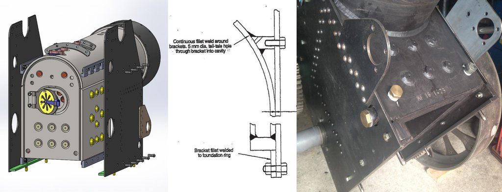

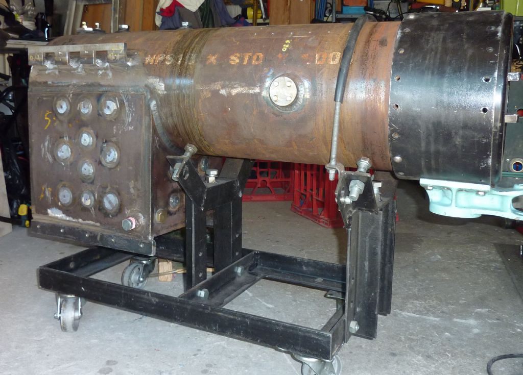

              @paullousick59116
              Bolting the hornplates to the boiler stays is common practice on model engines but it is not allowed in Australia for larger, steel boilers. Instead a separate mounting has to be added to the side of the boiler. Another requirement is that a 5mm tell tale hole has to be drilled axially in the end of the stays. These will leak if the stays within the water space of the boiler are coroded.
              My 6" scale engine weighs 600kg and it is not good practice to place a shear load on the mounting bolts. Therfore the boiler on my engine rests on a ledge, welded to the bottom of the hornplates and the mounting bolts only take an axial load. I also do not like using threaded holes and all bolts have nuts which are easier to replace if a thread is damaged.
              Paul.
                Edited By Paul Lousick on 26/08/2019 23:46:40
                Please excuse my ignorance on things traction engine, but is this method I have seen used in model engines of bolts through hollow stays not used in the full size?, and by extension is an accurate model not permitted if it is to meet the Australian code?
                While plate thicknesses and joining methods might well need to be adjusted to make a safe working model, if I have understood this correctly, does the visible structure have to be changed too?
                Interested to know.

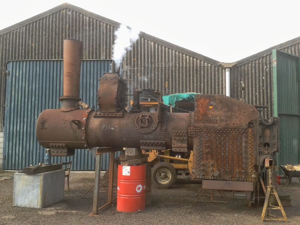

                                Posted by Nick Clarke 3 on 27/08/2019 08:11:04:
                                Posted by Paul Lousick on 26/08/2019 23:45:29:
                                Full size engines don't have hornplates they are a model thing. On a full size the sides of teh firebox continue up to provide the plates that the shaft bearings fix to.
                                I don't see why a model could not be made with full height sides to the firebox.
                                Not all models use the bolt through method, a couple of John Hainings designs particularly the ploughing engines used an angle welded to the curve of teh boiler much like Paul's sketch shows and the firbox sides were extended out the back to provide fixings for the hornplates.
                                Edited By JasonB on 27/08/2019 12:48:49
