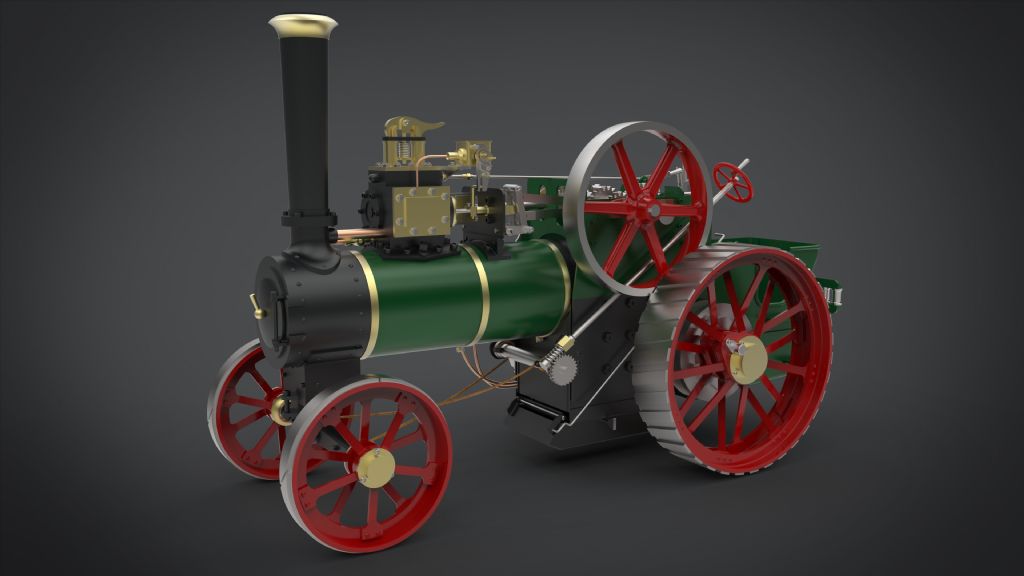

                      For anyone interested, there are 3D models of a 1" Minnie on Grabcad.com, available for download in Solidworks, step and igs formats.
                      #515641
                      Roger Best
                        @rogerbest89007
                        That's very helpful Paul. I always like some 3D to help me understand a part.
                        ta, Rog
